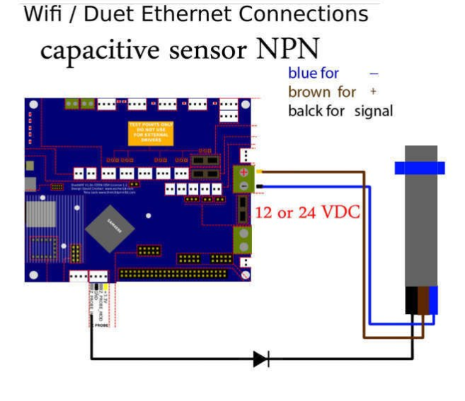

I am trying to get a inductive z probe set up however it reads 1000 on the web interface and when trying to home is says "Error no z probe" I followed the wiki guide "https://duet3d.dozuki.com/Wiki/Connecting_a_Z_probe" and directly wired it to the z probe input. I triple checked the wired and they are all connected and working with a multimeter. Ive tried going through dozens of posts online and each one says something completely different to another and cant find any tutorial on what exactly I need to have in my config.g for this to work.

I wired it directly as the wiki stated without the diode to the z probe connection. please see the attached photo for clarification

No diode though as the wikipedia states it doesnt need one for my board version
"Duet 3, Duet 2 Maestro, or revision 1.04 or later of Duet 2 WiFi or Duet 2 Ethernet: you can connect the output of the sensor directly to the Z-probe IN pin." -
