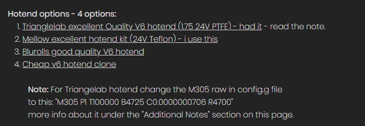

@kentsor well looking at the BLV documentation you have probably got 1 of 4 hotends:
assuming those were the ones they used when your printer was made.
The config they have for Duet 2 is:
M305 P1 T100000 B3950 C0 R4700
Looking at the example config they distributed for 6HC and RRF3 they have:
M308 S1 P"temp1" Y"thermistor" A"Hotend" T107537 B4725 C7.06e-8
so those two options (change from M305 to M308 for the Duet 2 option) would be worth testing
