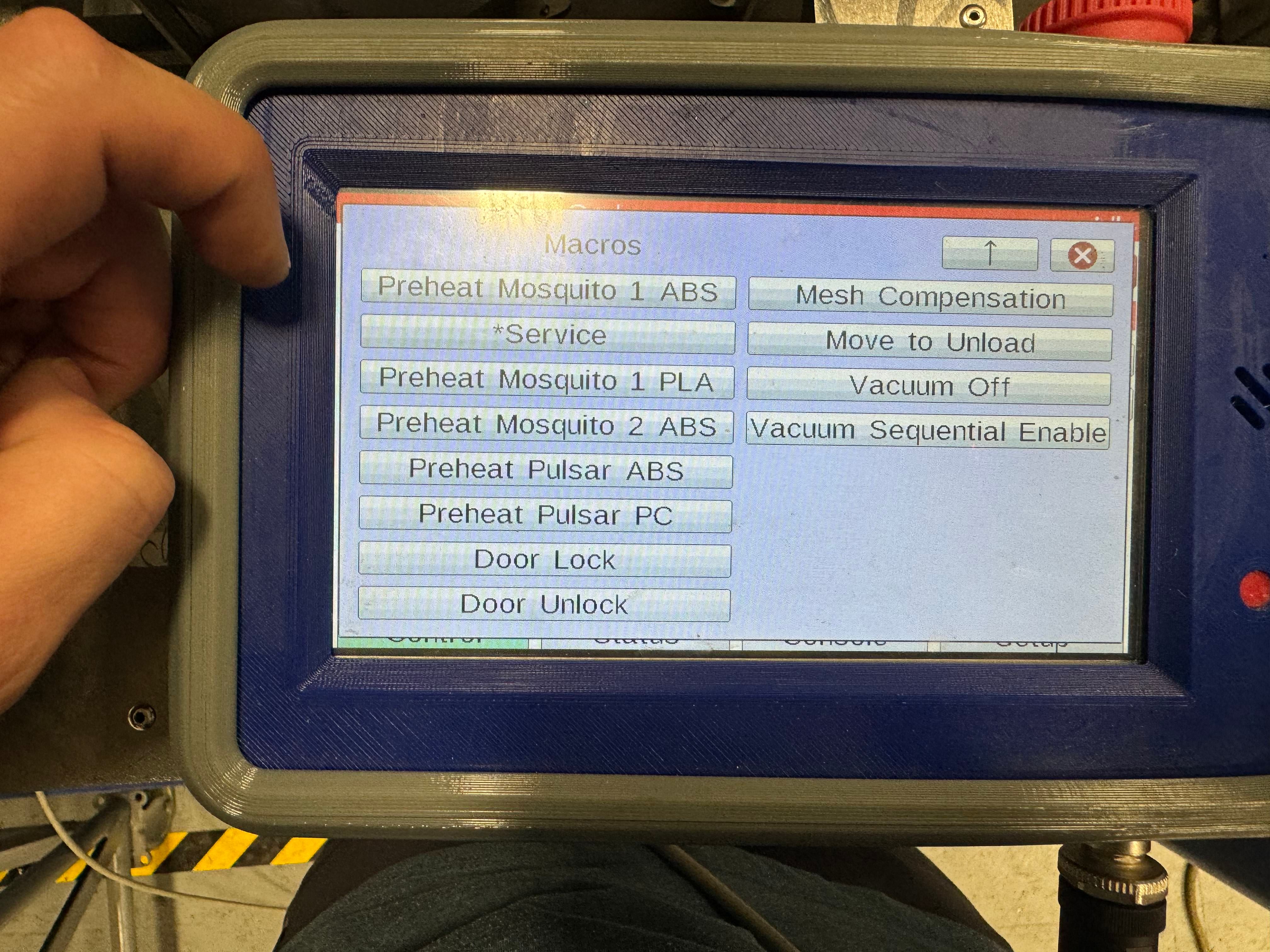

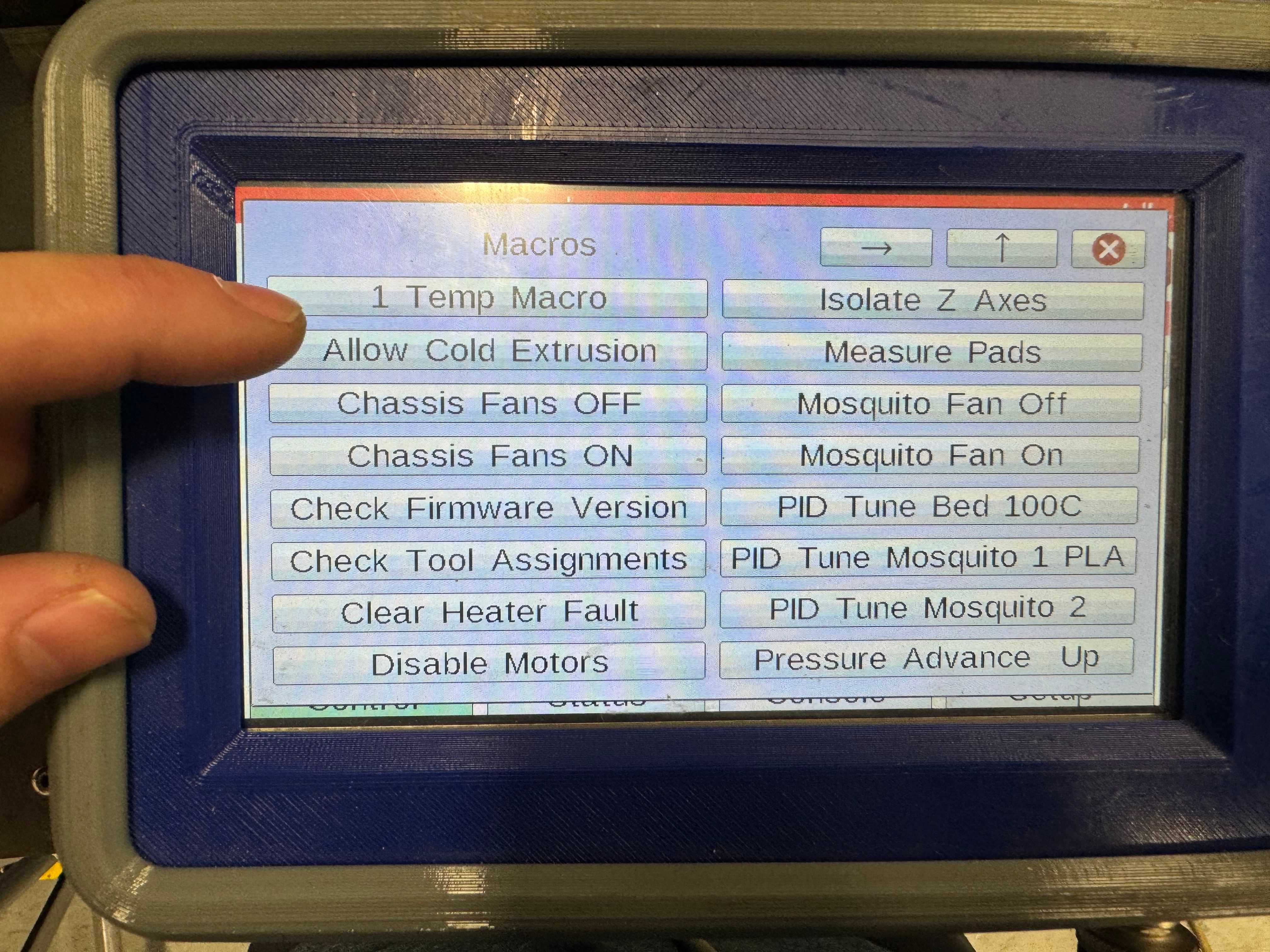

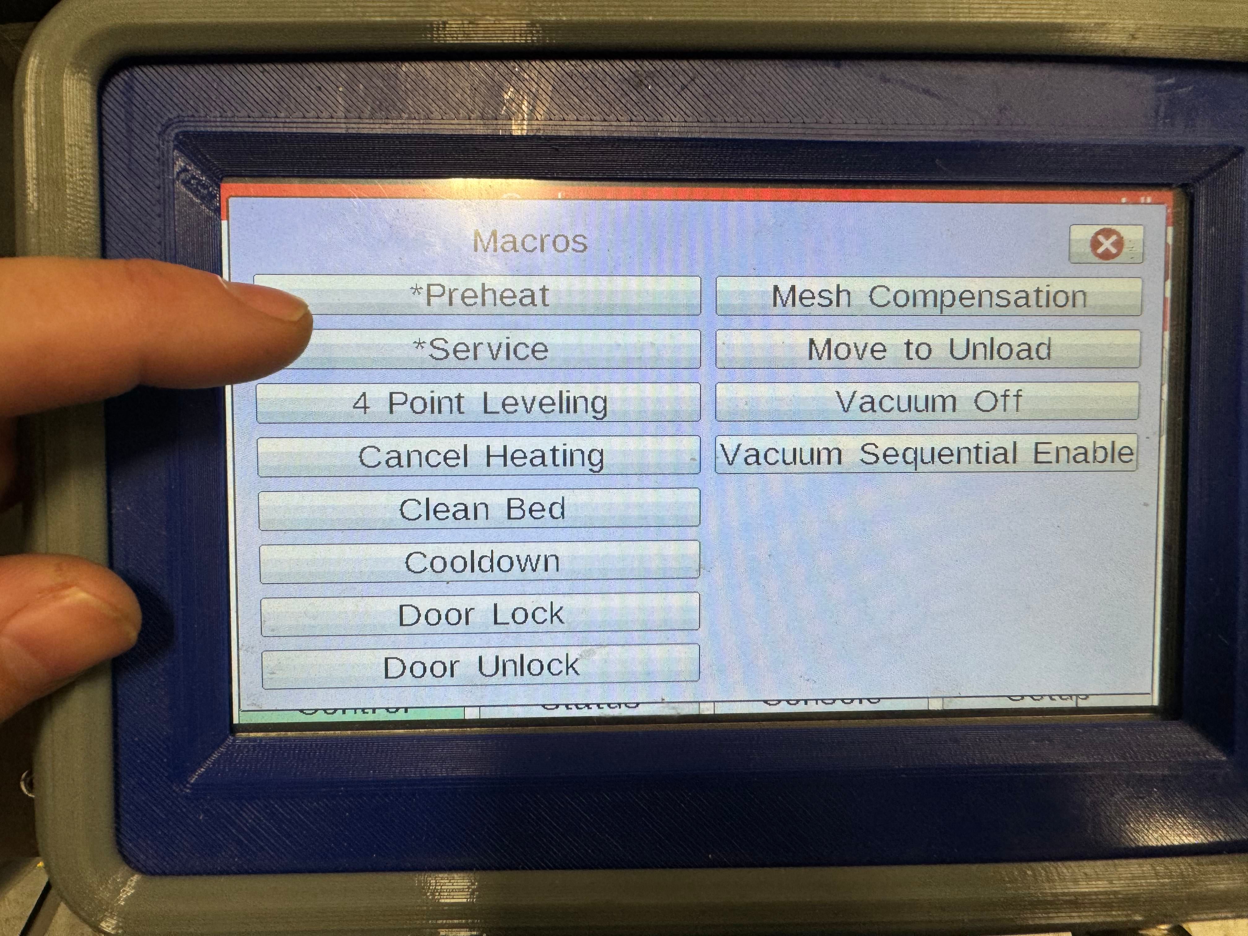

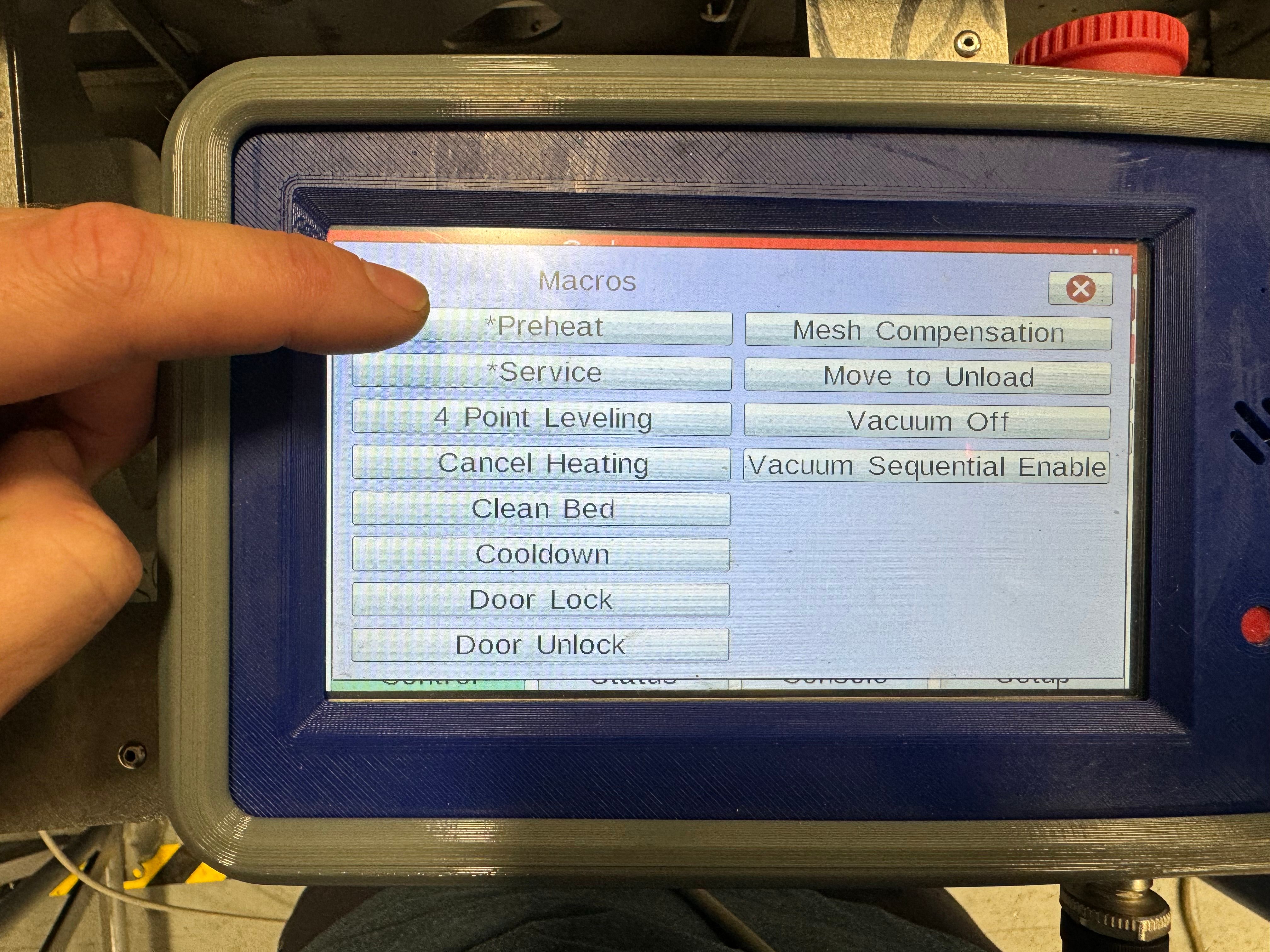

      I reorganized my macros into a couple folders have encountered some issues.
      • In the web interface, I can no longer select all and download as zip. I really liked this feature because it was a quick way to make a local backup before I started messing around with code. I wish it worked with folders.
      • On the Panel Due when I first boot up the machine I can see my folders represented with asterisks, which is great, but when I exit a folder, the macros persist on the initial screen. Closing and reopening the macro menu does not fix it, and navigating in and out of macros can cause illegible text artifacts to appear on the buttons.
      I should note that I'm using a panel due 7i, with a duet 3 in SBC mode with a raspberry pi, running the 3.5 release candidate.
