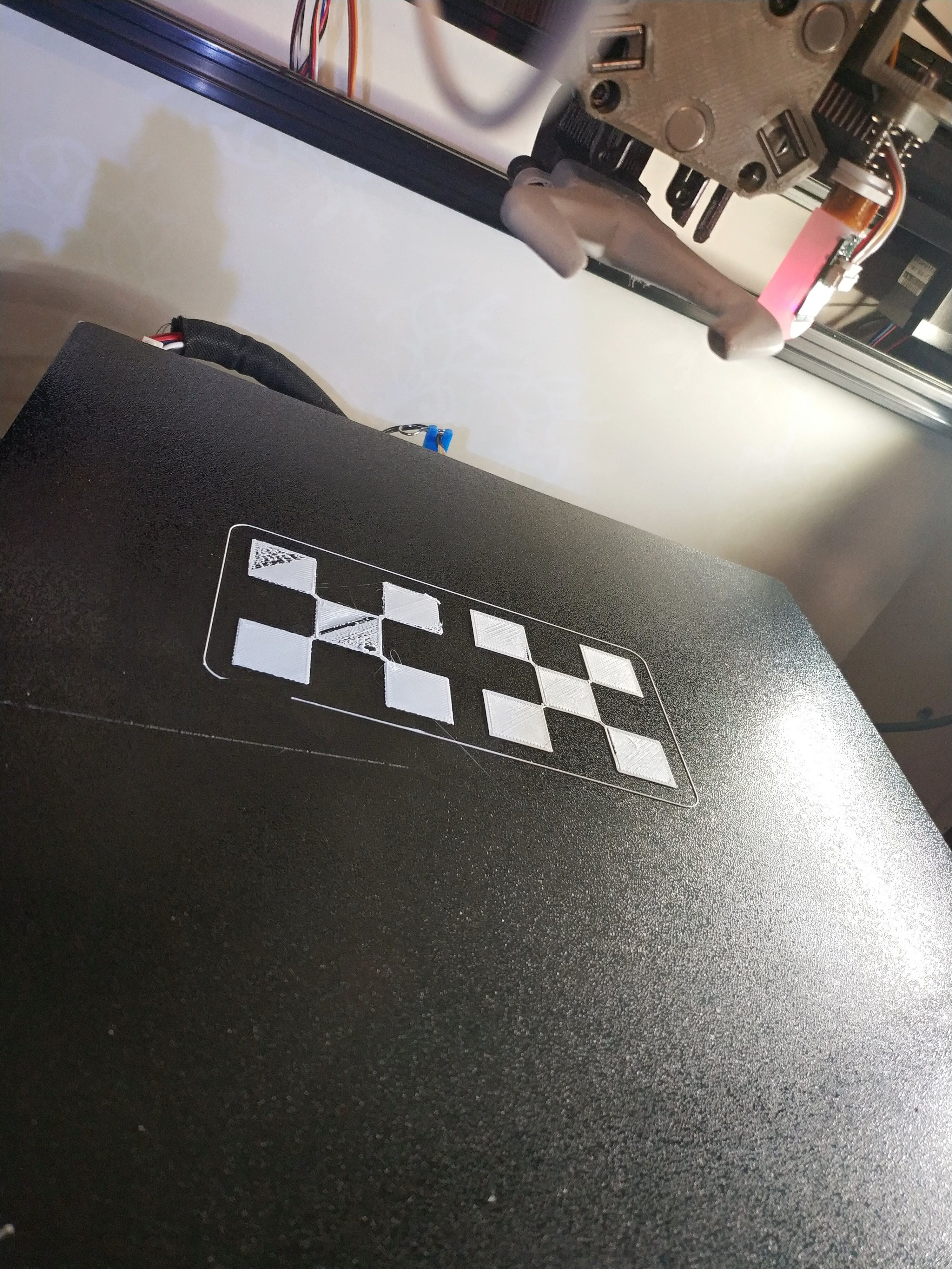

                      psychotik2k3 @dc42
                      @dc42 at least the workaround is easy and can be implemented in the config.
                      but thanks for your efforts.
                      finally succeeded to print with 2 heads: (don't bother the crappy one i had broken filament and had to insert and push manually)
