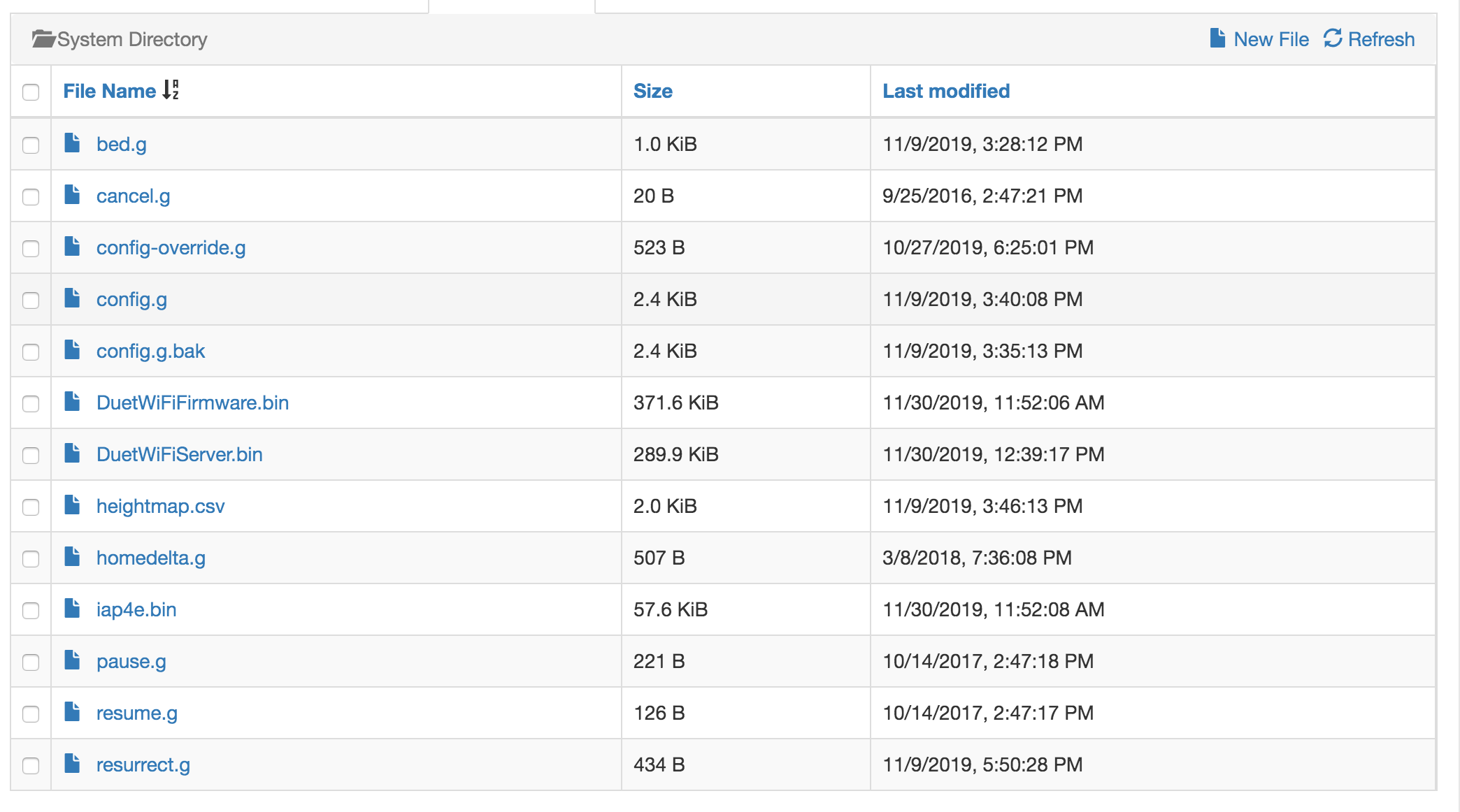

4 -Uploaded Files
- Screenshot of uploaded files to UI

@dave-poltorak I actually wonder if the IAP file is for later FW I can't remember when that was changed but you could copy the FW File (Correctly named) to the sys folder and then issue a M997 S1 I think it is. Yes just checked it is S1
The file needs to be named DuetWiFiServer.bin
HTH this goes back so far i may be slightly off but I don't think so
I've tried a few variations based on your suggestions, I've tried it this way before and is listed above but wanted to follow up on any advice given.
Manually Moving update files to SD and issuing M997 S1 from Web UI requires power cycle to access again
Manually moving update files to SD and issuing M997 S1 from PanelDue results in the same error. Have tried this 4 times without any luck.I have now also downloaded the necessary files for 2.05RC1 and can confirm that my board is now running the main firmware at this version with the latest version of DuetWebControl.
I attempted all the various upgrade mechanisms again but alas, still the same error.
Success!
I modified my config.g to not start the WiFi at startup and the M997 S1 was successful in uploading the firmware. This wasn't listed in any of the documentation sites but am very happy that all firmware is now upgraded. Might be worth adding to documentation somewhere?
