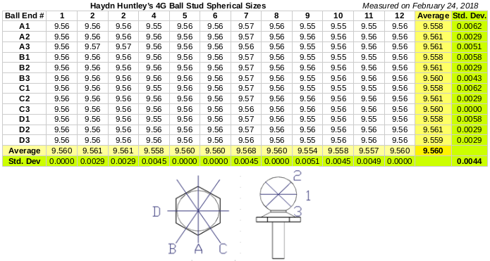

I got Haydn's magnetic rods some time before. I haven't built my delta printer yet, waiting for the PCB effector. But time is comming so I decided make some preparatory work. I measured ball stud diameter hoping sort out the pairs with best matches. Results are in the picture below,
My setup is as follows. 4 section plane through rotational symmetry axe A-D give 4 circles which diameter are measured in 3 positions 1-3. That gives 12 measurements. It can be seen from the table that the diameters in horizontal plane are less then ones in oblique planes by 0.06-0.08 mm so sphere is not perfect somehow.
The most relevant for us are the zone of 2-3 measurements as that is working area for diagonal rod movements of delta printer. Fortunately the sizes in these zone are very cosistent for all the ball and have deviation of 0.01-0.02 mm and for nine of twelve balls is pretty near to nominal value for 3/8" balls. But three balls have diameter that are less by almost 0.1mm. The rods that I got have specified length on them that differ no more then 0.02 mm from each other. I suggest these were measured with etalon balls or just approximated from the length of rod alone assuming ideal ball size.If I would use existing ball studs I get the difference in diagonal rods on order of 0.1mm. Moreover I get one pair of rods with difference in length within it of the same value ( I have 3 balls with smaller diameter). Having no experience in 3D printer I am not sure how it may be relevant to precision of Delta. I am going to include another set of twelve ball stud into my order of PCB effector and electronics and hope that I can choose twelve identical balls (similar as David recomended choosing TRAX rods among double set).

DjDemonD, thank you for your reply. But my question was how crucial would be 0.1mm difference in the length of diagonal rod pairs for Delta precision. BTW I have 360mm Haydn's rods.
ah OK now that is a slightly different Question a 0.1mm difference is to much IMHO and would result in some Effector tilting as it moves around and this is what causes the biggest Issues when calibrating unless you are using the Nozzle as the probe.

I would like to point out that ball studs are not ideal. They can have the difference in their diameters as much as 0.1mm that was in my case. Specified length of my rods are matched to within 0.02mm. But I suppose that length is calculated value for the nominal diameter of the balls. Combining the rods with the ball I get discrepancy in the length of final assemblies.
Yeah Doug is spot on to say 0.1mm is definitely not good. You can get away with that if its a difference between one arm pair and another. But it will show up as an obvious inaccuracy if its within one arm pair.
If you know the ball diameters (and they are actually spherical) and you know the rod lengths, I'd be very keen to see the effect of matching them precisely to get exactly the same arm lengths all around to 0.01mm precision.
Real world difference in your prints - zero! But it will be satisfying in the quest for perfection.

I really have 3 balls that deviate as much as 0.1mm from the rest of set so I will get one pair imperfect anyway. Hope another twelve ball studs will solve the problem.
