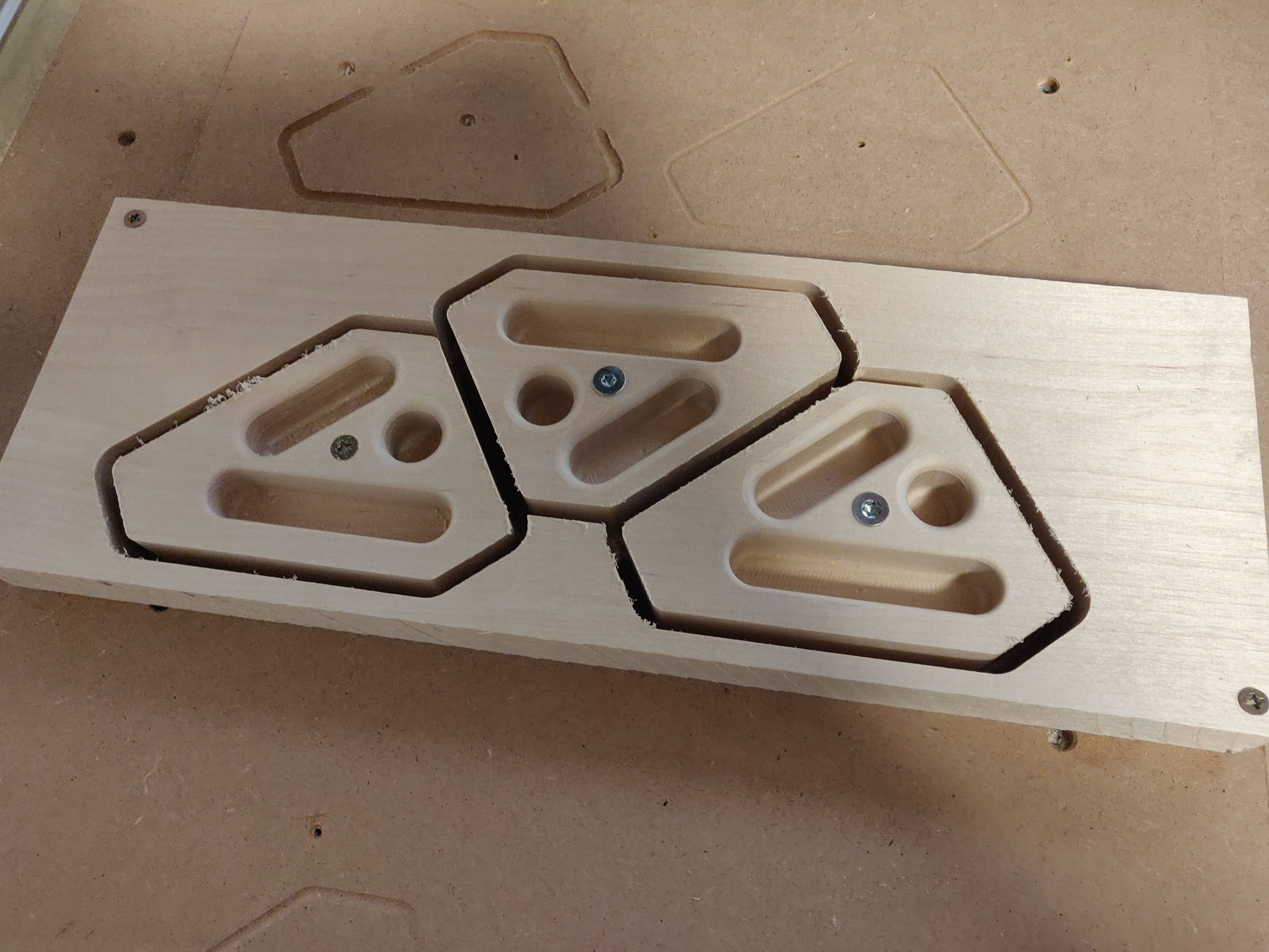

I have my Duet3 set up as a CNC router. I'm looking to produce a large number of identical parts out of wood, so I would really like to be able to repeat a job in patterns, in this case 5x5 for a total of 25 parts per batch. With the added twist that some of them are rotated to get better material use (got a separate g-code file for this).
I'd like to think this is easily done, to call the same two G-code files repeatedly from another G-code file while changing the origin point. But I can't seem to manage this. Here's what I've tried, to only make three parts of which one is upside down:
G54 (the G54 origin is set manually, and represents the first part to be milled) G0 Z36 G0 X0 Y0 G10 L20 P2 X-214 Y-120 Z36 (set G55 coordinates, used for the second part) G10 L20 P3 X-177 Y0 Z36 (set G56 coordinates, used for the third part) G54 M32 "Kanel_uppv_trimmad.g" G55 M32 "kanel_upponer_trimmad.g" G56 M32 "Kanel_uppv_trimmad.g"
Firstly: This doesn't work. If I run this from the Job folder in DWC, it will make only the first part and then stop. Surprisingly if I run it from the macro folder instead, it will only make the last part.
Secondly: This doesn't scale well since there are only 9 numbered origins (G54-G59.3), and I want to make 25 parts. I could still use this method if I redefine the origins as I go along, but I'd like to think there is another way. I tried G92 but the command seems fully broken on my firmware, a simple "G92 X0 Y0 Z0" does not make the current coordinates 0 in any coordinate system (neither machine coordinates nor any of the G5x).
I'm due for a firmware update either way so if anyone suggests a G92 way of doing this I suppose I could update the firmware and hope that it fixes the command, but I'd prefer to just get on with this job right now and update some other time. I know that several of the commands in my config.g have been redefined so it will take me a while to get the machine working again after the update.
Any suggestions on how to do this? Image below shows intended result.

@wwak84 Thanks for the pointers, I'll look into the meta commands. It would still be nice if I could call a g-code program and have it return and continue executing. I did consider pasting the job 25 times into the same file, but that would make for one nasty file. With your suggestion at least I would only need to paste the full job code once.
