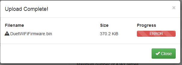

  • what is the correct procedure to update the firmware from 1.21RC2 ?
    Can I just follow this steps : https://duet3d.dozuki.com/Wiki/Installing_and_Updating_Firmware ?
  • administrators
    It's slightly more complicated than normal, because the name of the main firmware binary for the Duet WiFi and Duet Ethernet has changed.
    To update a Duet WiFi or Duet Ethernet from RC2 to RC5, rename Duet2CombinedFirmware.bin to either DuetWiFiFirmware.bin or DuetEthernetFirmware.bin according to what your existing firmware and DWC expect. Then upload that file through the Settings->General tab of DWC. It will ask whether you want to install the firmware. Say Yes.
    When it has finished, check that the new version number is shown on the Settings->General page of DWC. Then, if your board is a Duet WiFi, upload the new DuetWiFiServer.bin file and allow it to install that.
    Finally, upload the new DuetWebControl.zip file.
