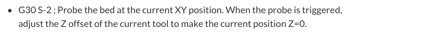

      Love the G30 S-3 feature. Got it working although the code wiki doesn't seem to have been updated with reference to it as yet (nor the Gcode page in the Duet Wiki).
      I have now added that to the end of my bed.g file.
      Also what is the difference between S-2 and S-3?
      Doug (looking forward to a Duet 3 being available!)
        G30 S-1 probes the bed and displays the height it stopped at. G30 S-3 probes the bed and sets the probe trigger height to the height it stopped at. After G30 S-3, You can use M500 P31 to write a new G31 command (and other things) to config-override.g.
        I've updated the GCodes wiki page.
        • Dougal1957undefined
          Dougal1957
          in that case was the S-2 param a typo?
            No, that's correct: it adjusts the Z offset of the current tool. You can use M500 to save the new G10 command.
