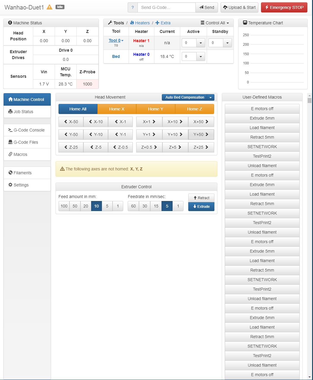

    Today I've decided to try and get my DuetWifi v1.02 working again.
    I've haven't touched it for a while, and spent last few hours getting back into it before deciding to update the firmware to make sure everything was upto date.
    After reading the firmware github page, I settled for the non-beta, and followed the instructions on how to install.
    I was on 1.19, so didn't have to follow those extra steps.
    I downloaded Release 2.02, "Duet2Firmware-2.02a.zip", and uploaded via the web interface.
    It offered to install it, I chose Yes since I didn't have any more files I wanted to upload. and it got on with it.
    Upon reload, the normal web interface appeared, looking slightly different.
    The Bug....
    My attention was immediately drawn to the User Defined Macros section on the right hand side, which shows the buttons for each macro, however its contents are being populated endlessly over and over again, the same macros in a loop.
    Very quickly that list grows beyond the bottom of the browser window, which makes the scroll bar appear as the page is now longer than the window size.
    The scroll bar handle very quickly 'shrinks', indicating that the list is stuck in a loop where its contents are being repeated in an endless loop.
    The first time this happened, i didn't notice. My browser froze, and I had to End Task to gain control, it wasn't until the second time I realised what had happened.

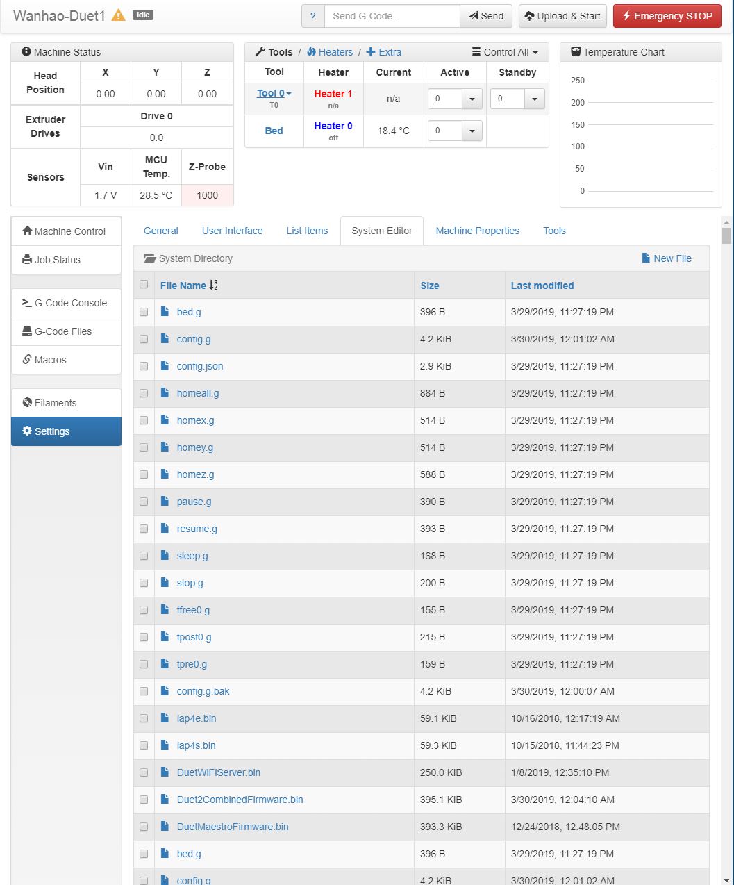

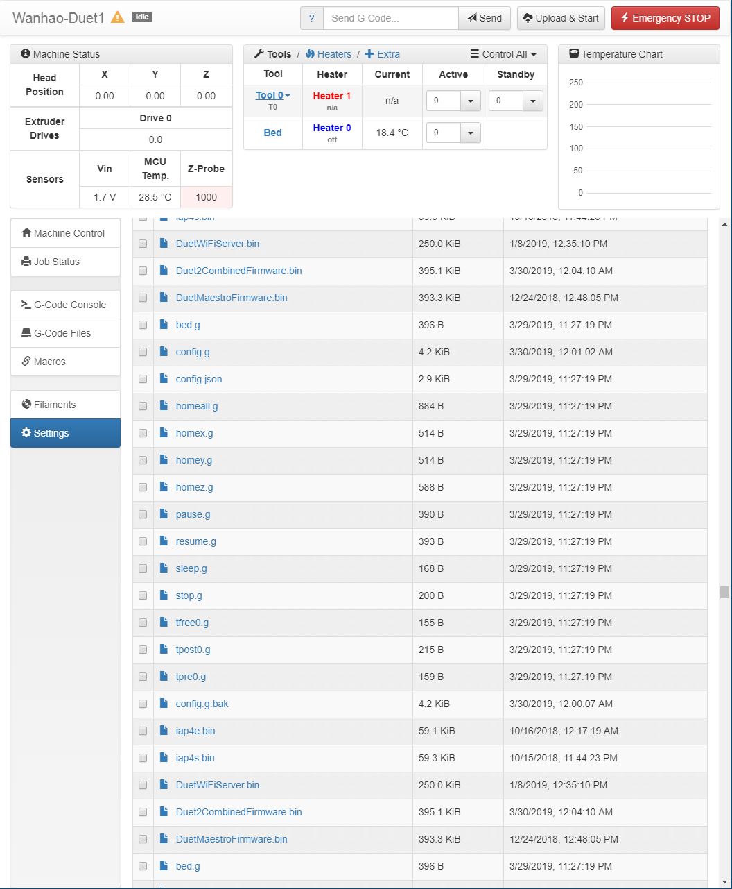

    To avoid the User Defined Macros list issue, I quickly his settings in hope that the list on the front page would stop populating with repeated items. But tabbing to System Editor gives a surprisingly similar behaviour.
    The system editor page/tab, is also a list of items/objects. And the same error is reproduced, but instead with the list of files in the sys directory of the sd card.
    Constantly looping as though the directory has millions of files with the same name.

      You have updated DWC but not the main firmware. See https://duet3d.dozuki.com/Wiki/Installing_and_Updating_Firmware#Section_Upgrading_a_Duet_2_WiFi_or_Ethernet_to_firmware_1_21_or_later_from_1_20_or_earlier.
      • undefined
        CuboidWales
        That worked perfectly...! Thanks!!
