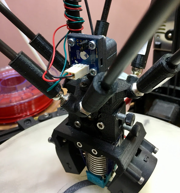

No LEDs
Here's the mount:

David, in my M591 commands during the print the current angle always returned as "0.00". Does this imply that my sensor is actually not working properly and needs to be closer to the magnet?

I'm in calibration mode and printing now. This is a part I print every day and my printer is acting very odd. It is printing and pausing every 6ish mm. Is this normal for calibration or is something wrong? I do see the LED flashing red. It is also not stuttering as much now as it was when I started writing but still obviously stuttering.
The problem continues. I disabled the M591 in config.g and behavior has returned to normal, albeit without the filament monitor operating. I suspect that my sensor is not reading the magnet but I'm not sure how to get it closer.
yes sounds like its not reading the magnet- you should get 3 or 4 gred and red together flashes at startup to show the magnet is registered properly
You are looking for a gap of~0.5mm this may be as simple in a variation between the printers we have printer the parts on. you can add a small shift in the SCAD or try just moving the hobb assembly very slightly where it is seated.
Thanks Tony, I'm taking it off and looking at it now.
