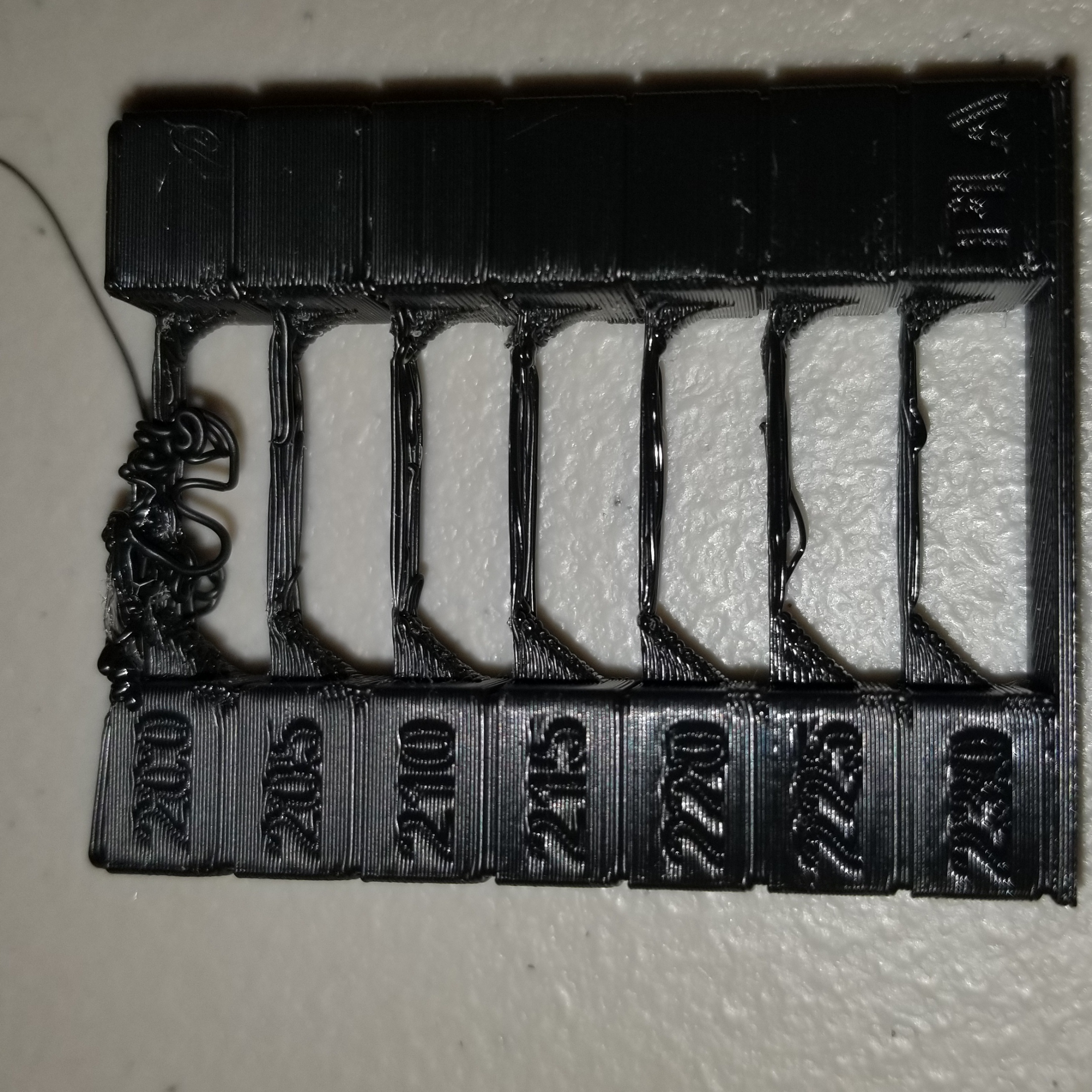

              going to try another cube and will drop the temp to 215 nozzle and 60 bed and see if this has helped any. The reason i went with 220 on this is with the old marlin board that came with the system it printed the best at this temp for the amazon basic black pla. The reason i switched over to duet was the system was so loud printing and i wanted a quieter system with better controls. will post up the result of the new print when they are done.

                    temp tower came out ok still getting some sloppy corners but bridging came out a bit crappy. Ran a 190-235 tower it everything 200 and up was ok 190 was a no go. nothing but string at the top.
                    I had taken off my TL-smoothers from when I was running on the stock marlin board do you think I should add those back on?

                        That looks like Amazon Basics Black PLA. I print that at 210-220c. So that checks out.
                        Keep in mind that you're printing a tiny cube on a very hot bed with a very hot nozzle dumping molten filament. It's going to look melty. Your print speed isn't very fast either.
