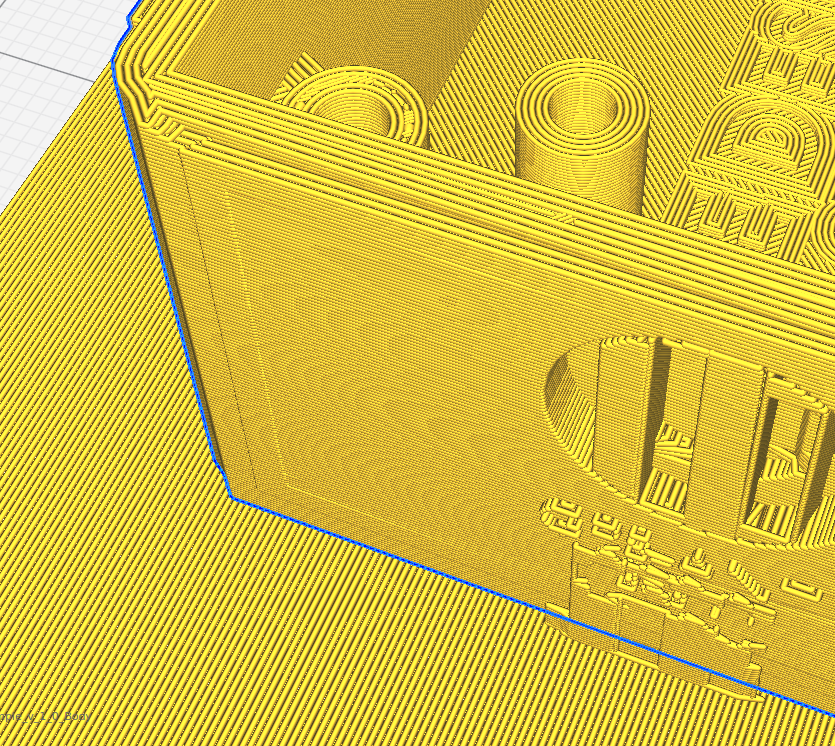

    While being very happy with the switch to the Duet Maestro on my Cetus MK1 with E3D Titan Aero, I'm fighting with a very weird outline problem. Currently I'm not sure if this is a slicing problem or just a configuration problem (acceleration, speed, jerk, micro steps, whatever). Maybe you can shine some light on it.
    It looks like this:
    While it should look like this:
    Any idea? Is this a slicer problem or a hardware / hardware configuration problem?
    PLA printed at 170°C at around 50 mm/s using Cura 4.1.0 and 4.0.0. GCode file is too big for upload here. Hope this link works for a while: http://www.filedropper.com/rtkbody2
    My config:

      Are you printing external perimeters first?
      undefined 1 Reply Last reply 5 Jun 2019, 18:44 Reply Quote 0
      • undefined
        Ted @Phaedrux
        @phaedrux Thanks for your help! Nope, inner layers first. Also tried with an "Extra infill perimeter" that aims to make the infill not influencing the skin. I also tried with better part cooling and lower temperatures (though 170 °C is already very low and there is clearly a movement problem). Thanks for your hint, though.
        Are my microsteps, currents, max speed changes and acceleration values ok for a that setup? Really not sure about that.

              I don't find the photos very clear but I think the print looks a little hot. So reduce extrusion temperature or increase print fan cooling. 170C is very low for printing PLA so I suspect you are using the wrong thermistor parameters.
              undefined 1 Reply Last reply 5 Jun 2019, 21:07 Reply Quote 0
              • undefined
                Ted @dc42
                @dc42 Thanks for your help! I thought about a wrong thermistor value as well, but for the bed where the same thermistor is used it is working perfectly. I could check with an optical thermometer, but only up to 60°C as my heatbed doesn't want to get higher. Are my thermistors defined right for that type?
                M305 P0 B4725 C7.06e-8 H30 L0
                M305 P1 B4725 C7.06e-8 H30 L0
                Anyways, also wrong temperature shouldn't cause that movement failure. The most curious thing is that the print seems to recover on upper layers. That means that missing steps (hardware) cannot be the problem as the absolute positioning origin is the same for those layers.
                Could it be that the steps are too big or so and more/less microsteps are needed?
                Some thing that I set up wrong with the Trinamic drivers using M569 command?
                (I'm just pointing randomly on things that I don't feel that I completely understood. 😉 )
                undefined 1 Reply Last reply 6 Jun 2019, 08:00 Reply Quote 0

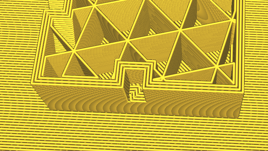

                                          Ted
                                          I've found another problem that I want to solve first as it more pronounced, easier reproducible and might even have the same cause:
                                          Looking at the following image (A standard XYZ test cube) the printer "lays its sausage" for the three perimeter walls counter-clock-wise around the already printed infill, starting at the most inner perimeter line and stopping at the most outer.
                                          On the image I have drawn red and blue arrows for the movement. The red arrows indicate the problem area: Instead of doing a 90° corner the printer cuts the corner starting about 1 mm bevor it in a much smaller angle.
                                          This was printed with PLA (same settings as above) at 20mm/s using Cura 4.1.0.
                                          While it does look very small on the image, it is very noticeable and ugly holding the print in the hand. Every 90°-to-the-left corner does have a phase of 1 mm. Text printed on top of things is hardly readable.
                                          Curious about it is also that when looking at previous prints made before switching to Duet Maestro and to Cura with the same setup no such round corners are visible. They all are crisp!
                                          At the moment I think this is some hardware configuration problem as the problem is invisible looking at the gcode:
                                          I don't know what causes this. I have no clue. Hopefully you have one!
