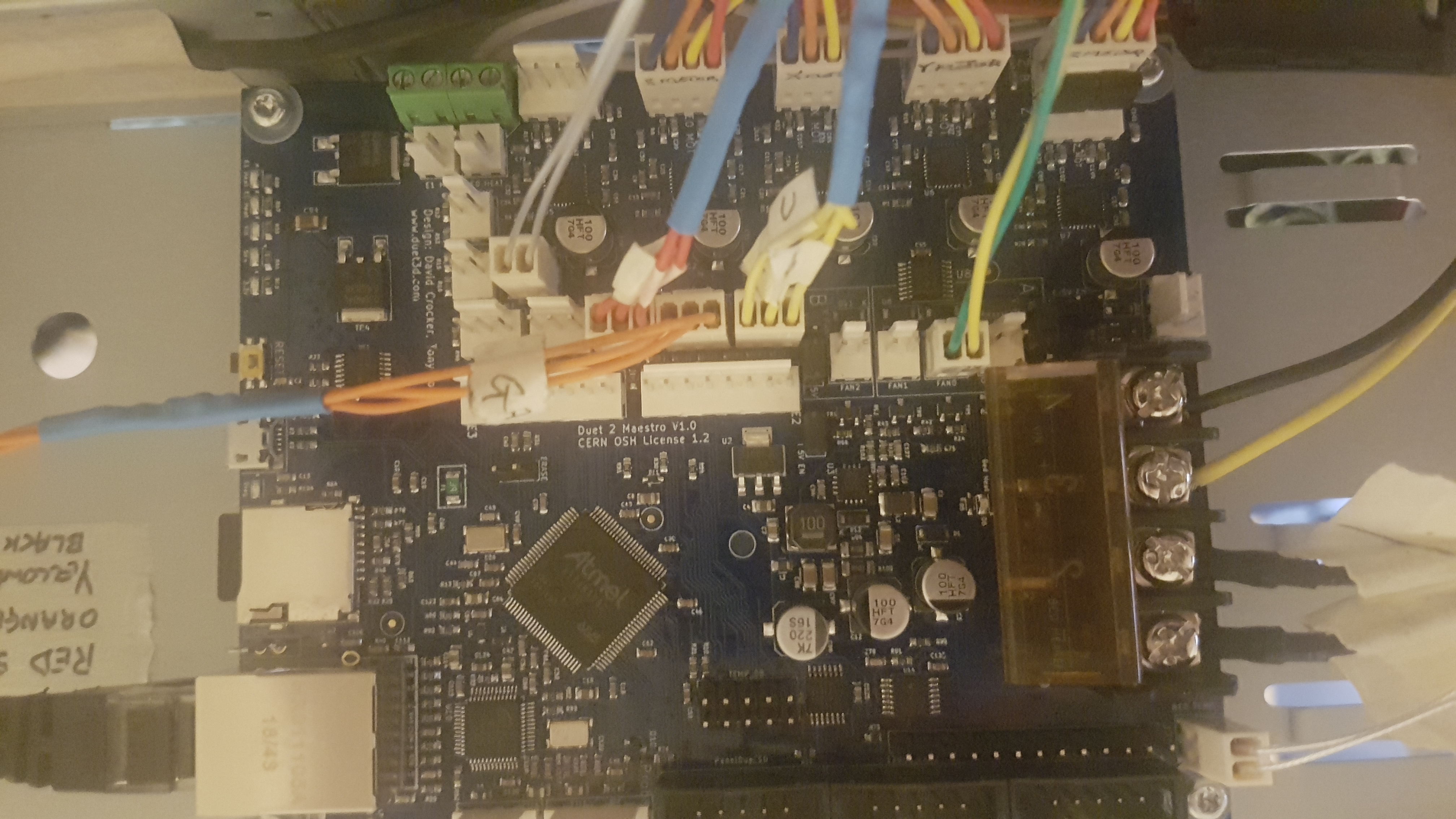

Hi as I have mentioned I have been updating my Da Vinci with a new Duet2 Maestro board.
After having trouble with the stock thermistors I have bought two new PT1000.
I have connected them to the board and re-configured the firmware with the RRF cofigurator {using the standard settings for PT1000s to the bed a and extruder).
I am getting readings of 147C for the extruder and 208C for the Bed at an ambient temperature of around 21C. If I swap the two thermistors on the board I still get the same readings 147C for the extruder and 208C for the Bed. I have removed the PT1000s from the Bed and the extruder to eliminate any false readings through leakage. with these hanging free in fresh air at around 21C I still get 147C for the extruder and 208C for the Bed.
I am at a loss on what to do next any welcome.
Apologies for bringing the PT1000s were only delivered last weekend.
Many Thanks
Please post your config.g file, and tell or show us how you have connected the PT1000 sensors to the Duet.

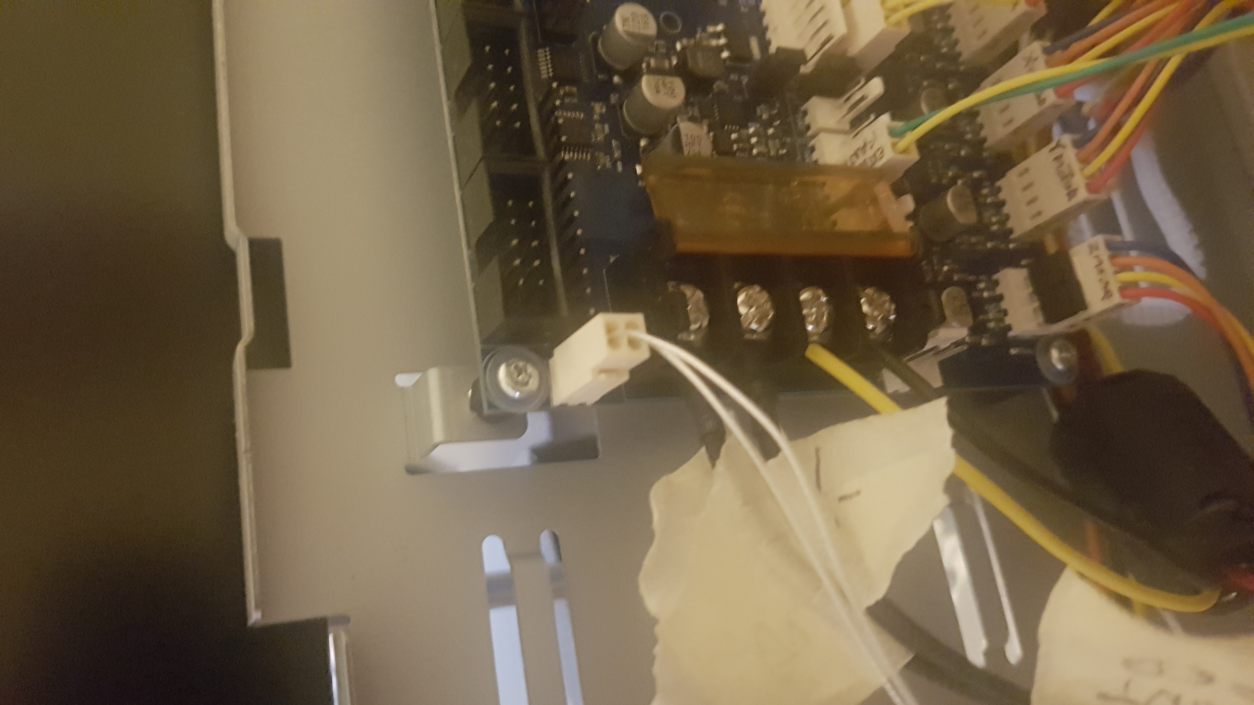

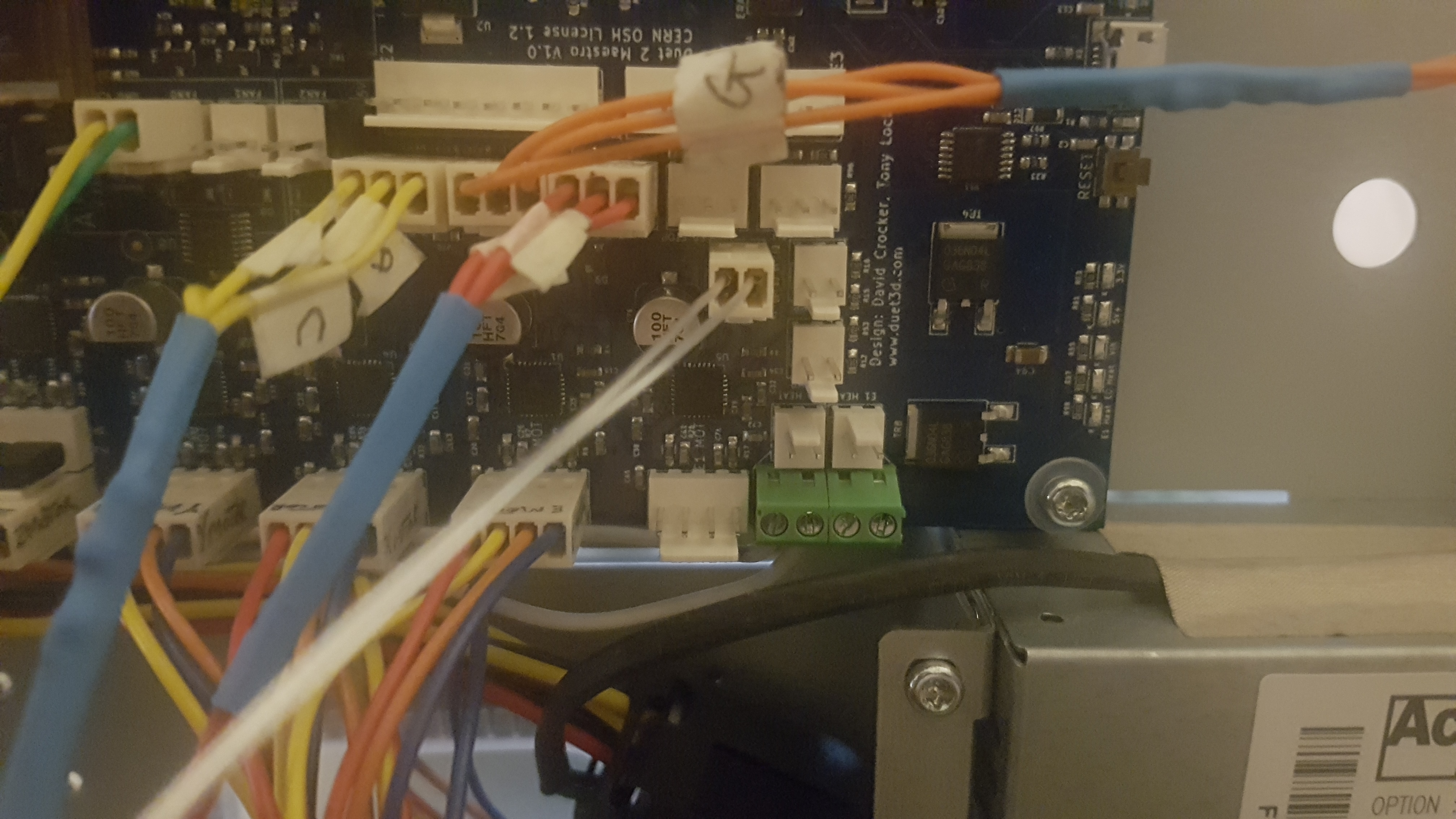

Hi @dc42 I have attached the config.g file as well as the images below showing that one PT1000 is hooked up to the Bed Thermmistor and the other one to the extruder is connected to E0 Thermistor 2.
can you measure the resistance of your thermistors.
also post your config.g thermistor config. -
I have measured the resistance of the thermistors and its 1092 ohms.
I have measured across the two pins where the thermistors connect to the board and I get 4.68K ohms without the thermistors connected. I then did the same check with everything disconnected from the board and I still get 4.68k ohms.
Now with everything connected to the board including the thermistors I measured across the thermistor pins on the board and I get 0.835 and 0.837k ohms.

R4700 is for the duet wifi not the maesto. the maestro uses R2200.
pt1000 are configured like this
M305 P1 X501 R2200 ; Configure PT1000 for heater 1
I have changed the settings to
M307 H0 B0 S1.00 ; Disable bang-bang mode for the bed heater and set PWM limit
M305 P0 X500 R2200 ; Configure PT1000 for heater 0
M143 H1 S280 ; Set temperature limit for heater 1 to 280CBut still seem to be getting the same temperature readings.
You can leave out the R parameter in the M305 commands because the firmware knows the correct value. It's only on really old boards (Duet 0.6 and Duet 0.8.5) that it is needed.
If the PT1000 sensors read 1092 ohms at room temperature. that is about right and you should get good readings from them.
Try sending M305 P0 with no other parameters, and check it reports that it is configured for a PT1000. Likewise M305 P1.
If that looks OK, try disconnecting both PT1000 sensors at the Duet and connect 1K resistors between the pins of the thermistor connectors. That should give you a reading close to 0C. if that works, then you may have a short between the PT1000 wiring and the heater wiring, perhaps via the hot end metalwork.
also measure the resistance across R15, R19 and R53 on the board.
