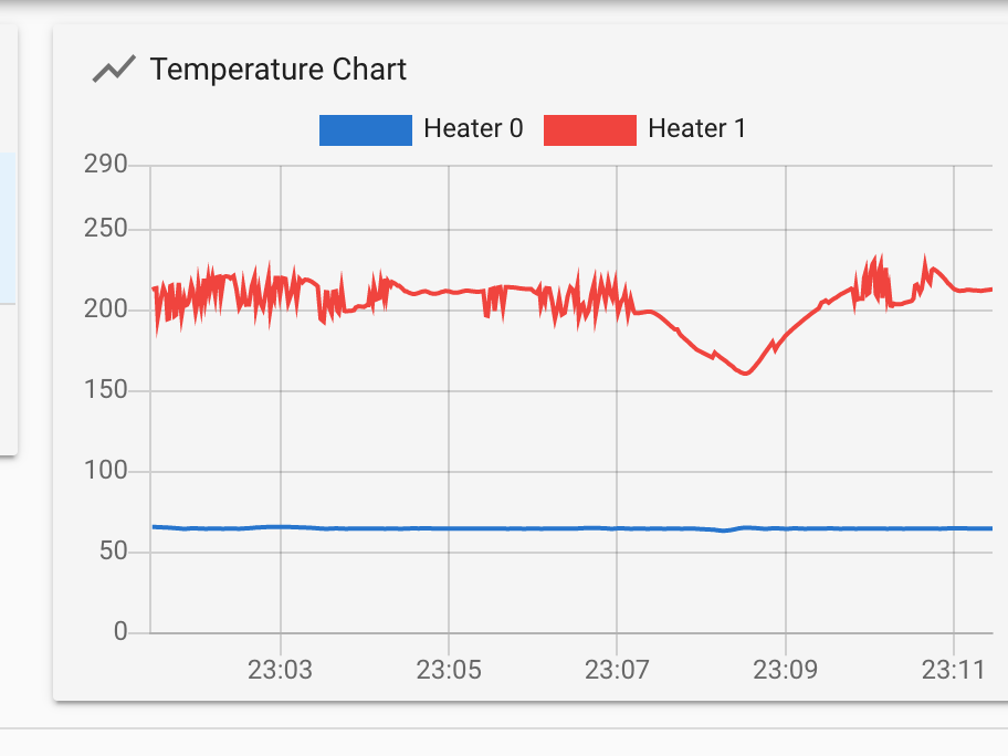

After ~10 hrs of printing I hadn't seen the issue, and then I saw it a few times in a row, within minutes. I'm used to a rock-solid temperature, and now I'm seeing something very noisy:

I re-calibrated the extruder heater but the values were pretty similar, and now, watching the PanelDue, I see the temp drop ~20C from the setpoint nearly instantaneously, then jump back up to setpoint. When heating from cool (as in the inline pic above), I don't see this (it would take many seconds to change 15 degress!), so I really have no idea how such fast changes are even possible.
The part I'm printing now is just a cylinder and it's seeing huge noise:
I'm wondering if I have a failing thermistor or heater connection somewhere... it just doesn't seem like the temp measurement is trustworthy. The fairly weak extruder fan I have now seems unlikely to cause such a temp drop.
As always, any help would be appreciated.
that does look like there is something wrong with the thermistor.

I tried jiggling the board-to-effector cable and the effector crimp cable for the thermistor, and I could not see any evidence of the problem seen last night. That makes me think that nothing from the effector up is relevant. I unplugged and replugged the thermistor plug (connecting the effector to the thermistor) too. Now the problem seems to have gone.
I'm back to +/- 1C variation now. This doesn't prove out that the crimp connections are the source of the issue, but the fact that I never saw the issue for ~2 yrs and ~300-500 hrs of printing, then it became intermittent (once every ~50 hrs), then last night it was every few minutes, makes me think that this crimp experienced some kind of quality degradation over time that progressively worsened. I'll only know if after another 50 hrs I don't see the problem, but I'll consider it fixed for now, and have ordered another thermistor just in case.
