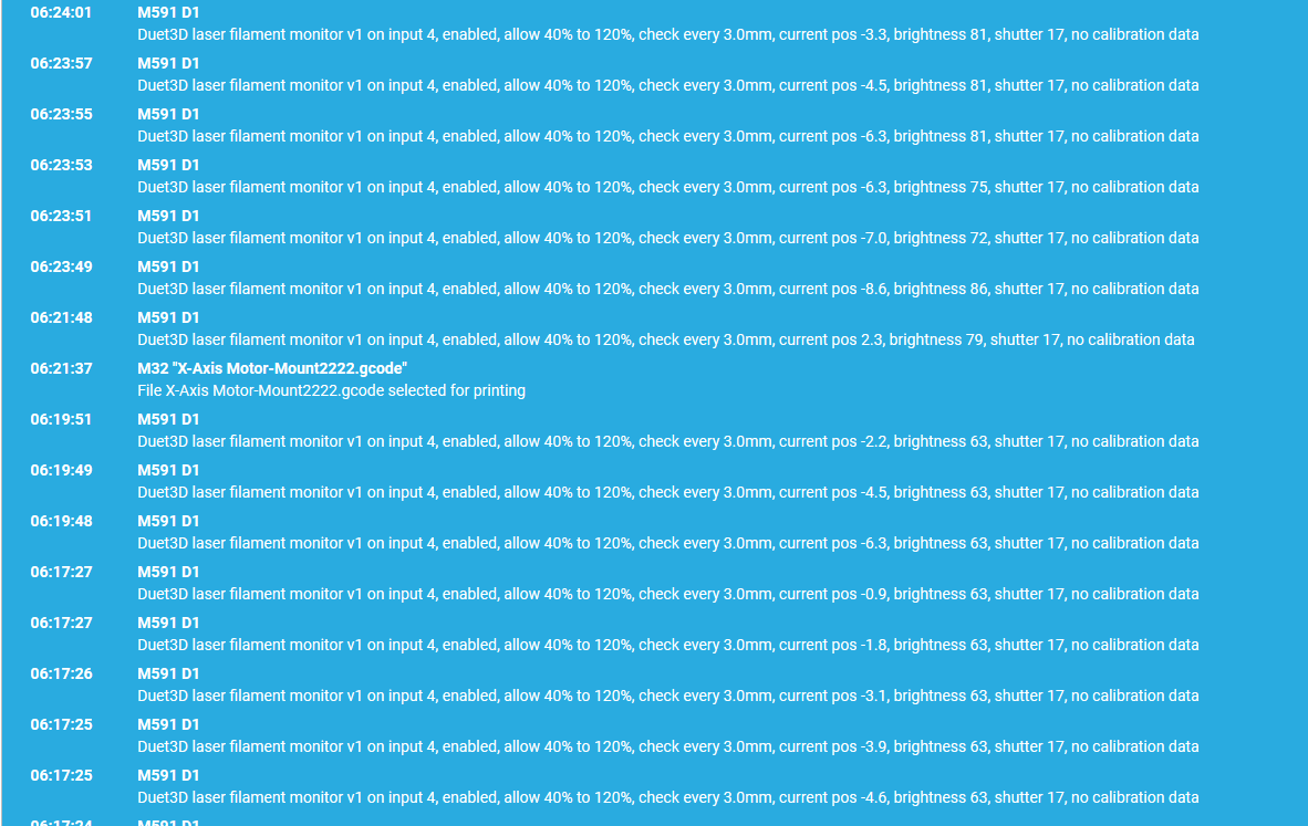

      Hello everyone
      I have the following problem with the laser monitor.
      I can not determine a calibration although I have made all the steps exactly according to instructions.
      what can this be?
      see in the picture.
      the printer has already extruded about 3m filament and I get nothing.
      in the config, I have the following in it
      ; laser sensor
      M591 D1 P5 C4 R40: 120 E3.0 S1
      M591 D2 P5 C3 R40: 120 E3.0 S1
      M591 D3 P5 C0 R40: 120 E3.0 S1
      M591 D4 P5 C1 R40: 120 E3.0 S1
      if I replace the S1 with a 0 does not matter.
      I urgently ask for help.
        You have configured filament monitors on extruders 1 thru 4, but not on extruder 0. Have you definitely extruded through extruder 1, not extruder 0? What D parameter do you use in the M563 command for the tool you have selected, and if it's more than one extruder, what mix ratio did you use?

              Which tool number did you use for that test print?

                @dc42 tool 1
                • 3dwareundefined
                  3dware @dc42
                  @dc42 on the D0 according to the readout no sensor is installed and the D1 reads it actually clean
                    dc42 administrators @3dware
                    @3dware said in Laser monitor:
                    @dc42 tool 1
                    From your config.g file:
                    M563 P1 S"1xHotend" D0 H1 ; Define tool 1
                    The D0 means you are using extruder drive 0. Your M591 command has D1, so it is monitoring extruder drive 1.
                    3dwareundefined 1 Reply Last reply Reply Quote 0

                      @dc42 Only I do not get anything out at d0
                      I plugged in the sensors like this.
                      I have aninst somewhere a mistake0_1561456115011_Wifi_v1.04_above_wb_small-800x800.png
                        I think your mistake is this line:
                        The sensor is monitoring extruder drive 1, but tool 1 uses extruder drive 0. Change D1 to D0 in that line. Likewise when you interrogate it, use D0 not D1.
