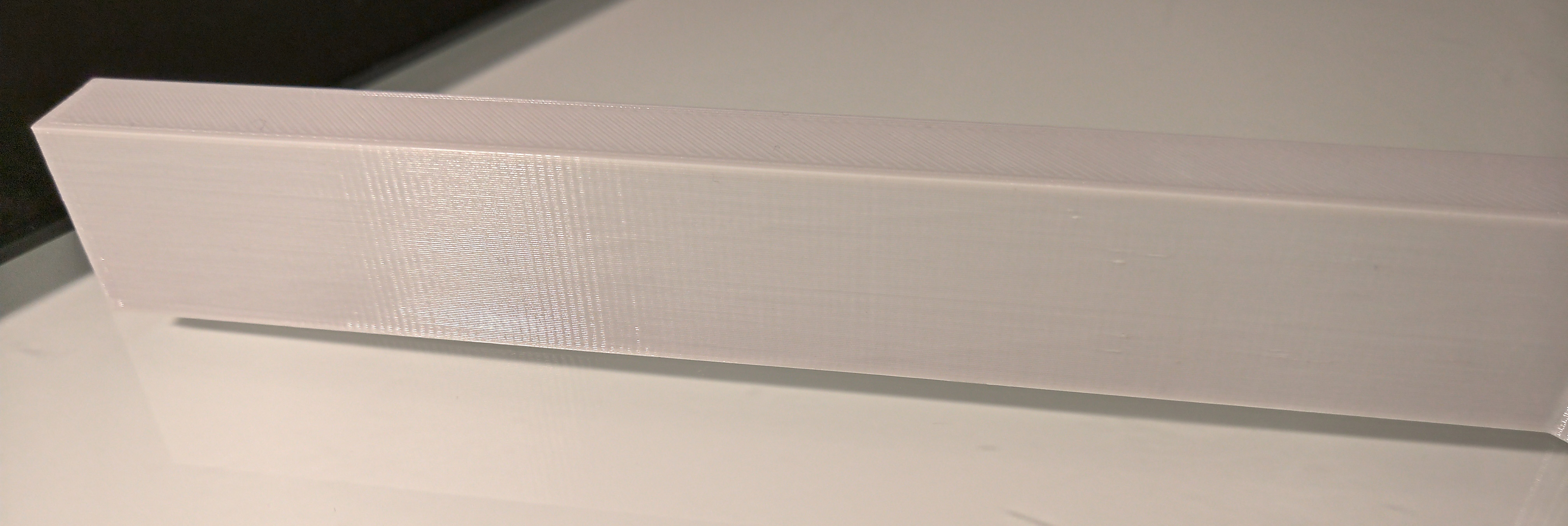

since a while (possibly since I've switched to a Duet 2 Wifi) I've been fighting with a weird print quality issue.
What happens is that all my flat walls suffer from weird vertical lines, that are clearly visible under the right light and often also sensible when going over the wall with fingernails etc.
It kinda looks similar to ringing, just that it happens everywhere and even on very long straight moves.I tried many things to solve this, but by now I'm out of ideas and wonder if it's maybe not a mechanical issue but rather something software wise.
Please note, these vertical lines are all the same across that entire wall, the light just makes it look like they are only in some spots, it's a very regular pattern. They also appear on all walls, no matter the axis.
That specific print has a layer height of .2mm, using 3 line wide shells with a .4mm nozzle and 15% triangle infill. The same issue also appears with smaller (.3mm) and larger (.6mm) nozzles the same way. Layer height does not affect it either.

Does changing the extrusion amount change the distance between ridges?

Here are some tests you can do:
If you print a cube, do you get that pattern on both pairs of faces, or only one pair? If both faces then it's probably and extrusion issue. If one pair then it's an axis movement issue.
If you change the layer height or the extrusion width (so that the extrusion rate per linear mm of the print changes), does the pitch of the vertical lines change? If yes then it's an extrusion issue, if no then it's an axis movement issue.
Thank you both a lot for your answers, since my Aero is a bit tricky to take apart I'll test print two cubes at .1 and .3mm layers first to further assure that it's an extrusion issue.
Ok so, results are in, the change in layer height made a massive difference, with .3 the issue is barely visible (probably frequency high enough for it to disappear?), while .1 shows it very clearly.
It also shows on all walls of the cube, even though one axis seems to suffer a bit less (on both cubes), but's clearly visible on all walls.So other than Titan bearings, any other ideas I can try before taking the printer apart? Maybe something about micro stepping, interpolation etc? Bed leveling maybe? (I got a Z probe installed)

If the striations are vertically aligned doesn't that rule out the extruder? I mean wouldn't it be a remarkable coincidence to have a perimeter that was an exact multiple of the extruder microsteps or tooth pitch?
Isn't it more likely axis speed modulations?
Is the pitch of the lines related to the belt tooth pitch?
Do you have any toothed belts running tooth side inwards over smooth pulleys?

The belt pitch is likely 2mm. Is the distance between ridges also 2mm?

The pitch seems to be something like 1.2mm (averaged over 7 peaks), hard to measure...

Both idler and pulley have 20 teeth on both axis.
I have found the solution. You need to use teeth idlers instead of flat.
