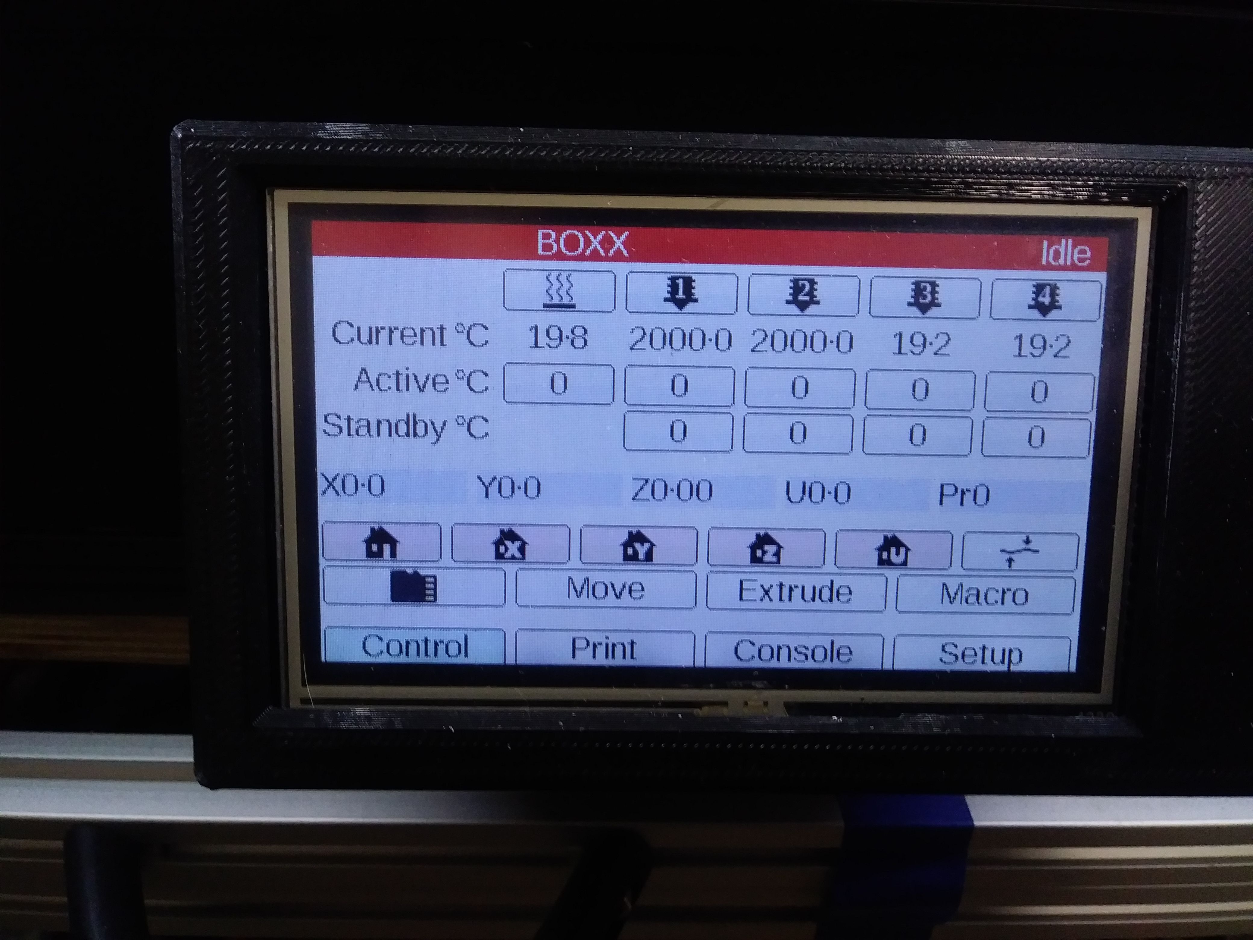

      1. Cannot get layer fans to show up in DWC and also cannot get them to come on during a print
      1. I have my two extruders set up on my Duex5 on heaters 3 & 4 using drives 5 & 6. They show up fine in the DWC but not on my panel Due 4.3. I have updated the panel due firmware to the latest but this is how they show up.
        As you can see I cannot get them to show up as 1 & 2 and instead show up as 3 & 4. I am not using any heaters on my Duet Wifi, only the Duex5
    INFO:
    Board: Duet WiFi 1.0 or 1.01 + DueX5
    Firmware: RepRapFirmware for Duet 2 WiFi/Ethernet 2.04 (2019-11-01b1)
    Duet WiFi Server Version: 1.23
    Duet Web Control 2.0.4
    Here is my CONFIG.g
    ;General preferences*******************************************************************
    M669 K1 ; Select CoreXY mode
    ;Axis Limit*******************************************************************
    M208 X0:355 Y0:355 Z0:400 ; Set axis min/max
    ;M208 U0:180 ; Set axis min/max
    ;Endstop Settings*******************************************************************
    M574 Z1 S2 ; Set endstops controlled by probe
    M574 X1 Y1 S1 ; Set active high endstops
    ;M574 U1 S1 ; Set homing switch configuration for toolchange lock. Both switches should be wired NC and in series.
    ;Z-Probe*******************************************************************
    M307 H7 A-1 C-1 D-1 ; Disable heater on PWM channel for BLTouch
    M558 P9 F100 H5 R0.2 T6000 B0 ; Set Z probe type to BLTouch and the dive height + speeds
    G31 P25 X-3 Y-39.3 Z0.4 ; Set Z probe trigger value, offset and trigger height
    M557 X15:350 Y20:350 S2 ; Define mesh grid
    ;Drives*******************************************************************
    M584 X0 Y1 Z2:3 E5:6 ; Drive mapping
    ;M584 U4 ; Drive mapping
    M569 P0 S0 ; X Drive 0 goes forwards
    M569 P1 S1 ; Y Drive 1 goes backwards
    M569 P2 S1 ; Z1 Drive 2 goes backwards
    M569 P3 S1 ; Z2 Drive 3 goes backwards
    ;M569 P4 S1 ; U Drive 4 goes backwards
    M569 P5 S0 ; E0 Drive 5 goes forwards
    M569 P6 S0 ; E1 Drive 6 goes forwards
    ;M569 P7 S0 ; NOT USED
    ;M569 P8 S0 ; NOT USED
    ;M569 P9 S0 ; NOT USED
    M350 X16 Y16 Z16 E16:16 U16 I1 ; Configure microstepping with interpolation
    M92 X66 Y66 Z1600 E443.62:443.62 U100 ; Set steps per mm
    M566 X200 Y200 Z300 E1000:1000 U100 ; Set maximum instantaneous speed changes (Jerk) (mm/min)
    M203 X30000 Y30000 Z400 E4000:4000 U5000 ; Set maximum speeds (mm/min)
    M201 X600 Y600 Z20 E1000:1000 U800 ; Set accelerations (mm/s^2)
    M906 X1200 Y1200 Z1300 E300:600 U1500 I30 ; Set motor currents (mA) and motor idle factor in percent
    M84 S30 ; Set idle timeout
    ;Heaters*******************************************************************
    M305 S"BED" P0 T100000 B4138 C0 ; Set thermistor
    M143 H0 S225 ; Set temperature limit for heater 0 to 225C
    M305 S"T0" P3 R4700 T100000 B4388 ;Set thermistor
    M143 H3 S300 ; Set temperature limit for heater 3 to 300C
    M305 S"T1" P4 R4700 T100000 B4388 ; Set thermistor
    M143 H4 S300 ; Set temperature limit for heater 4 to 300C
    ;Tools*******************************************************************
    M563 S"T0" P0 D0 H3 ; Define tool 0
    G10 P0 X0 Y0 Z0 ; Reset tool 0 axis offsets
    G10 P0 R0 S0 ; Reset initial tool 0 active and standby temperatures to 0C
    M563 S"T1" P1 D1 H4 ; Define tool 1
    G10 P1 X0 Y0 Z0 ; Reset tool 1 axis offsets
    G10 P1 R0 S0 ; Reset initial tool 1 active and standby temperatures to 0C
    ;tool offsets
    G10 P0 X9 Y39 Z0 ; T0
    G10 P1 X9 Y39 Z0 ; T1
    ;G10 P2 X-9 Y39 Z-5 ; T2
    ;G10 P3 X-9 Y39 Z-5 ; T3
    ;Fans*******************************************************************
    ;M106 P0 S0 I0 F500 H-1 ; UNUSED
    M106 C"T0 FAN" P3 S255 I0 F500 H3 T70 ; T0 HE
    M106 C"T0 LAY FAN" P4 S0 I0 F500 H-1 ; T0 PCF
    M106 C"T1 FAN" P5 S0 I0 F500 H4 T70 ; T1 HE
    M106 C"T1 LAY FAN" P6 S0 I0 F600 H-1 ; T1 PCF
    ;M106 P7 S0 H3 T70 ; T2 HE
    ;M106 P8 S0 ; T2 PCF
