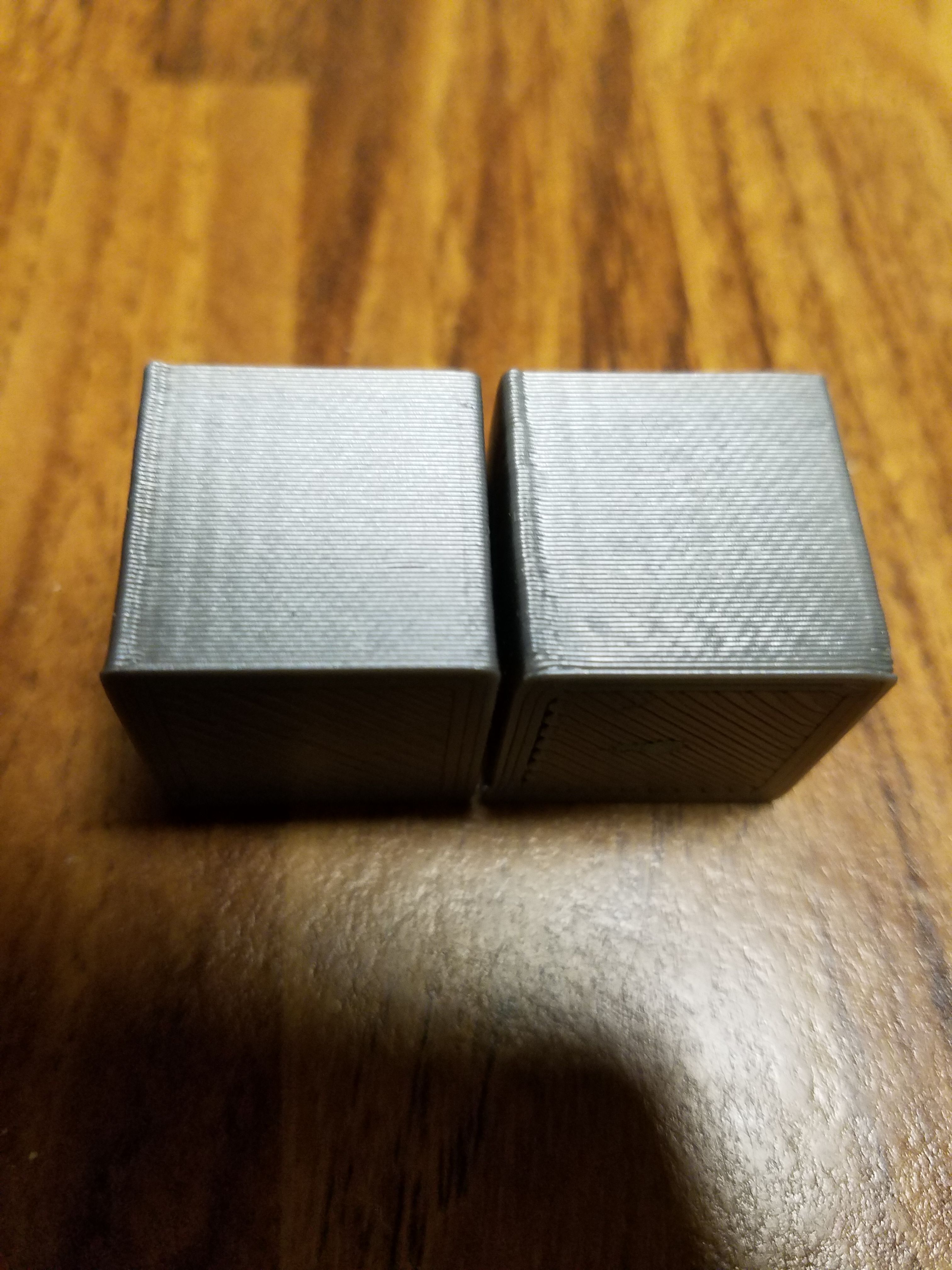

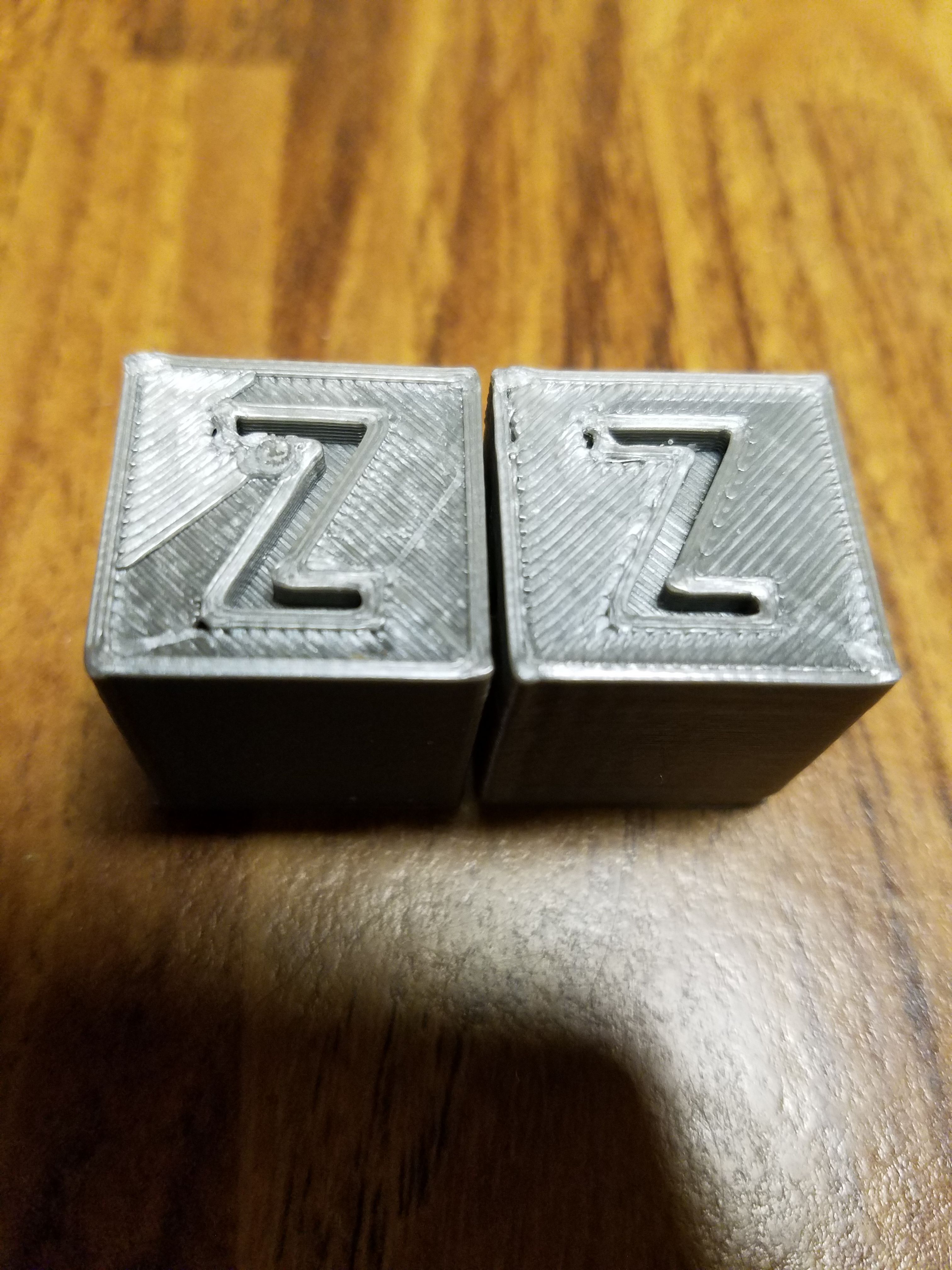

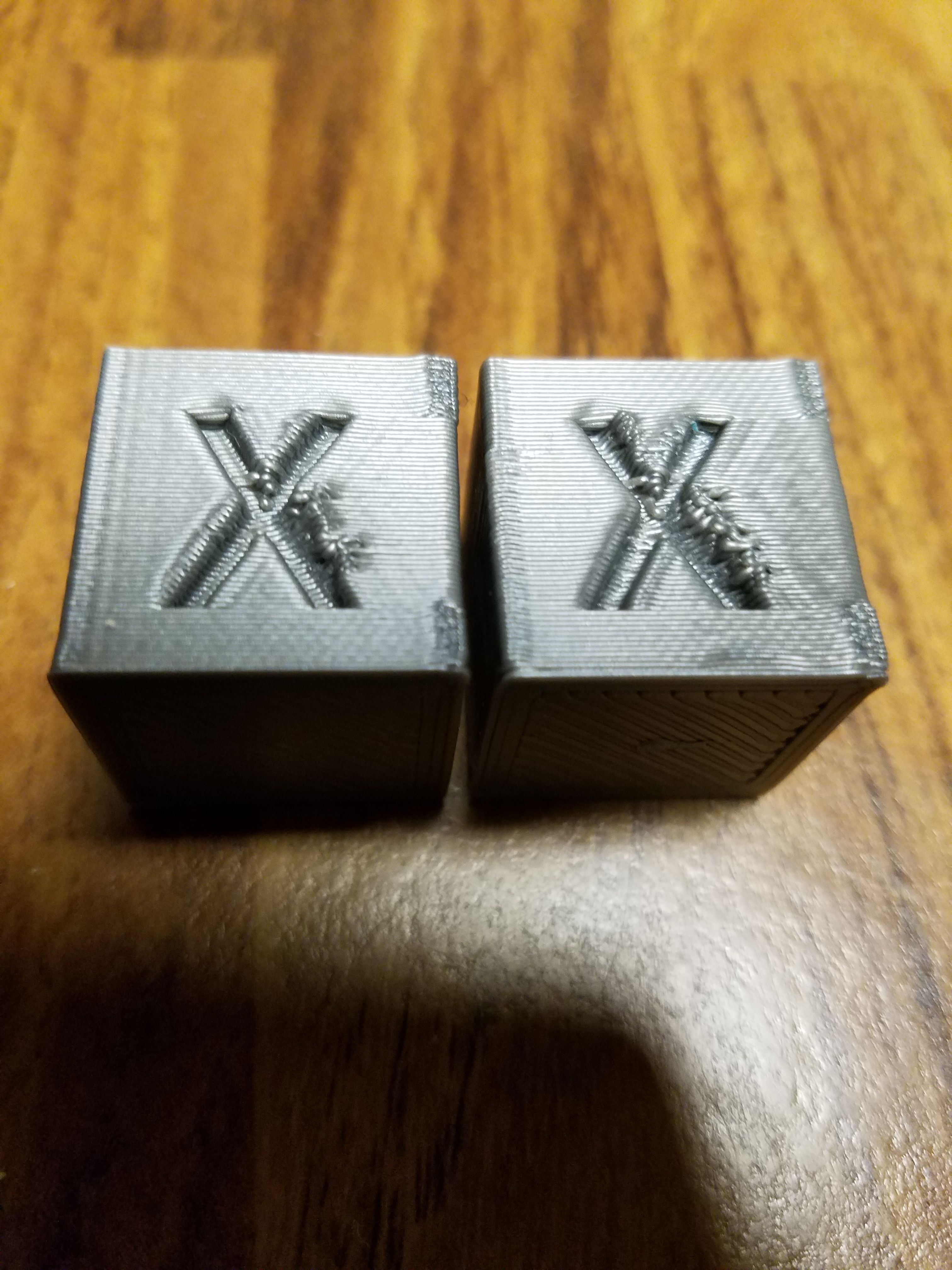

I've finally have coerced my mostly homebrew highly hacked AnyCubic Kossel Linear Plus printer to print.
However, it exhibits a couple of anomalies that I have been unable to discover their cause. I suspect that that these are things that others have already diagnosed and resolved and perhaps might care to share their fix.

config_terse.gThe following are photos of the artifacts, starting with the Y side, turned over to next side, then top or Z side and finally bottom.
I appreciate any help or suggestions given.. Thanks in advance,

my first thought would be inadequate cooling or one sided cooling.
second your bowden tube is very long (have you looked at flying extruders?)
third. you have artefacts where retraction is happening. this could point to wrong retraction settings.
try printing this. https://www.thingiverse.com/thing:909901can you print the cube without pressure advance? to compare.
Thank you for your cogent reply. I printed two of the spike 'retraction test' objects using Silver PLA (first layer 215°C and remaining 210°C), by PrintedSolid 'Daily PLA'. One test object with pressure advance and the second object with PA disabled. There was a significant difference between the two test articles' quality. The object with Pressure Advance is on the left while without, on the right side of photos. For the first print, I also lowered the bed temperature 5°C
I am of the opinion that there is some mechanical issue that needs rectification, but I'm not too certain what it is.

this looks to me that the pa needs more tuning. but pa with a long bowden tube can be problematic
