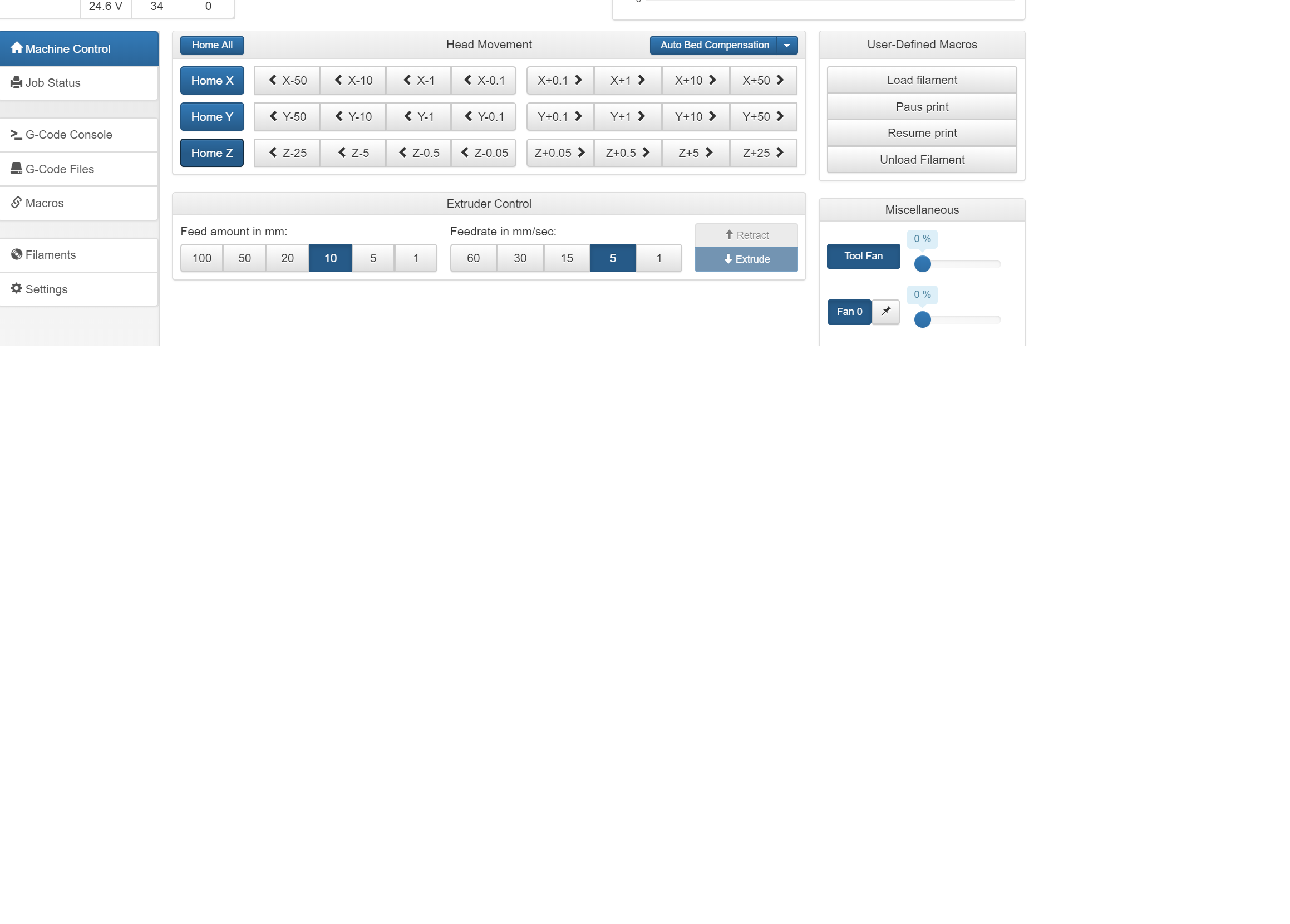

    extruder buttons in DWC won't be gray, its grayed out
    310
    • chris4undefined
      chris4
      HI again, what I'm doing wrong, the extruder buttons in DWC won't be gray, its grayed out.

        hi,
        the extrusions button wil be gray if you heat your hotend over 160 °C (is a default setting) for more Information see https://duet3d.dozuki.com/Wiki/Gcode#Section_M302_Allow_cold_extrudes

        • chris4undefined
          chris4
          but is it ok configured in tools? Also has Allow cold extrusion
          • SIamundefined
            SIam
            for cold extrusion you have to set M302 P1

            • chris4undefined
              chris4
              Thanks! I missed, sory.
