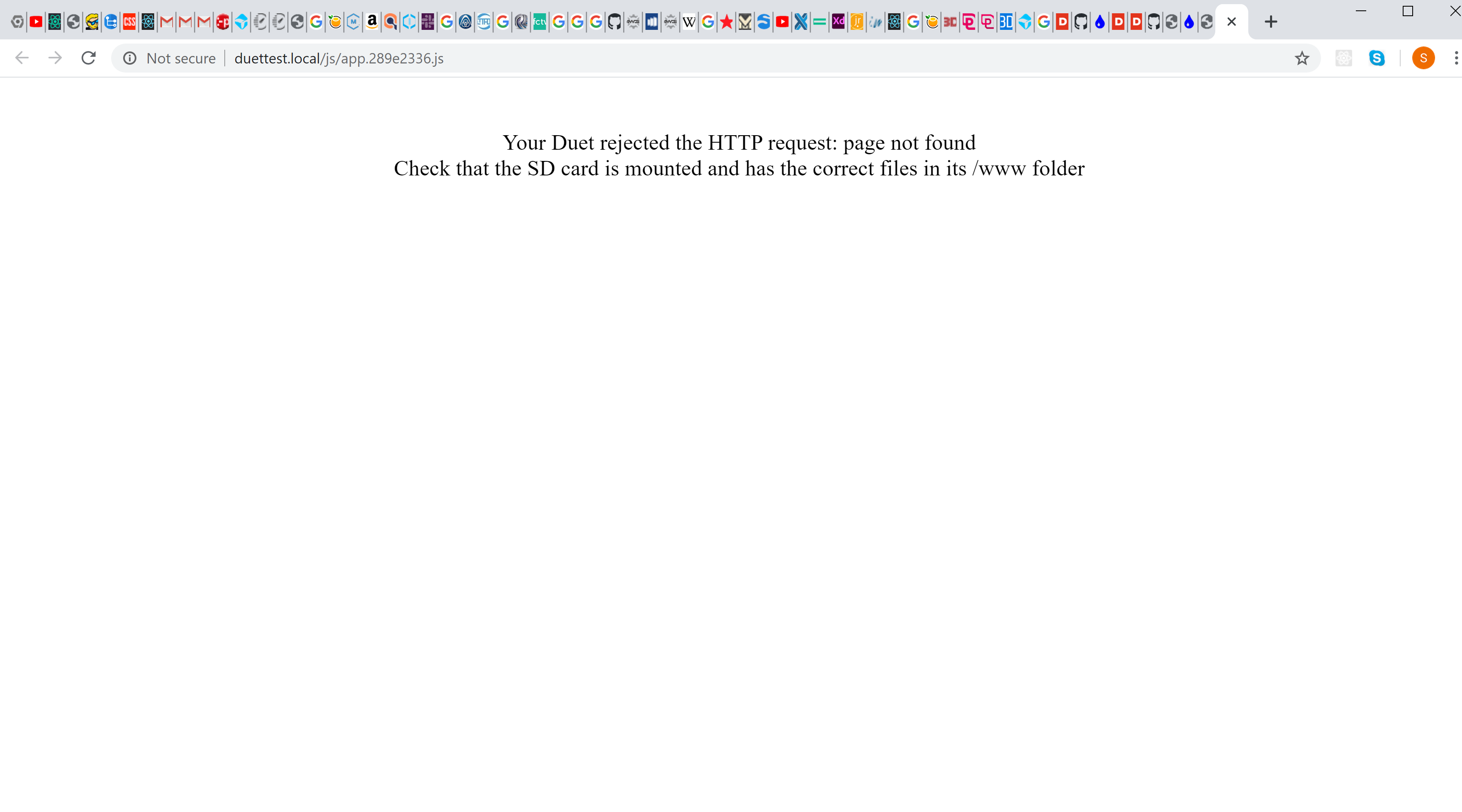

    Issue
    Duetwebcontrol interface not loading after upgrade to 3.1.1
    Followed
    https://duet3d.dozuki.com/Guide/1.)+Getting+Connected+to+your+Duet/7
    https://github.com/Duet3D/RepRapFirmware/releases
    Results
    After connecting WiFi - upgraded directly to the latest 3.1.1 via Duet web control - the Web interface doesn’t load anymore!!!

    I restored 3.0 files on the SD card and the interface is now showing - but the upload button for firmware release updates is missing - unbelievable 🙂

    Your screenshots are too small to be legible unfortunately so I can't make out what you've actually sent and received from the console or trying to show. Great UX design. 😜
    When you try to connect to the Duet IP, what exactly d you see?
    What firmware version were you using before updating to 3.1.1?
    If you still have USB console access to the Duet, please send M115 and report the installed firmware version.
    For the DWC files, you can manually replace the contents of the /www folder on the SD card with the contents of the DWC 3.1.1 zip file.

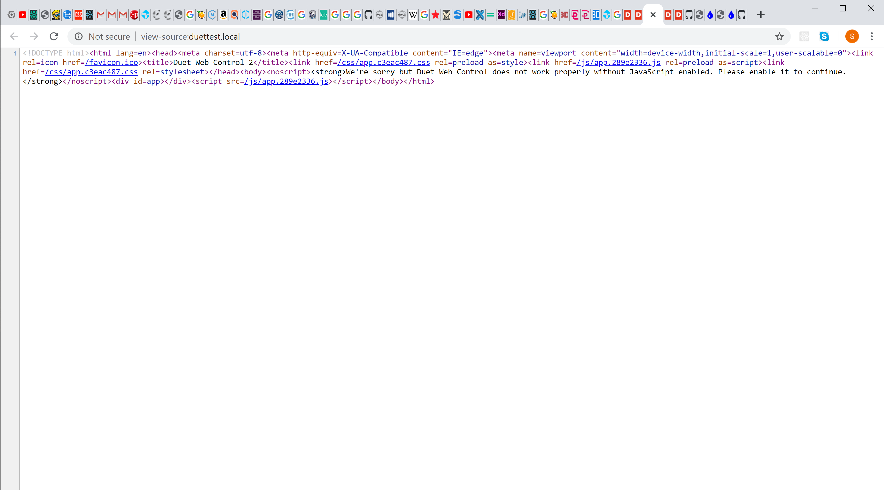

    the only screenshot that is legible suggest that there is an issue with the content if your sd card, its essentially 404 page, there needs to be an index.htm.gz in /www on the cd card.
