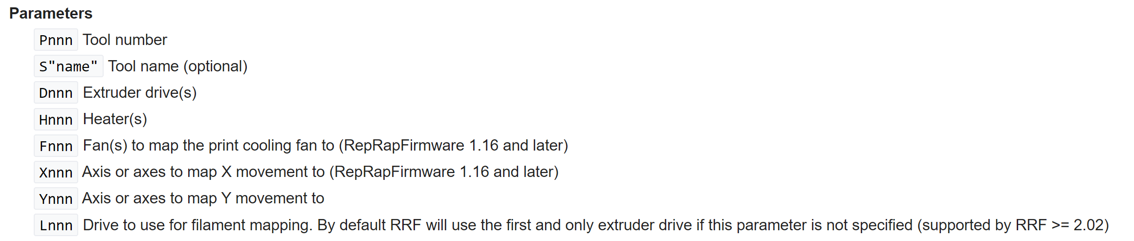

I am adding additional thermistors to the 3 that I am already using with the extrusion heaters and bed heaters on a Duet 2 WiFi and RRF 3.01. ow do I get those readings on the DWC if I won;t be using any of the heaters? I have been using M308 and M563 commands so far, and they don't seem to be working. I only get the display of the thermistors names but no readings so far.
