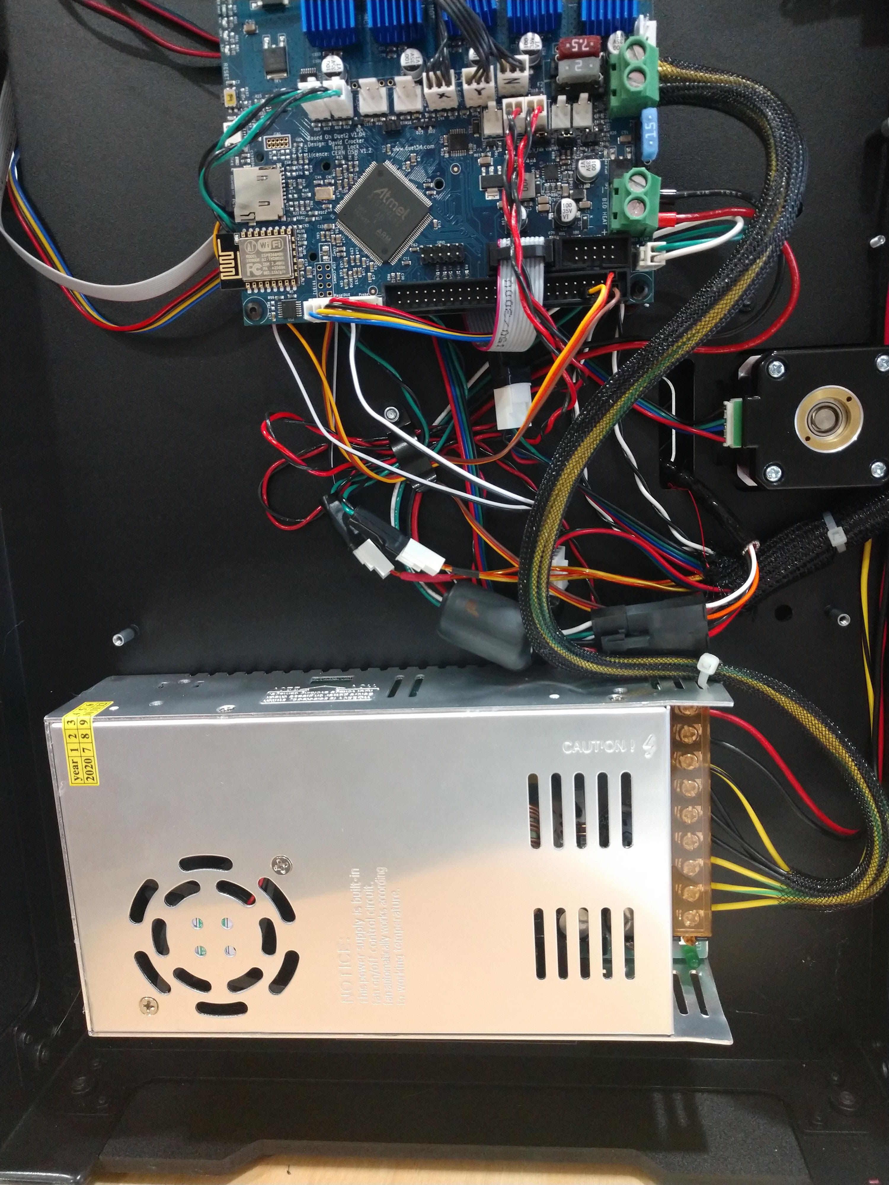

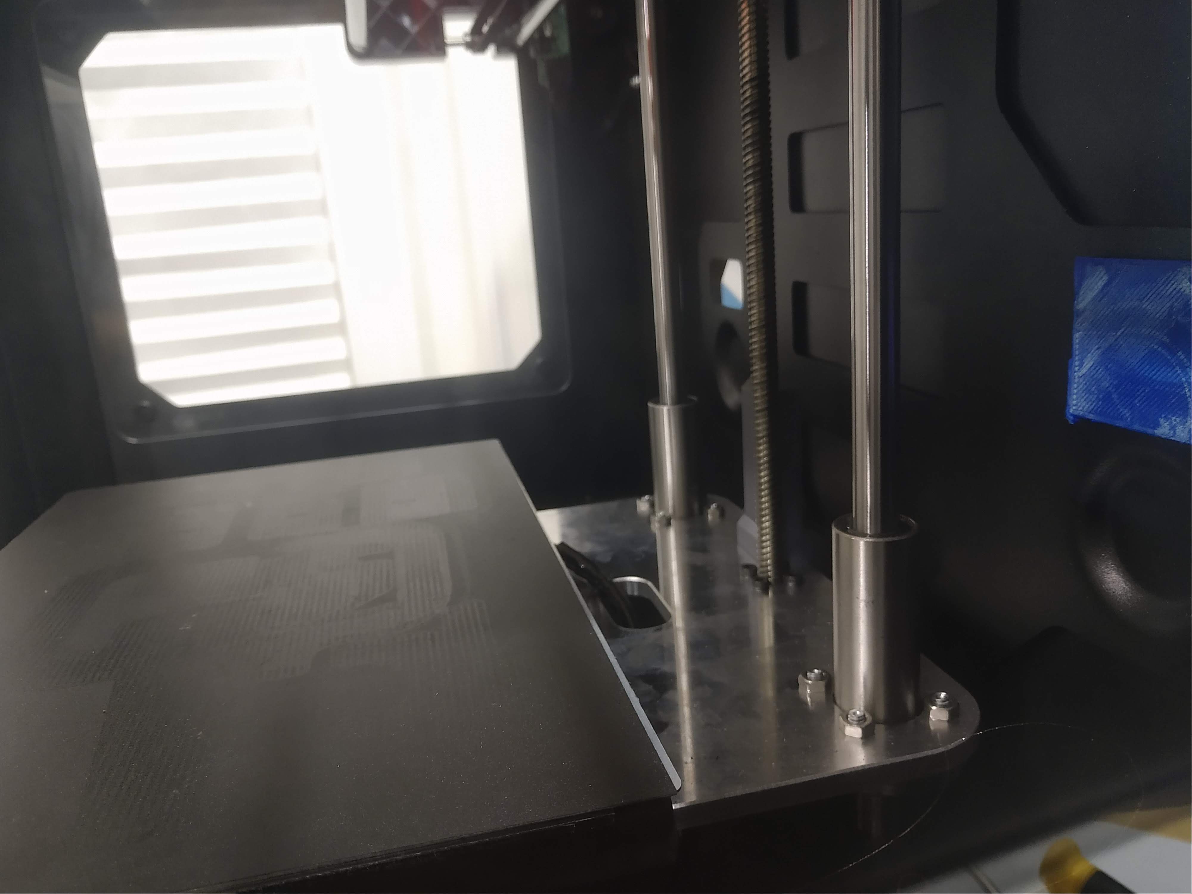

      I recently rebuilt my Replicator 2X, updating more than half of the unit. The only stock things still on the printer are the frame, carriage assembly and motors. I have replaced the linear bearings, removed the bronze ones and converted to Misumi ones. I replaced the entire Z assembly, keeping only the motor/leadscrew, switching it to an aluminum one by IDE. The Y idler pulley was replaced by an IDE aluminum one. I added magnets all around the top cover to keep it on the unit consistently. The PTFE tubes were replaced by Capricorn tubes. The extruder/hotend assembly was rebuilt using a Flexion setup, I had actually done that a couple of years ago. The heated bed itself is actually stock, but I added a Buildtak flexplate system to it. I removed the old MightyBoard and motor wirings, leaving the endstops and their wiring. The unit is now ran by a Duet 2 Wifi, and is way, way better than it ever was before. It is now Z homed using a BL Touch sensor, and has a touchscreen on the front. I followed the post here https://forum.duet3d.com/topic/1946/makerbot-replicator-2x-duetwifi-edition as the core of what I was doing with my machine, but made a number of tweaks and changes along the way.
      I am currently building a new coreXY printer based around the 6HC and 3HC boards, rebuilding my Replicator put me on the path to that, and I am having a ball!

              Nice conversion. It would appear to be a clone Duet sadly. Nice work all the same.
              • A Former User?
                A Former User
                You should really consider putting some ferrules or other therminals on all the high power and mains voltage wring not just the bed and heater outputs.
                also using yellow/green for positive DC wring is not great practice; this is widely recognized as protective earth colouring.
                • cdthomas9undefined
                  cdthomas9
                  It might be a clone, I got a bundle set online. I hadn't looked too close at the individual parts. The 6HC and 3HC boards I just got are legit though, and any other boards I get will be original as well.
                  I am actually going to swap out those wires for red/black with ferrules on it, I used what I had laying around during the initial build. On my to-do list for this machine. I finally got both extruders working, these crimp terminals can be a pain. Those wires were pulls from an ATX PSU cable bundle.
