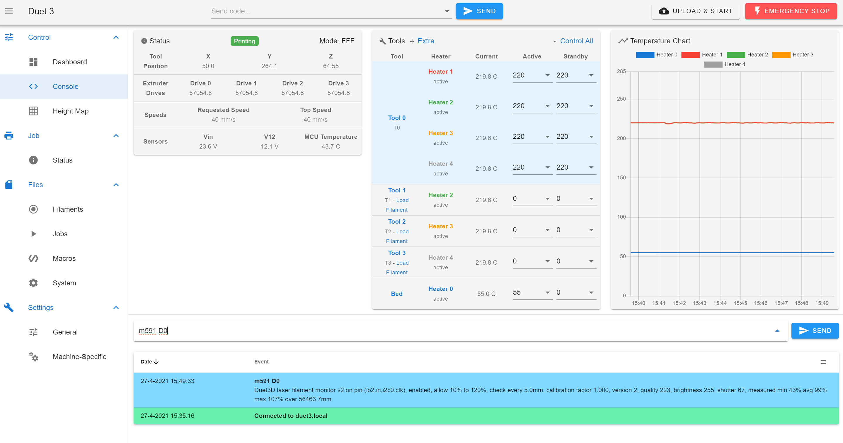

In the meantime I added laser filament sensor and these work with the latest firmware oke.
So I define these sensor with the command:
M591 D0 P5 C"io2.in" R10:120 E3.0 S1
M591 D1 P5 C"io7.in" R10:120 E3.0 S1 ; etc.now the trick how can I trigger the other three sensors because T0 only see sensor D0 and not D1 etc. and soon I activate D1 sensor the machine pause immediately caused by sensor D1.
What is a work around to have all sensors working with T0?Best regards, Jaap Vis

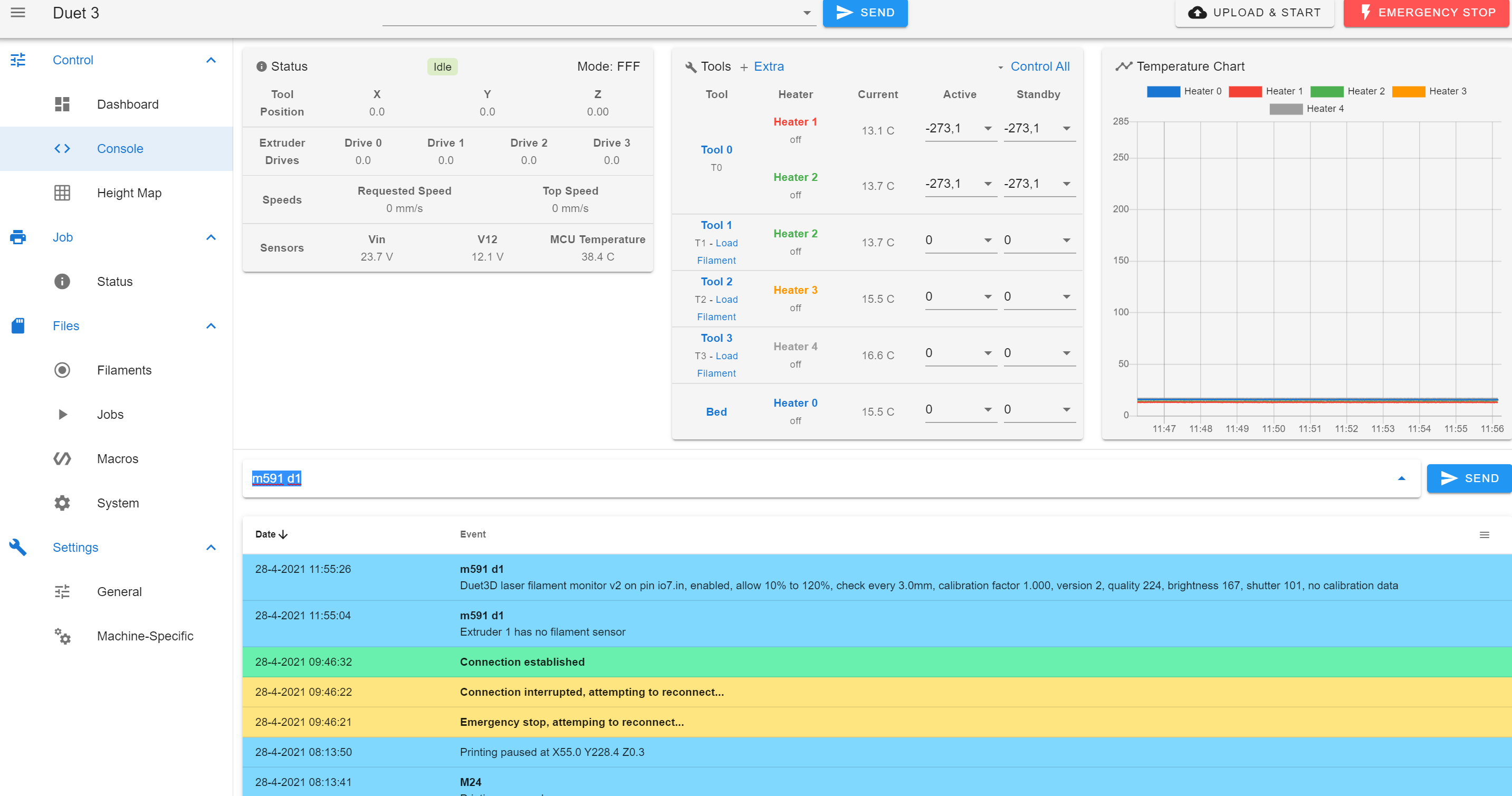

@jaapvis have you run M591 D1 without parameters, to check that communication with the sensor is working?
@dc42 Yes communication is working, see pictur.
