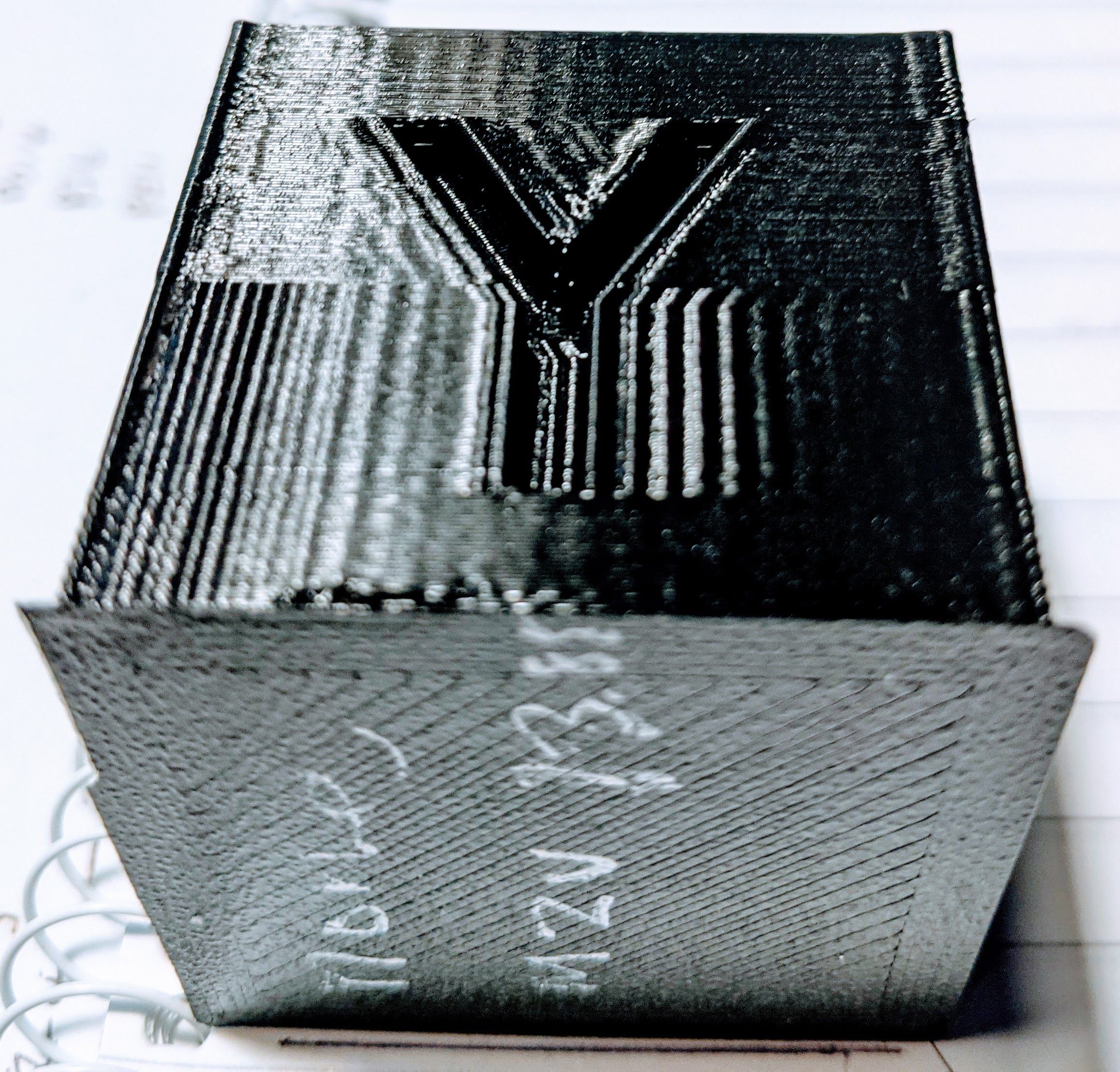

      After a little bit of playing around with the recommended solution from the plug in, I gave up on that (it seems to select too low a frequency of around 11Hz) and added a selection of my own based on a frequency of 13.85Hz. After a few runs I chose the MZV shaper as the first to test. This produced the following test cube:
      To make it easier to see the results the bottom half has no shaper enabled, while the top half has the shaper turned on (in this case MZV with a frequency of 13.85). As you can see this has a pretty dramatic effect on the result, removing a lot of the ringing. However if you look closely you will see there is still ringing in the "V" of the "Y". More on this later.

      My understanding is that the input shaper basically injects a series of impulses into the movement of the print head by varying the speed and acceleration of the print head as it moves. These impulses are added during the acceleration and deceleration phases of the move and are based on the target frequency. The different shapers use different numbers and timing of the impulses (in this case MZV adds 4 pulses, while ZVDD adds 6). The process of adding these impulses requires that the move is long enough (both actual distance and timing) to contain the series of impulses and also impacts the effective acceleration of the move (by basically extending the acceleration and deceleration phases of the move). For lower frequencies the impact of this operation is greater.
      I think the above understanding allows us to explain both the increase in print time (due to the effective lower acceleration being used) and the ringing that can still be seen in the "V" of the "Y" and to the left of the "Y" top (in this case the moves are not long enough and so are not subject to input shaping). The extra ringing seen in the ZVDD example is there because it uses a more complex shaper that injects extra impulses and so requires a "longer" move.

        @gloomyandy with ringing as bad as that, it's worth trying lower damping factors than the default 0.1. When selecting the higher order shapers such as EI3 and ZVDD, it may even be best to set the damping factor to zero.
        The reason for the increased print time is that input shaping can only be applied when the time taken to accelerate or decelerate is long enough. Therefore, when the acceleration or deceleration time is too is short, RRF will reduce the acceleration or deceleration as needed. The M593 L parameter lets you set the minimum acceptable acceleration, allowing you to choose not to apply input shaping when the amount of speed change is small.
