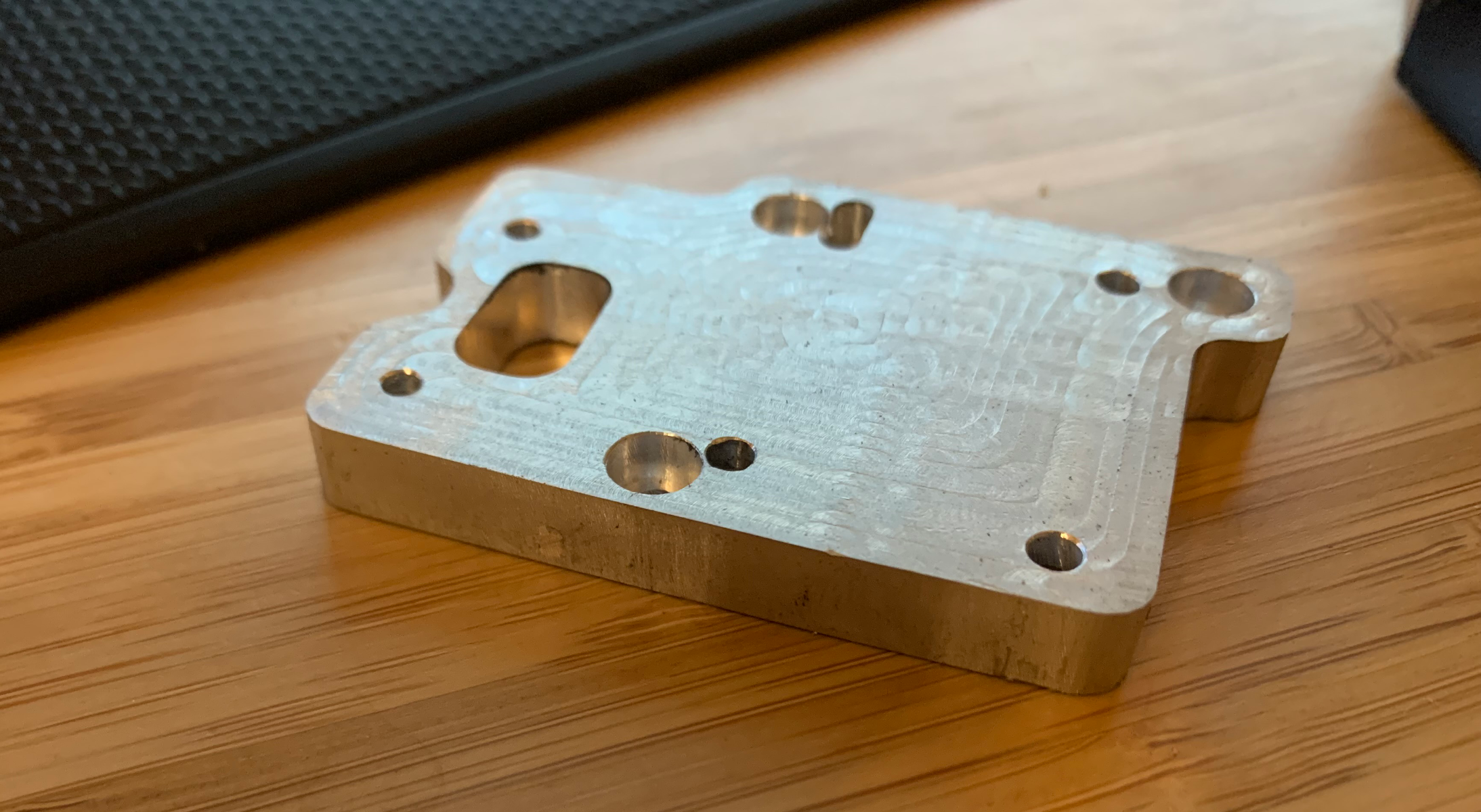

      Mount:
      Extruder:
      As mentioned before, I believe the factory extruder was the cause for many of my woes. Had I known what I know now, I possibly could have ID’d the problem (but why would I have bought a nearly $6,000 printer in the first place if I had my current knowledge set). I fiddled with the extruder to find that removing one of the springs would allow it to feed decently. I used it in that configuration for maybe 70 hours with consistent problems, most pointing to extrusion/retraction. I most recently machined a new mounting plate to allow me to use a Bondtech/Mosquito combo for a direct drive system, trading some X travel and weight in return.
