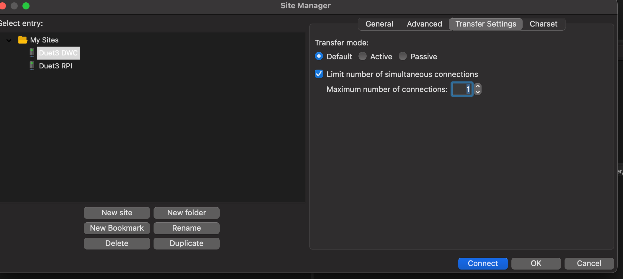

    I have been having issues connecting to my Duet3 MB6HC via FTP in SBC mode.
    I have been using FTP with these boards in standalone mode for a while and haven't been having issues. I have one machine using SBC mode and that is where I am running into issues.
    Info:
    • RRF 3.4.5
    • DuetPi image on RPI
    • Ran updates on the board a couple days ago
    • SBC mode
    • Networking section of the config and the error message from FileZilla below
    What I am using/trying:
    • FileZilla (on Mac, tried using a FileZilla Windows client as well)
    • Tried using the direct IP address, and duet3.local as the host
    • Using the anonymous login
    • Also tried using ftp, anonymous as the user name and set a defined password using M551 in the config
    • Limit number of simultaneous connections set to 1
    I can't log into the server at all. I am getting these error messages:
    Here are the FileZilla Settings:
    Here is the networking section of my config file:
    Let me know if I can add any more detail.

        @Falcounet I tried using SFTP, using the pi admin account, and it worked. I am not sure why I am not able to access via FTP but at least I can access via the SBC.
        For other people's reference as an alternate to FTP to access the board's files, the file directory structure to access the Duets "sd" folder contents from the Raspberry Pi is: /opt/dsf/sd/
        undefined 1 Reply Last reply 2 Jan 2023, 16:28 Reply Quote 0
        • undefined
          chrishamm administrators @Garth_42
          @Garth_42 It looks like you are using wrong credentials. Like with SCP/SFTP you must use user pi with password raspberry (unless you changed it already). I tried it on my setup after running M586 P1 S1 and it worked without problems here.

            @chrishamm ahh... I see. This makes sense. I assumed the FTP server in standalone was extant in SBC mode, too, and now I see my error there. I tested this as well and it is working on my board.
