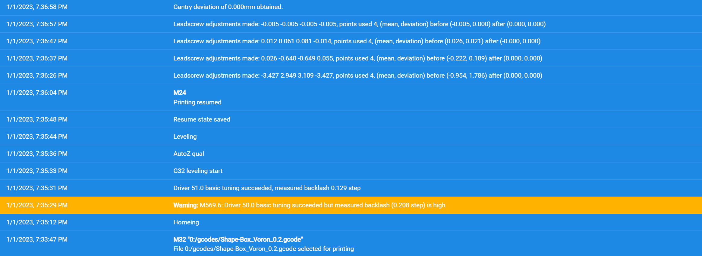

      Continuing the theme of print start errors. Even with the new release with fixes in the + firmware I am still having issues with print starts. All of this code is pretty much unmodified from 3.4.x and worked well.
      The details, Voron2.4 6HC+3HC+1HCL(x2)+1LC+SBC. On Print start the order of subroutines is not being respected. Similar to issues surrounding G32 with the other posts. I am assuming this might be a SBC issues if the + firmware fixed the problem for others, but that is just pure conjecture at this point.
      It is not solely based around G32 in my case. I have replaced the G32 with a G28 in the start code from my slicer and the same thing happens.
      So what's the problem; the system is hanging around the autoz.g and bed.g programs. The console on DWC is reporting the "abort" command that can occur in autoz.g slightly before the echo command in bed.g (echo "G32 leveling start"). This occurs while the machining is still processing code in bed.g.
      The system then hangs after completing everything in bed.g. No errors reported.

        Additional info:
        Here is a screen shot showing an echo command present in autoz.g appearing before the G32 commands were completed.
        Also here is an M122 report while the machine is hanging.

          dc42 administrators @Alex.cr
          @Alex-cr thanks for your report. Are you able to run in standalone mode temporarily, to see if these issues still occur?
          Alex.crundefined 1 Reply Last reply Reply Quote 0
          • chrishammundefined
            chrishamm administrators @Alex.cr
            @Alex-cr There seems to be an issue in SBC mode with M0/M1/M2 if it comes from File(2) aka print job. I am working on a fix.
            Edit: It's fixed but it will require a new RRF build and possibly a new DSF build, so probably 3.5-b2.

              Alex.cr @dc42
              @dc42 Standalone is really difficult for me as I have to have Wi-Fi with my machine at this time. I will see if I can figure something out.
              @chrishamm Thanks for the support. Glad a fix is on the way.
              Thanks both of you (and the rest of the Duet team) for your hard work. Awesome product. Any idea when b2 will be released?
