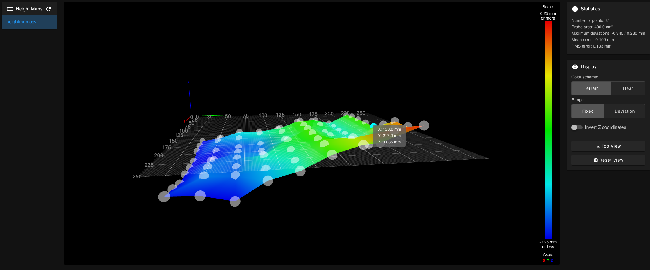

      I think my heightmap doesn't look that good. I would like to optimize it. Can you help me with this and take a look at my data/files?
      Which data should I upload?
      Thanks

        @jensus11 what kind of machine is it? You have M669 K1 in config, so a CoreXY. Moving bed, or moving gantry? It looks like the Z axis is driven from a single motor at the moment, or is it two motors on the same driver? Does it have bed levelling screws?
        • jensus11undefined
          jensus11
          The bed can be adjusted with screws and Z has a stepper. Leveling via a 4 point macro, which doesn't work when I check it with paper. The 2 screws in the front are ok, only at the back both screws are too far away from the nozzle. If I manually level the heightmap comes from above.
          4 point macro
          M140 S70
          M190 S70
          M671 x43:214:214:43 y43:43:214:214 P0.7                             ; The location of the four bed securing screws
          ;M558 P0												            ; Uncomment this if you don't have a Z Probe
          G28 X Y Z                                                           ; Home Z
          G30 P0 X43  Y43 Z-99999 ; probe near an adjusting screw             ; Front left screw
          G30 P1 X214 Y43 Z-99999 ; probe near an adjusting screw             ; Front right screw
          G30 P2 X214 Y214 Z-99999 ; probe near an adjusting screw            ; Rear right screw
          G30 P3 X43  Y214 Z-99999 S4 ; probe near an adjusting screw         ; Rear left screw
