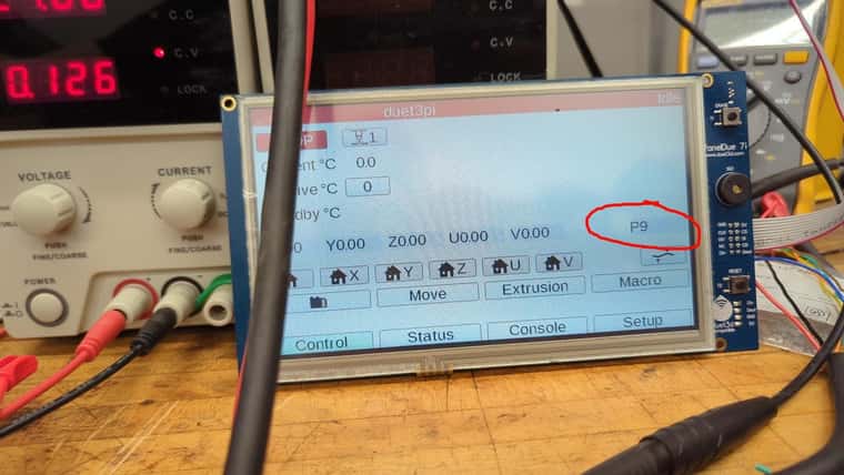

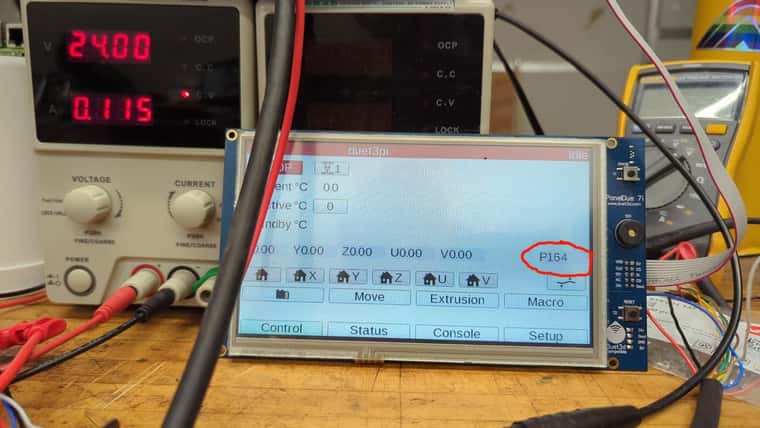

            I made some progress. If I set M558 P1 C"^io3.in" (EDIT: turns out the pull-up doesn't do anything here, it's the same if I leave it off) and watching the "P<value>" readout on the right side of the paneldue home screen I see the value change from P162 with no trigger to P9 when triggering the sensor with a piece of metal. I don't know how to read this value any other way (it's some kind of raw value I guess?), and this does not seem to be considered a probe trigger because M119 doesn't report a change to the Z probe status.
            I believe I should be calibrating it? But as I'm going to use these for endstops, not a zprobe, it's unclear which documentation path I should be taking in M558.1 and M558.2. Or if this is even the right approach.
            I feel like it should be possible to read this value directly in M574 but I can't get that to work since it's not a "switch".

                dc42 administrators @lei2vaegh6
                @lei2vaegh6 I suspect that your sensor a has high output leakage current, which is limiting the output voltage to 0.5V when it should be at least 3V. You can fix this in either of the following ways:
                1. Keep your current connections but add an external pullup resistor between the IO_IN pin and the 5V pin of the port you are using on the Duet. I suggest a resistor value of 1K to 2.2K.
                2. As you are using a 6XD board, you have 4 input ports (IO5 thru IO8) that provide alternative isolated inputs designed for connecting to 24V PLCs etc. See https://docs.duet3d.com/Duet3D_hardware/Duet_3_family/Duet_3_Mainboard_6XD_Hardware_Overview#opto-isolated-inputs. For example, you could connect the sensor output to IO5_ISO_NEG and connect IO5_ISO_POS to +24V. Then change your configuration to use port "!io5.in".
