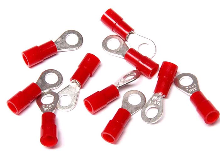

  • So my Duet Wifi and IR Probe came today, also my 2,5mm² Silicone Cables (tinned) that I ordered on Amazon.
    Now a new question came up: how can I use these small ferrules? They seem to be to small for 2.5mm² or 14AWG wire.
    I expected them like this: https://d17kynu4zpq5hy.cloudfront.net/igi/duet3d/L52TqyHbtBsOSTXi.large
    As I'll use the extra Mosfet for the Heatbed and will use cable lugs like these: http://www.gsmimpex.in/images/electrical/Electrical%20Cable%20Lugs%20whole%20saler.jpg
    Can I Ignore the ferrules on the "Power In" (that will get <80W) and insert the cable directly into the terminals? Or shall I get bigger ferrules?
    Edit: I tried to insert the cable into the ferrule and its kinda success. About half to 2/3 of the cable-hairs get inside the metal tube of the ferrule, the others are blocked but encased of the plastic of the ferule - is this good enough?
  • administrators
    If the bed heater is being driven separately using a mosfet then the power input cables to the Duet are less critical. So half to 2/3 of the strands of a 2.5mm^2 cable should be plenty. I'll check the sizes of ferrules we supply for the VIN terminals.
