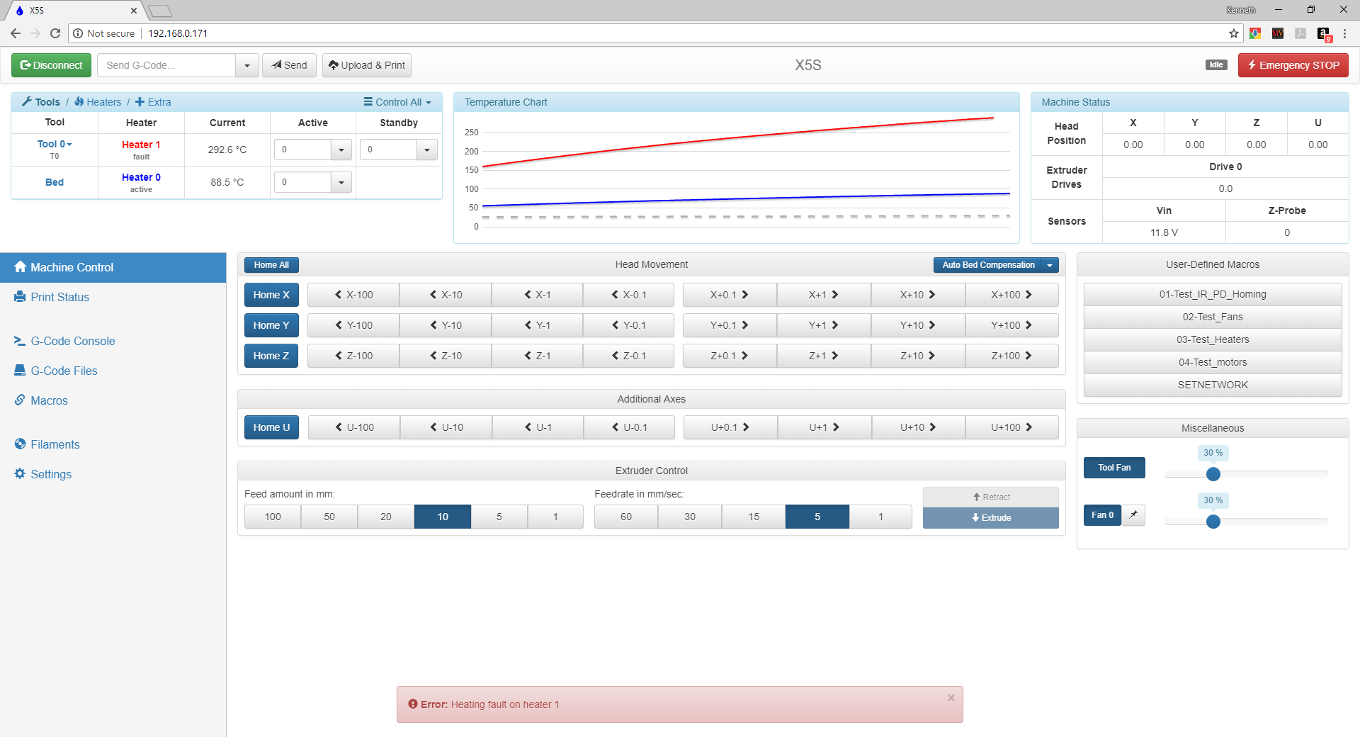

  • Hello all, I'm new to the Duet3D community. I was setting up my new Duet WiFi board today and everything was going great, my CoreXY printer was homing properly and my dual z axis were working together. Then on my last few reboots I saw that my heated components were coming on. I tried setting the active temperatures to zero, I tried rebooting a few times, even tried setting the temperatures with manual g-code. I will note that my heated bed is driven through a mosfet board.
    What can I do to stop it? I tried googling but I didn't see anything or anyone having my issues.

  • Including a screen shot of the web interface
  • @thebigkent Regarding the bed driven through MOSFET board: they can fail shorted so it the bed will be on all the time. Do you have a spare MOSFET board to check against? Also why don't you use the Duet's terminals? They are rated for 18A. Does your bed exceed this?

    The bed current isn't excessive but it's a 24V bed while the rest of my printer is running off of 12V. I'll try removing the mosfet board and seeing if that helps.
    Edit: Nope, the bed does heat much slower but I'm still uncontrollably heating.

    OK, in that case it would not make any sense to connect it directly to the Duet, I see. Still the MOSFET could have failed shorted. In this case also the MOSFET used on the Duet to control the bed that you again use to control your external MOSFET board could have shorted and therefore commanding your external MOSFET board to be on all the time.
    You could probably check this using a multimeter across Duet's bed terminals.
    1. If they show voltage although not explicitly heating then you most probably have a short on the board.
    2. If they don't and your bed still heats (did you touch the bed to check if it is actually hot and not your sensors are going haywire?) it probably is your external MOSFET board.

    No, my first clue was the LED lighting up on my heated bed indicating that it was heating. I did double check and things were getting hot. I've managed to get it working but it's not an ideal scenario, I switched the jumper from internal 5v+ to external and am powering the board via the USB plug. I'm well on my way to my first duet powered print.
  • administrators
    If all the heaters turn on when you use the internal 5V regulator but not when you use external 5V power, then your Duet is faulty. Please do not use it (even with external 5V power), instead ask for it to be replaced under warranty.
