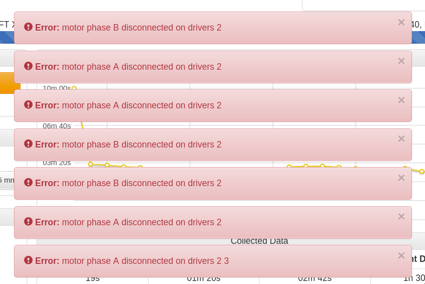

Duet Error?
I think driver 2 is the Z axis?
If so, I checked those wires, and they are good. It seems to be happening rare and randomly through prints now. But I am not sure if it is hurting the prints or not. Appears it reconnects after it has the issue. 1) because it can say disconnected the same thing multiple times, and still printer appears to working OK. Or at least the problems I am having right now appear to be with the extruder and or/config. -
Are you are using the 2.02RC1 firmware? I enabled open load warnings in this version, with a timer to try to suppress the false ones that the drivers report when the motors are moving very slowly. If the print worked, then the open load messages were probably spurious and it looks like the timer is insufficient to suppress those. So it looks like I need to either turn them off completely again, or find a better way of suppressing the false ones.
Yup

Error: Bad command: 2000When it popped up, the hotend appeared to move off the print.... and then go back to continue printing. I am not sure what is going on. As I am a Duet Noob, and just built this printer, I am not sure if it is me, the RC1, or something else.

As you are a Duet noob, it's probably better for you to use the stable 2.01 firmware instead of the 2.02 release candidate.
I was going to ask if I could do revert back and if it was compatible with the current web interface.
Yes you can, and RRF 2.01 is compatible with DWC 1.22.3.
Thank you!
I just got some of these. Everything looks good on the print, cannot spot any shift or layer problem. I guess driver 2 is Z, I have two motors in series.

If the printer is moving OK then those errors are spurious.
Thanks for the help and fast replies!
I rolled back the update last night and the errors are gone! I was thinking it was my Z steppers slipping but couldn't see it actualy happen, like ot recovered way to fast.
