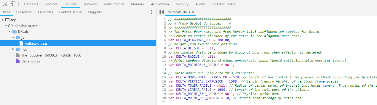

Using Chrome, load the sizer, right click (almost anywhere EXCEPT the printer graphics area) and select "inspect". Navigate to "sources" and "deltacalc_de.js". All the WHY is in the code... particularly the "positionXxxx" and "calcXxxxx" modules.
