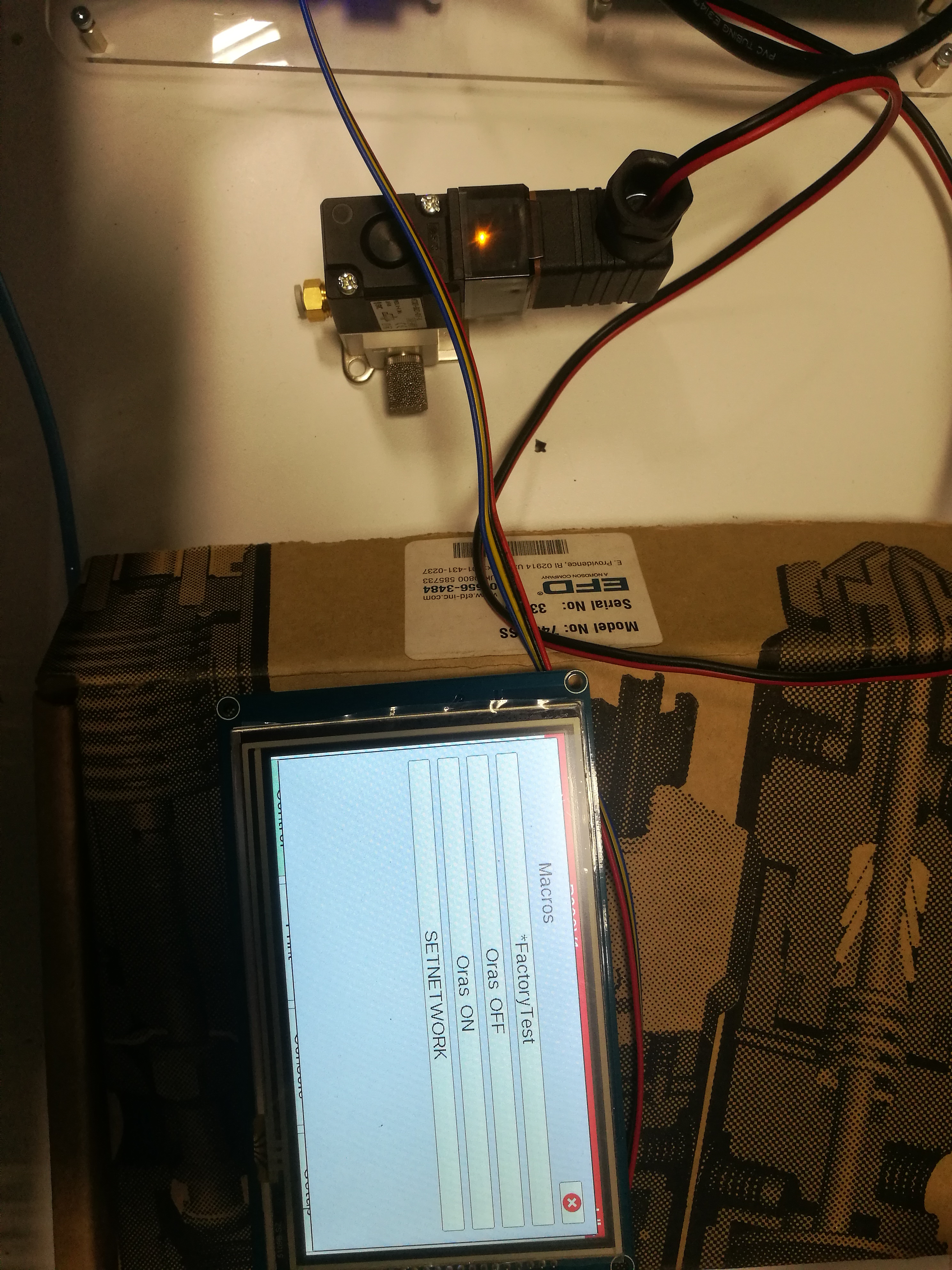

I want to use 12V fan output to control 24V 4.2W (166mA) solenoid.
I would use booster for 12V output to have 24V. It will become ~400mA.Am I allowed to do that?

I don't advise that, because the boost converter will have a high starting current, which might blow the mosfet. Can't you either use a 12V solenoid, or power the Duet from 24V?
@dc42 ok, going to buy 24V power supply. Will be less problems.....
So its is working
