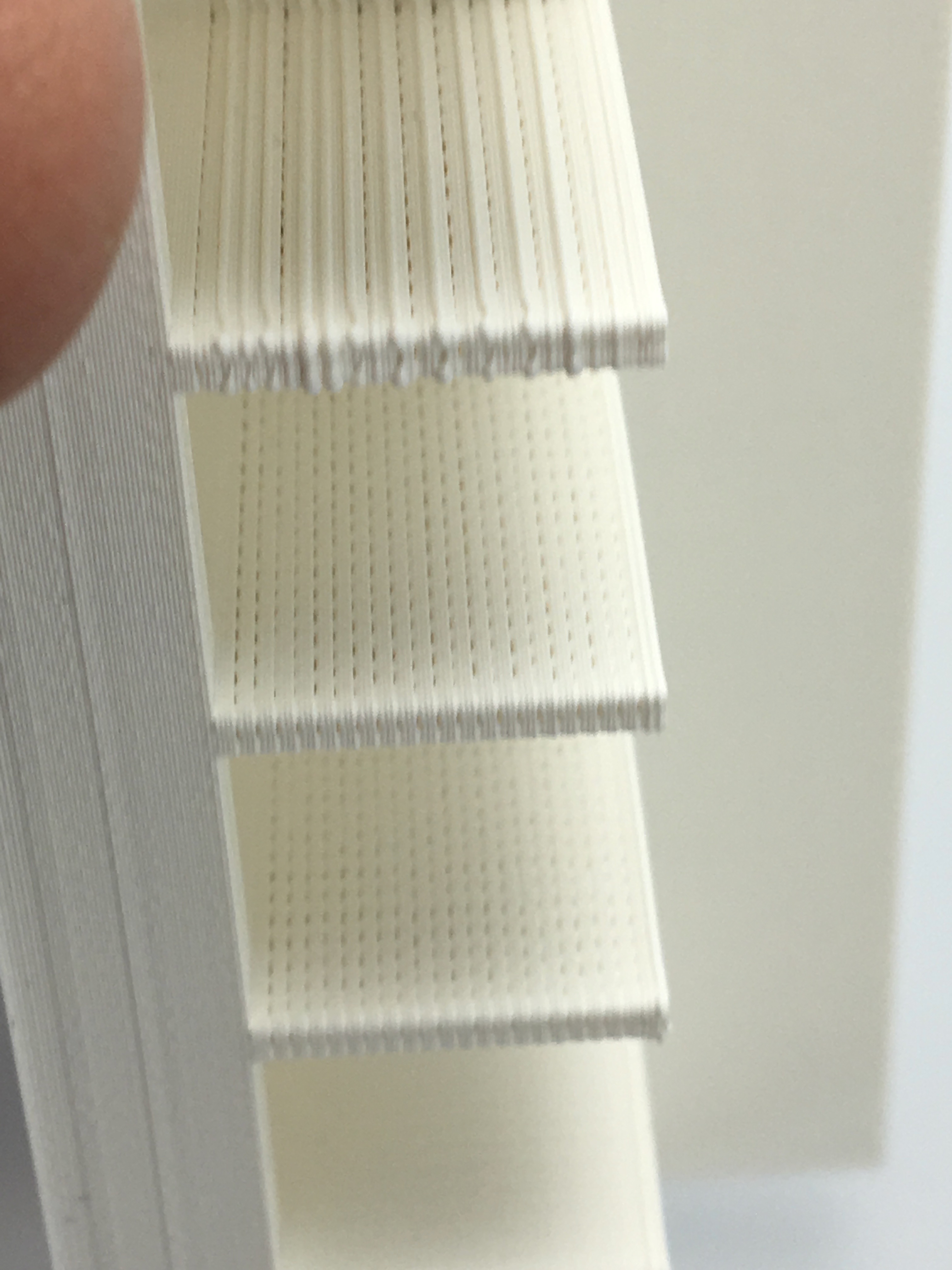

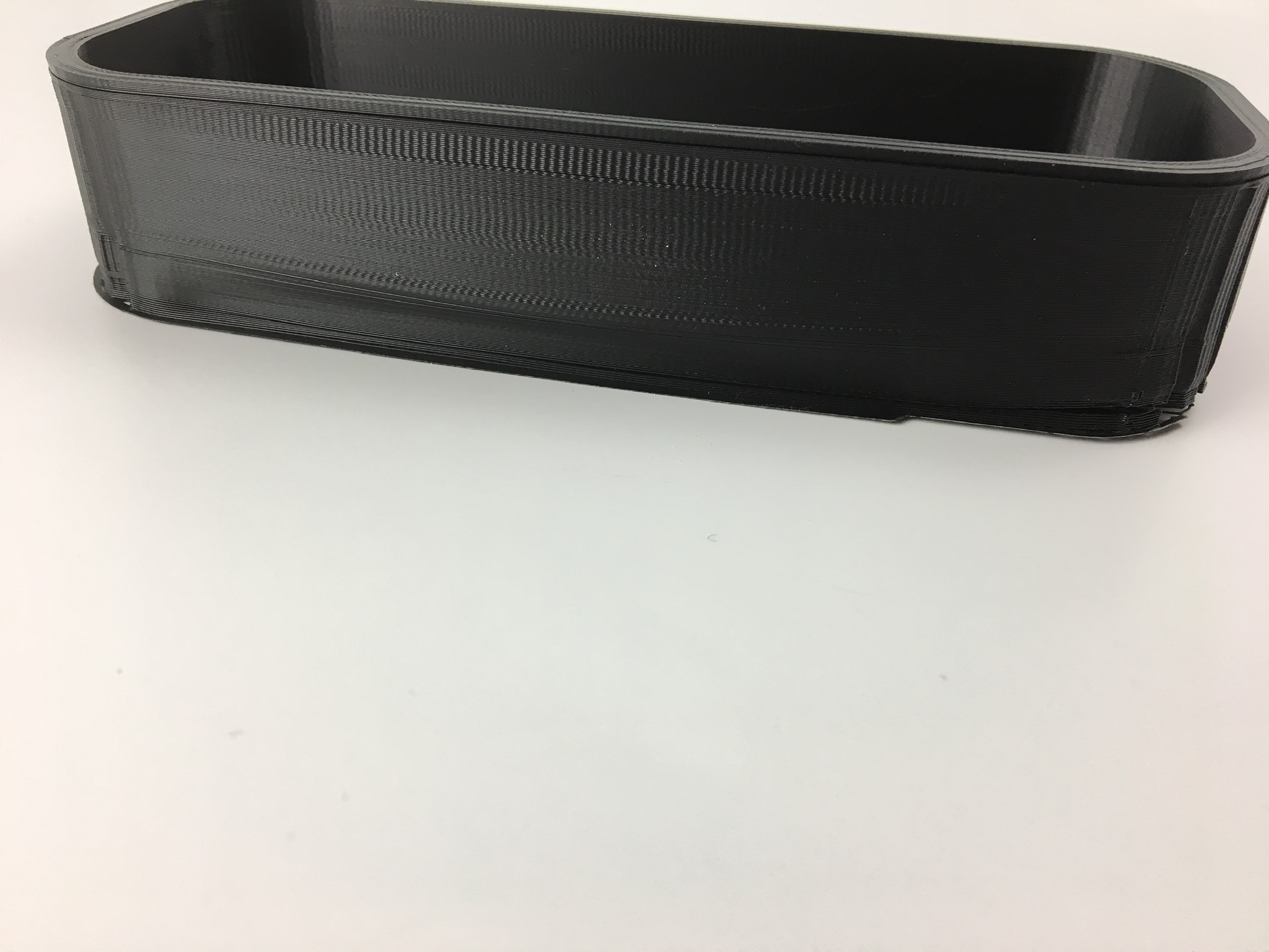

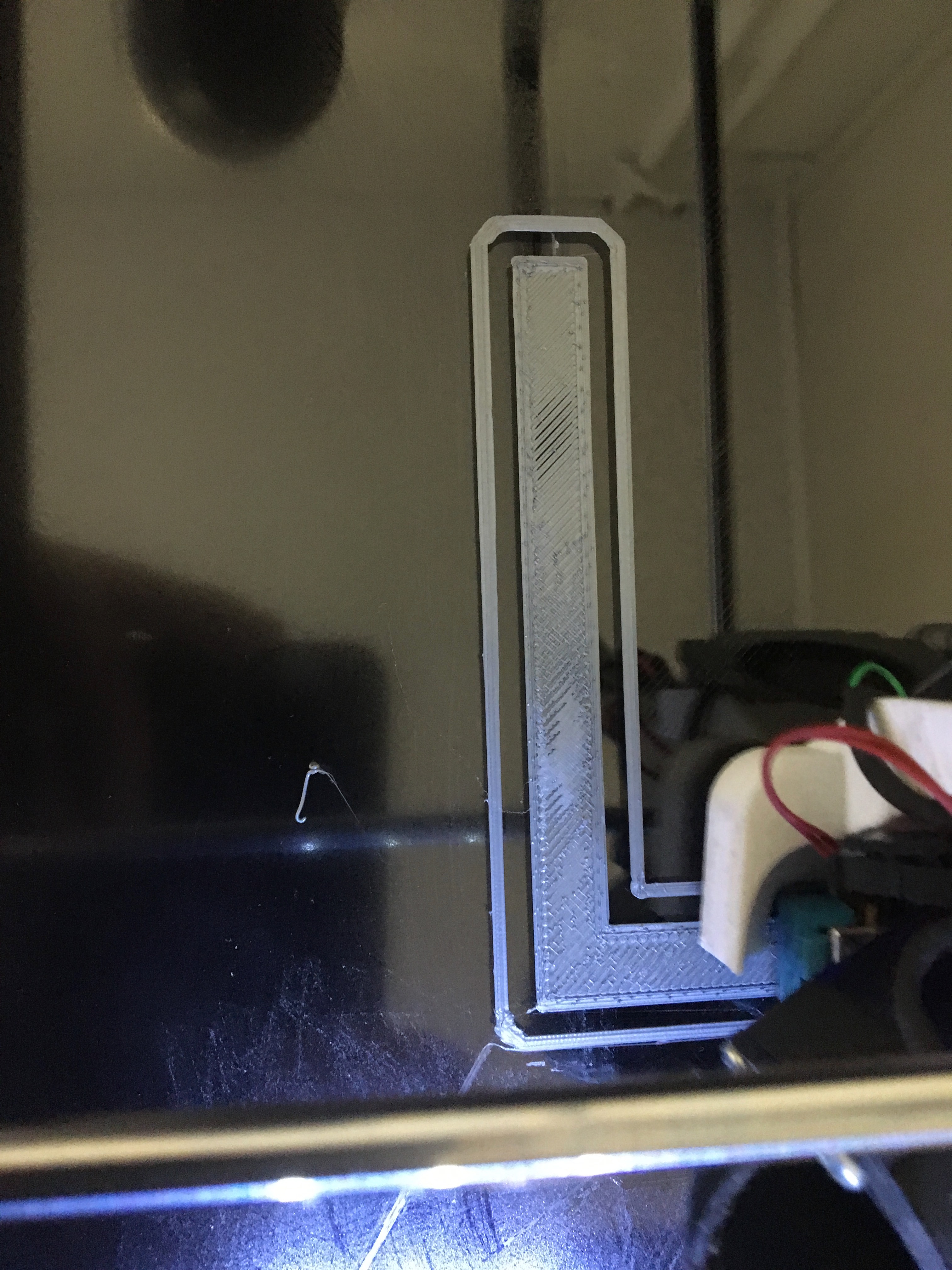

@sigxcpu said in Multiple issues with Duet Ethernet since 2 weeks:
To summarize the issues :
- X and Y wobbling when powered on / printing 24hours per day. Not when just powered on.
What do you mean by wobbling? You mean powered on with motors active, right? That can be a capacitor problem, indeed.
Aren't your problems Z related, only? At least this is what I've got from the posted pictures.X and Y axis were wobbling eg create a pattern like ringing but on long straight walls. Pitch is 0.9 mm approx.
Since I have powered off the printer on Monday, I am not able to reproduce it. I will have a new test today as the printer is powered on since yesterday morning.- First layers (approx 2 first millimeter) are much more than the resolution chosen. This increases with the time the printer is powered on. But sometimes the print is good. So the parts are well over the targeted dimensions (11,69mm then 12,56, then nearly 13,5mm for a 10mm section part)
This could be explained by a heating part, but your errors disappear on upper layers when electronics are hotter.
- After homing and bed probing, the printhead sometimes crashes in the printed when priming the hotend.
I can relate to that. One of my horizontal axes, I don't remember if X or Y, jumped to the edge before putting the first bead in center and printer resumed printing there. It happened 2 times, I don't know what was the problem.
Issues 2 and 3 are related as the Z move is having a wrong pitch from the driver
Try to move the Z axis motor to E1 and/or try a different power supply. I don't know how often Duet checks for the input voltage. I think that is a feature to see if your power supply takes the load (i.e heated bed).

@v3dprinting said in Multiple issues with Duet Ethernet since 2 weeks:
Definitely it’s linked with temperature, but not consistent. It seems that the print done yesterday evening is good from the webcam view. Need to check when arriving in the office.
The part done yesterday evening is better, but not good : the first millimeters shows the same pattern with bigger layers, but less than yesterday.
So the part is only 10,75 mm instead of 10mm.

Hi Dave,
XYZ motor current was chosen bet. 50 and 80 % of the max load of the steppers. XY are 1,8A and Z is 1,2A, 400 steps/rev
I only have one Z motor.
Remember that this machine had been running perfectly during nearly 1 year and half with these parameters.
I will try to reduce the Z acceleration, but I don't think it is the point, as the problem appears only in the first millimeters on Z axis.
And don't forget that I also have the wobbling pattern issue on X and Y too, even if I don't reproduce it at the moment.

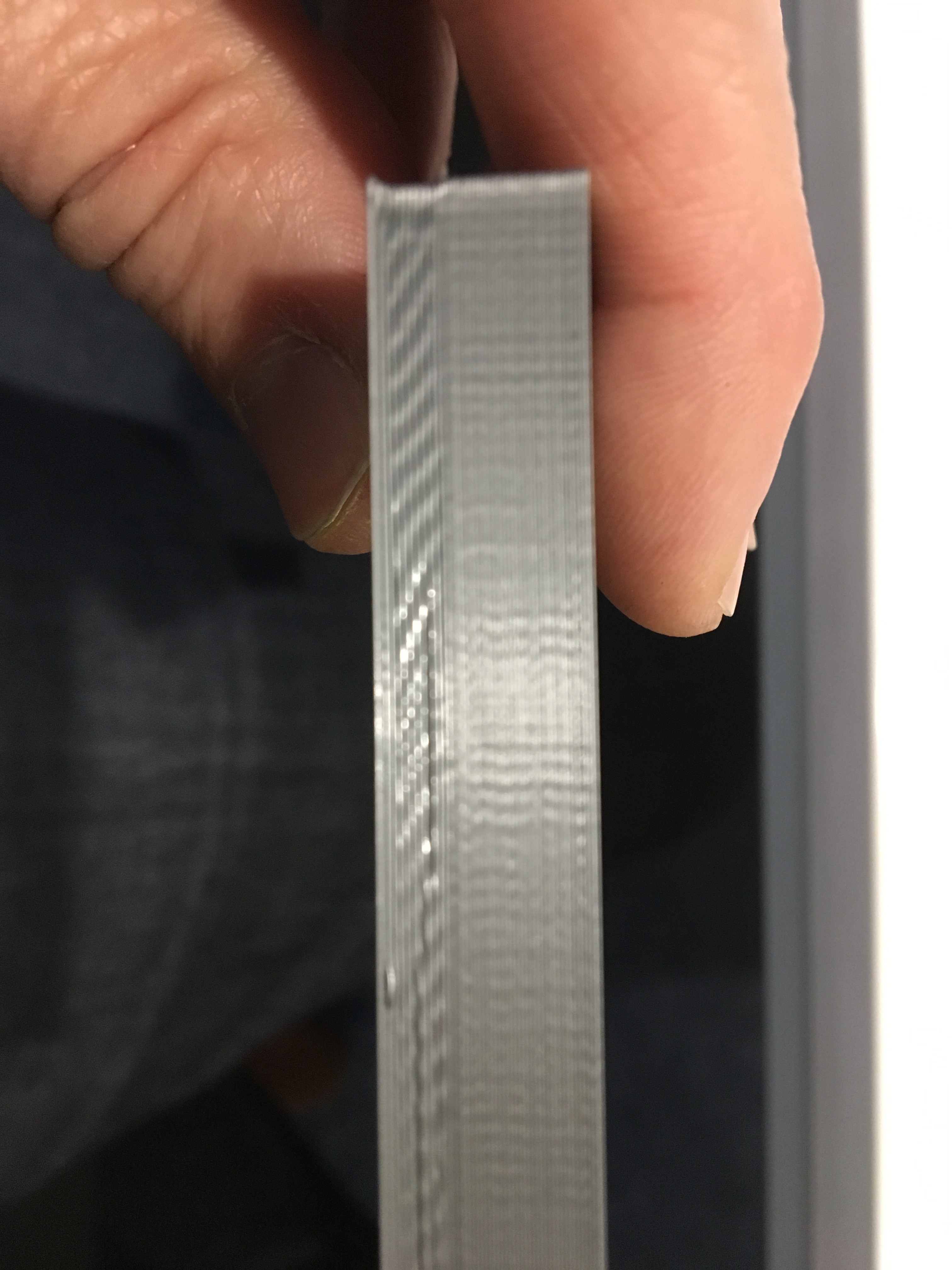

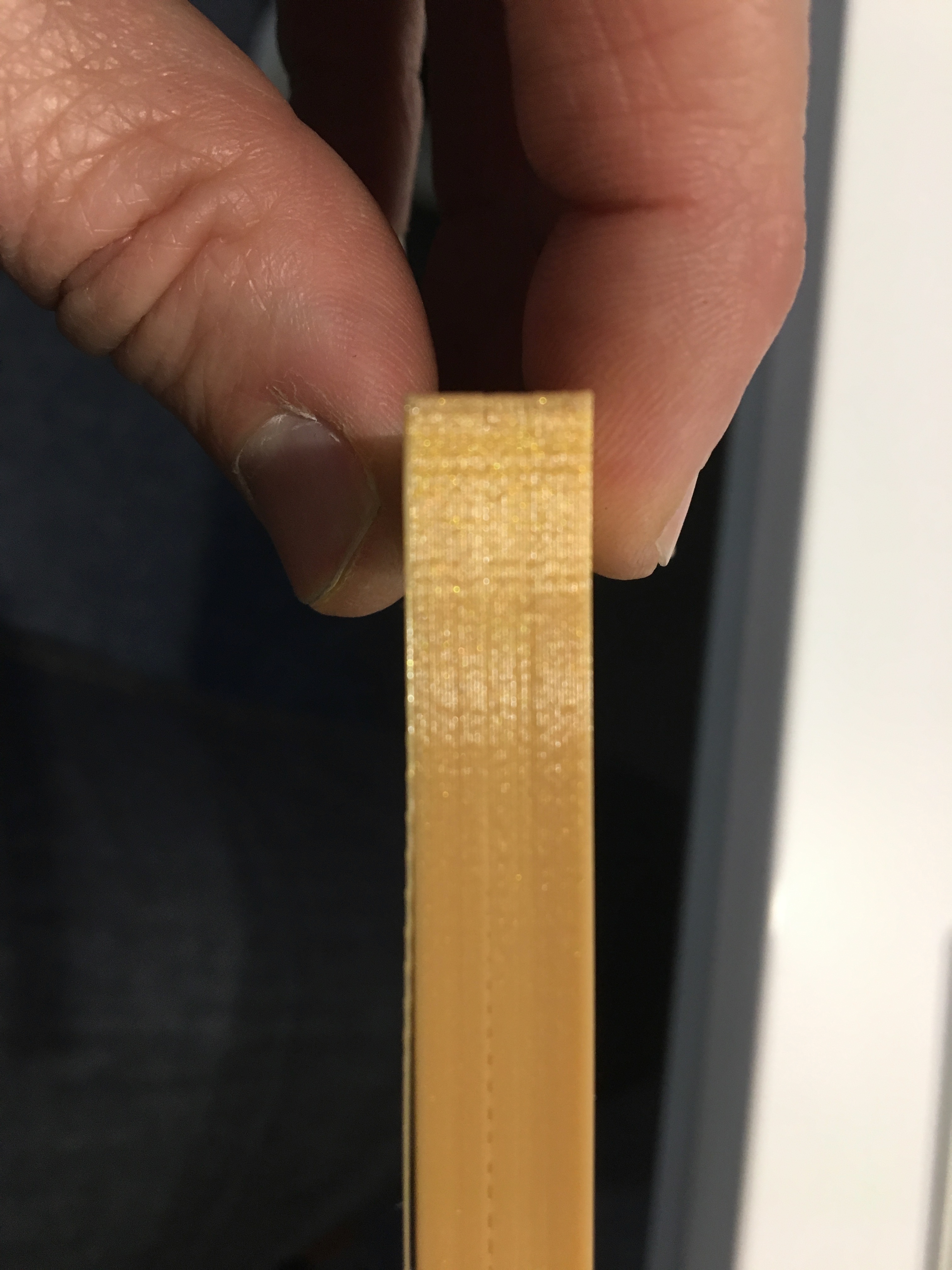

I have done another test print today with the same gcode as yesterday evening.
Same issues on Z, except the part is now 11,8 mm height instead of 10 mm.
First 4,8mm of the part are with layers well over 300 microns instead of 200 microns.
As it is the same gcode, the issue is definitely on the printer.
@v3dprinting I have an idea but it's a log shot. Before I say any more, do you use Z hop at all?
Very very scarcely. Only when the part is a bit tricky.
But most of the time, I need also dual extrusion, so I end to print them on my Ultimaker 3 and S5 -
I have changed the Z acceleration to 100
I have printed a new test print, still the square. But with another end of spool.
Still the same issue.This time the part was 10,8 mm height instead of 10mm

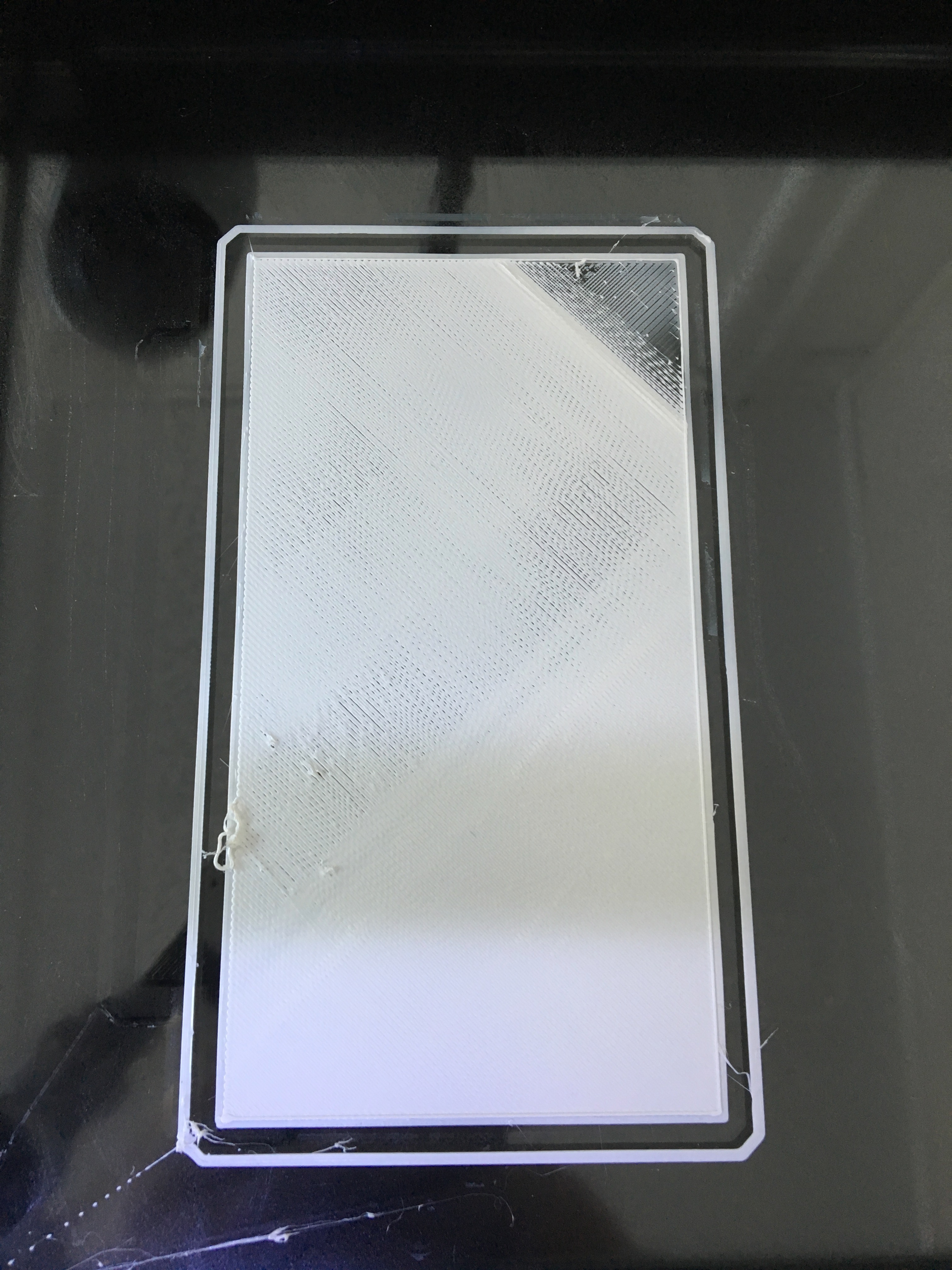

I have done a manual bed leveling, presuming the mesh bed leveling was having issues due to the fact that I'm using a 3 mm glass instead of 4 mm (broken the last one this weekend ). So an additional negative value to compensate again the homing position.
It hasn't changed anything and the first layers are still more than the 200 layer height defined.

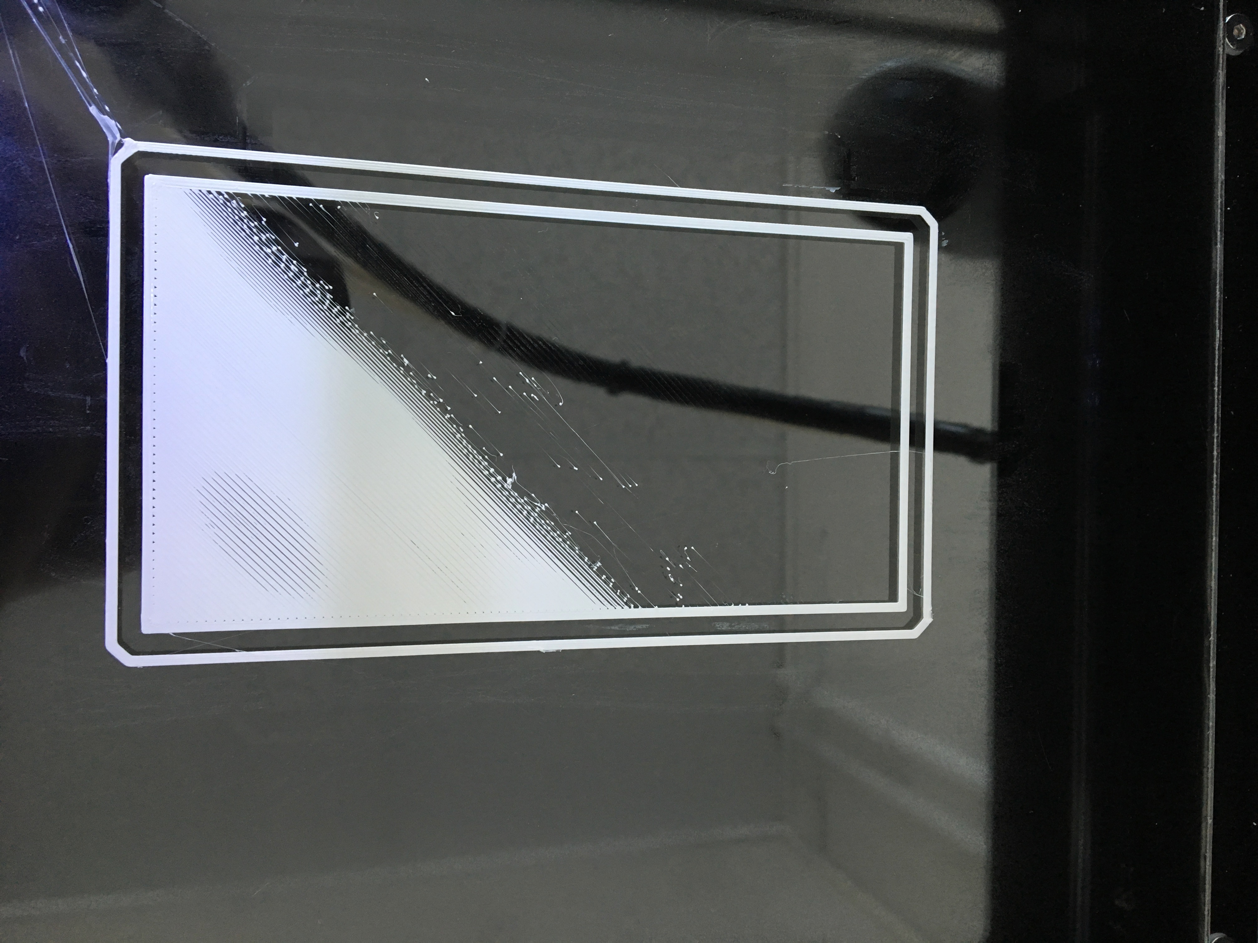

I am now printing the same pan as at the beginning of the thread, trying to reproduce the X and Y wobbling. But I print it in PLA.
I have printed yesterday evening the pan in PLA as said.
Print was failed, layer height was inconsistent :
First layers were too big (more than 300 microns) as in previous tests, instead of 150 microns
Then layers were too small or null, so I had a nozzle jam, filament grinding ...But the print ended without errors and the total height reported by the printer was good or so (I have a +0,5 mm Z end script) for a 32mm height model.
I have checked the gcode file and layer height is 150 microns

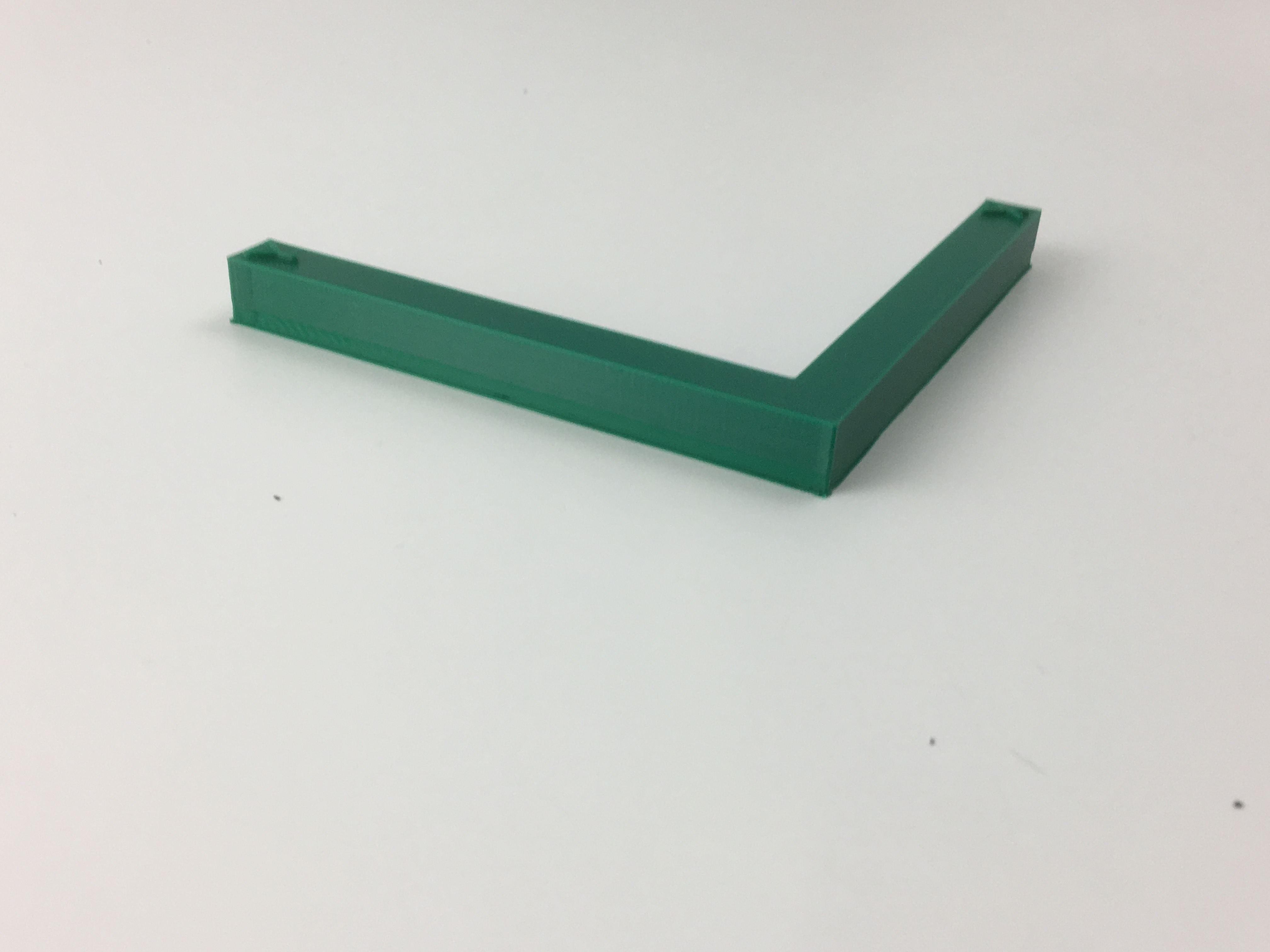

I have printed another square 100 * 100, 10*10 section.
The print is very good from a dimensional point of view : from the previous tests I should have expected issues on Y and having Z fine, but the result is the part is within the usual tolerances (+0, +0,2mm).The only issue is I have some wobbling on both X and Y axis. See pictures.
It might be of importance, but the printer had been swithed off since Dec 7th evening, and just powered up to load filament and start print.
So I confirm the issue is linked to the board.
