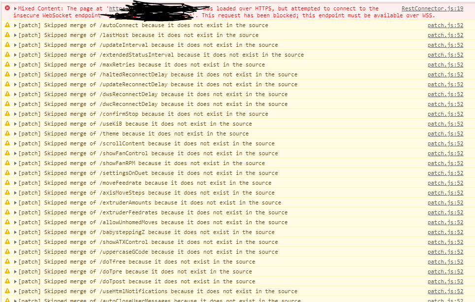

      For a while, I've been running a NGINX based reverse proxy to access my Duet. Since I upgraded to DWC 2.0.0-RC2 (which looks great fyi) my setup seems to have been broken 😞 . Below, I've included the relevant part of my config file. What has changed since the previous DWC/what am I doing wrong?

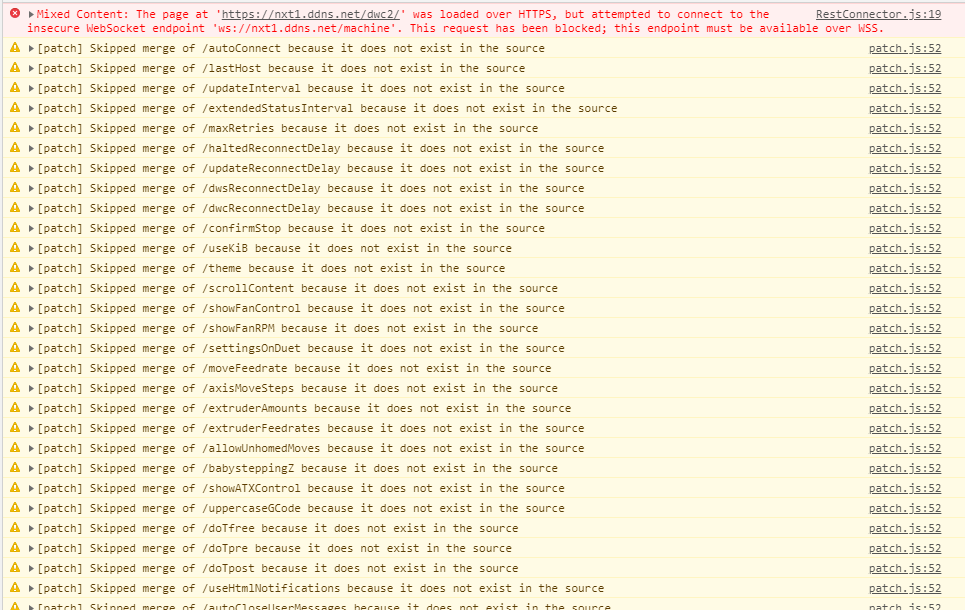

              @jacotheron There are two issues that I can see, hardcoded http and missing JS.
              0_1561910467467_32247e15-f577-4953-9586-ec52009227a0-image.png 0_1561910408772_c22a2765-c461-48cf-a9d3-32139bfcb263-image.png

                I have a reverse proxy setup to connect to my Duet from remote and it works flawlessly with DWC 2RC7. I remember there being an issue with reverse proxy in earlier release candidates and I don't remember which one actually fixed it but it works now.
                Though I have to say I only use HTTP (encryption is implemented over an SSH tunnel) and a subdomain in my specific setup:

                EDIT: Regarding HTTPS I just create a Pull Request that replaces the hard-coded http: by location.protocol as mentioned by @Jacotheron.
