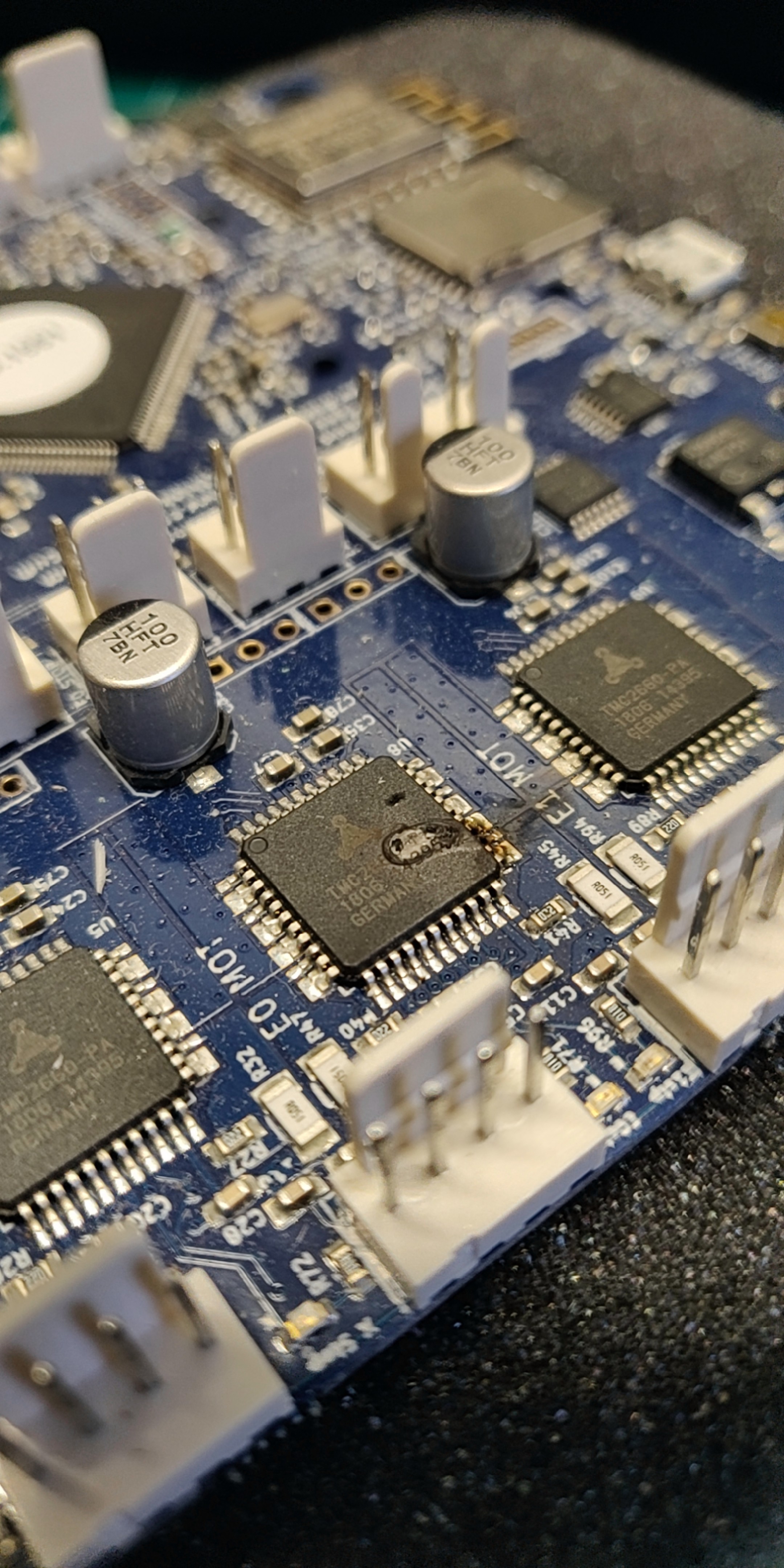

I have just had exactly the same failure mode. Duet Wifi, Firmware 2.02, board V1.03 from Filastruder.
I changed the E0 motor to a 0.9 degree E3D, literally an unplug ( while off ) and re-plug. Changed e-steps in config.g, and bang! E0 fails to ground. I since tried the motor and cable on an old MKS gen L and it works fine btw.
Measuring resistance across GND and motor outputs show a dead short, same to +VIN.
Other motors refuse to work, but otherwise all other functions are ok ( heaters, endstops, and IR sensor detection ).
This board was only soak tested on the machine I was modifying cycling X Y Z for 10 - 12 hours on Saturday after being in storage for since new ( March last year ).
Ideas ?

I tested the board from @peirof. The blown stepper driver was messing up the SPI control signals to the other drivers. When I removed the blown driver, the others worked.

David, I have desoldered the E0 ( drive 3 ) TMC 2660 now, and there are blown tracks underneath the chip.
I have made sure there are no shorts ( microscope ), but the firmware is still reporting :
Error: short-to-ground reported by driver(s) 3
Error: over temperature shutdown reported by driver(s) 3Is this expected when E0 driver chip not connected to SPI ? How do I get rid of the warnings / errors reported for this driver only ?
Otherwise X,Y,Z and E1 functionality has been restored.
Keith
A missing driver will be read as all status bits set, including over temperature warning, over temperature error, and short to ground. Until you fit a new driver, you can use the R-1 parameter of the M569 command for that driver to suppress them.
Thanks David. Board is too damaged (I think) to refit another driver.
I have got it all reinstalled with the config changes you proposed, and intend to use as a single extruder system.
I just need to set the config for heater1, thermocouple 1, extruder 2, and tool 0 so that I dont need to change gcode .
Keith
@tkward, you can stick with your existing connections and config, except connect the extruder motor to E1 instead of E0, and put this line in config.g early on before any M350 and M906 commands:
M584 X0 Y1 Z2 E4
