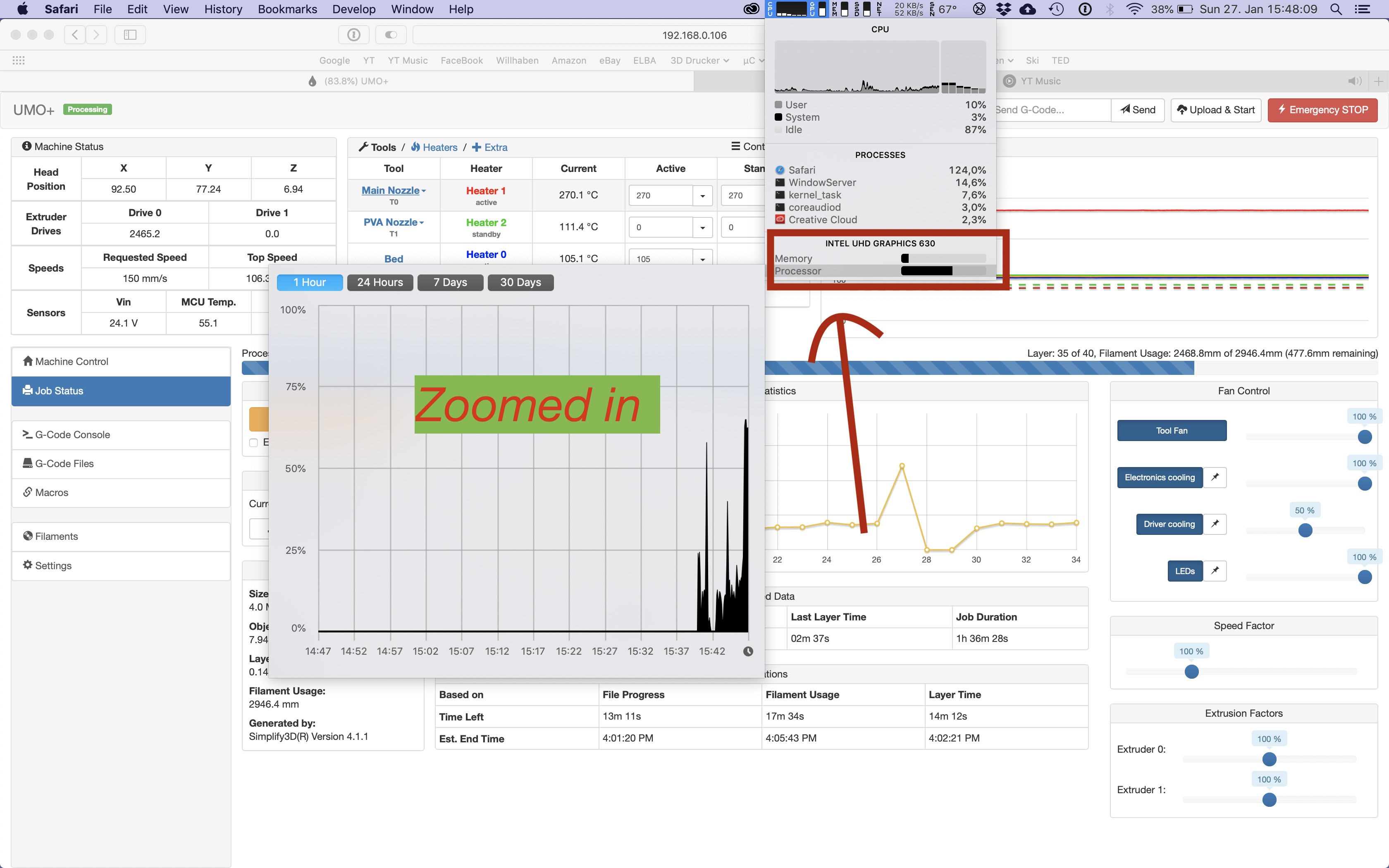

      Hi!
      Now I run:
      Firmware version 2.02(RTOS) (2018-12-24b1)
      WiFi server 1.22
      Web Interface 1.22.6
      Safari browser 12.0.3
      I also had this problem in the previous versions.
      If I zoom out (command and minus) once (that's how I like it more because then you cannot scroll anymore in the Job-status tab and overall the sliders are longer then), my GPU is at full load and everything is laggy. For example to click trough things takes about 2 seconds long.
      When I zoom in again, everything is fine.
      When I zoom out 2 steps, it is same laggy and the same full GPU load like zoomed out 1 step.
      Printing with an UMO+
      Duet 2 WiFi 1.04
        EDIT: actually "zoomed out" and "zoomed in" in the pictures should be the other way around.
