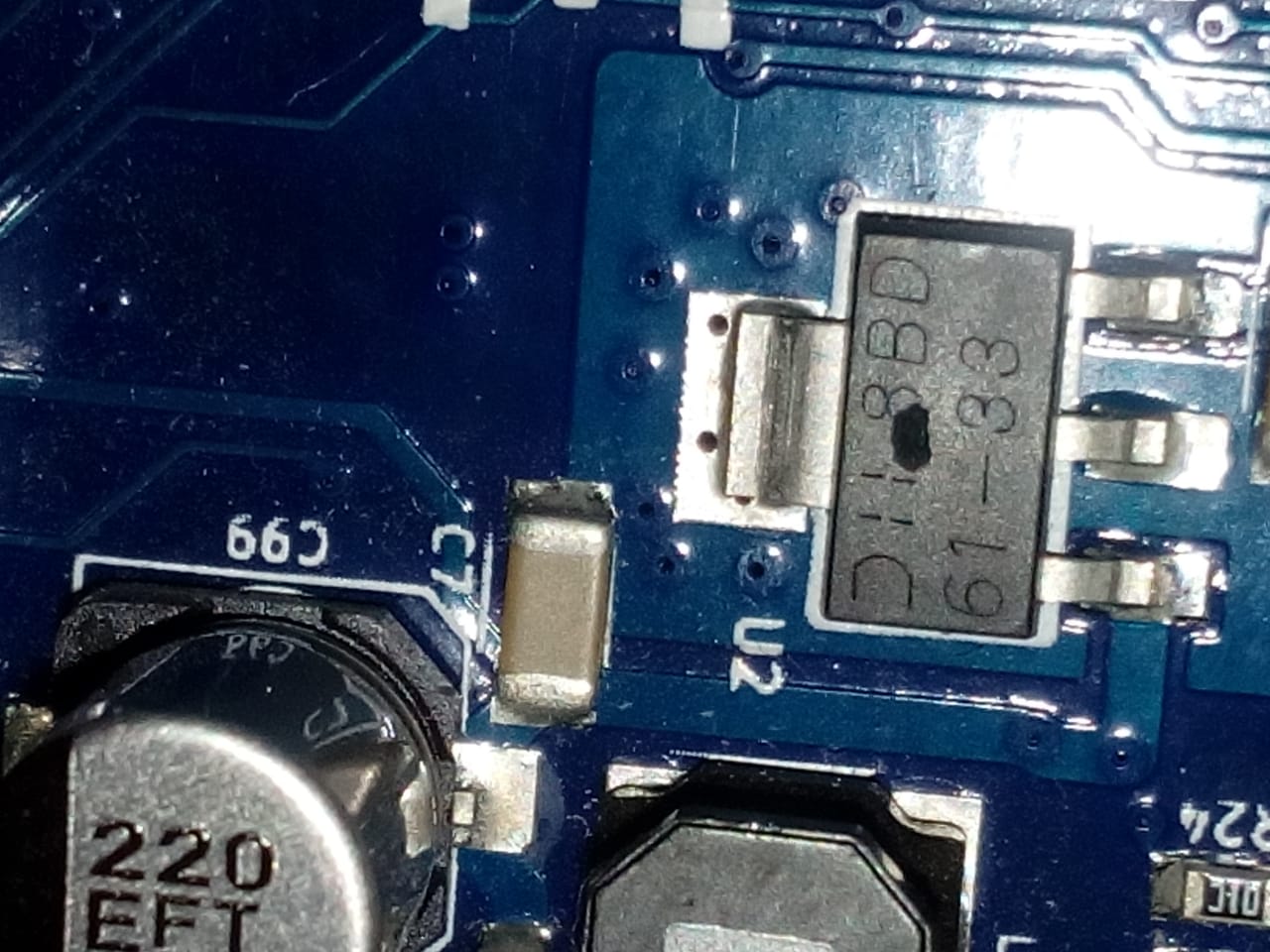

I have burned the IC U2
Hello, I was testing the duet wifi and I accidentally made a short with the tip of the multimeter and I think I burned the board. Apparently the IC U2 has been burned and I would like to know if it can be easily obtained or if it can be replaced by another more common reference.
Thank you in advantage
U2 can be replaced, however when it blows like that the reason is usually that you have shorted either +3.3V or +5V to +24V; and that is likely to have damaged other components too, especially if the short was to +3.3V.
You could remove U2 (you will need hot air rework equipment and a hotplate), then apply 3.3V between the +3.3V and ground pins on one of the endstop connectors. If that gets the USB port and WiFi working, and the main processor doesn't get hot, then it's likely that the board can be repaired. You could even try applying 3.3V without removing U2, but U2 may short it out.
The part number for U2 depends on the PCB revision. Looking at the photo, I think you have a 1.04 board. The part number for that is AP7361C-33E-13. Do not get the version with an extra R in the part number.

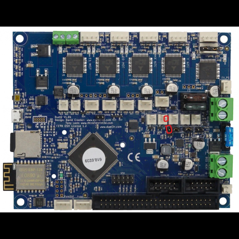

@dc42 hello, I've done everything you said and the Bossa port does not appear on my pc and strangely I just connect Vin, the Duet turns the hot bed out. I think the short was between these two terminals:
That would be a short between V_FAN (which you have set to VIN, so +12V or +24V) and +5V. That's blown the 3.3V regulator U2 and subjected multiple 3.3V components to excessive voltage. Sadly, the board is probably beyond economic repair.
