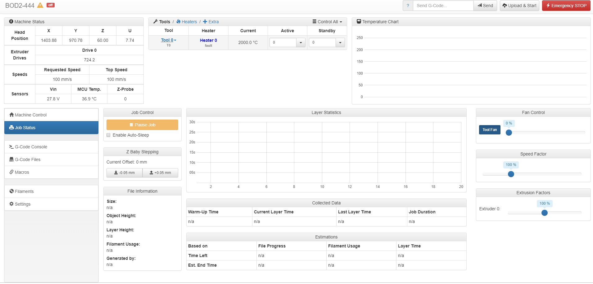

Pause button ghosted
My pause button in webcontrol stopped working - it's ghosted with a stop-sign courser when I hover it.
I updated webcontrol and firmware several times without error, but no change.I tried webcontrol 1.22.5 and 1.22.6, no change.
What should I look for?

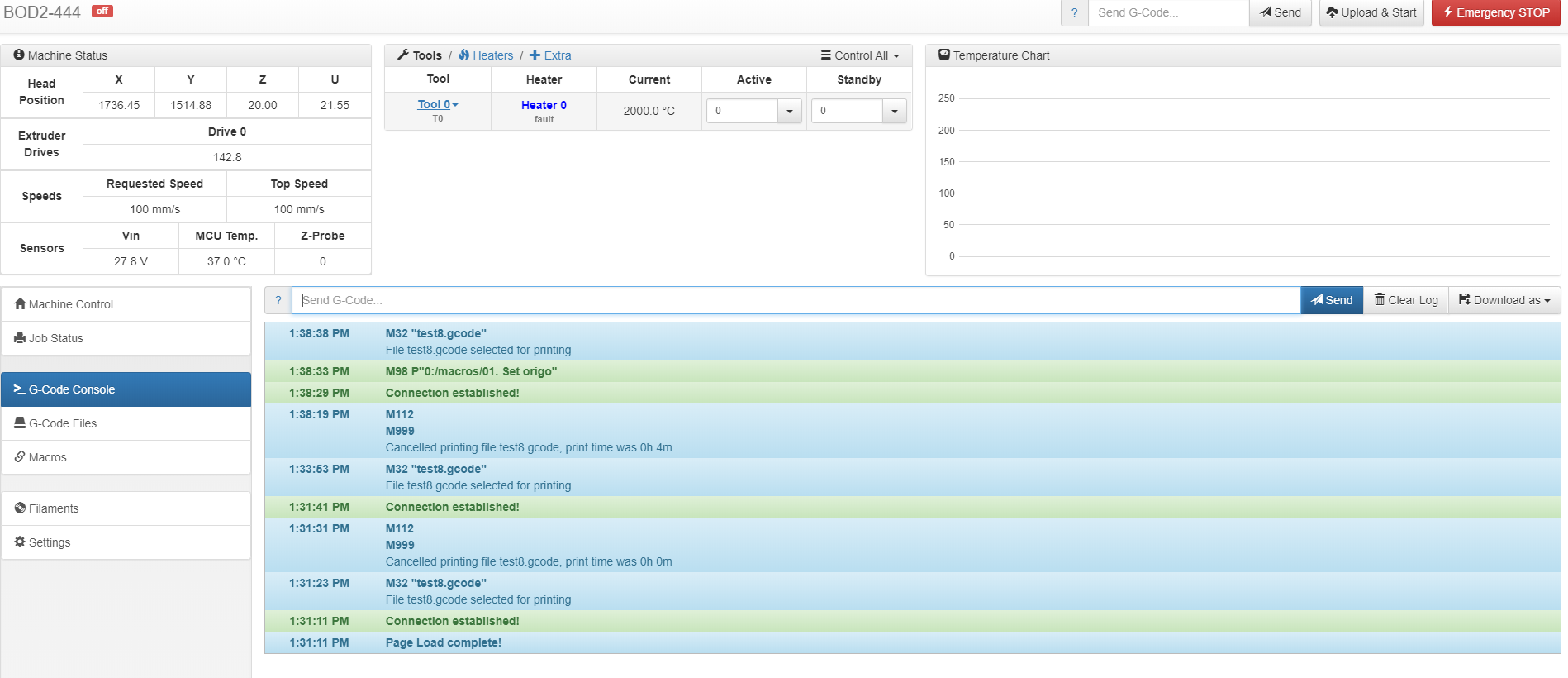

Hmmm, I replaced the SD card with a card from another machine and got the same problem...
Ideas?
With the new card, I am running the following firmware/DWC:
And the pause button is still ghosted. (and does not change to "print another" etc when a print completes or a pause with M25...

And I get the same problem with the Edge browser and Chrome and IE.
What does the status indicator in DWC say? The pause button will only be shown when the status is Printing.
Status bar (over the pause button) says something in line with "No job running" - while the printer is moving.
Could it be because I have bad temp readings and is running in "allow cold extrusion" mode?
Kulitorum
@dc42 this was with DWC 2.0, BTW - I'm back to 1.22.6 now and my status looks like this (while XYZ position is updating)
