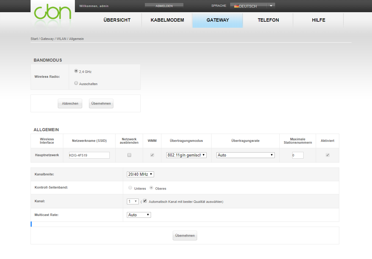

                                      NitroFreak
                                      Ok so it works again and i have updated to Wifiserver 1.23
                                      I just checked with the router and this is what i got.
                                      It says it is connected, but it is no witchcraft since the DWC works also at the moment.
                                      If i get another disconnect, i will check back if it says the same address, correct?
                                      • undefined
                                        It looks like it says dynamic rather than static. You may be able to tell the router to assign the same IP address every time.
                                        • undefined
                                          NitroFreak
                                          Ok so i´ve just had a disconnect, just around the time i was looking around in the router system.
                                          I checked in the router, and the 192.168.0.199 , so my printer, was still marked as connected.
                                          That disconnect settled itself after a restart though.
                                          So i tried switching off the duet, and check if it said it was still connected, which it did. It did not disapper for about 5-10 minutes after i had shut the duet down. When i restarted the duet, it was right back there.
