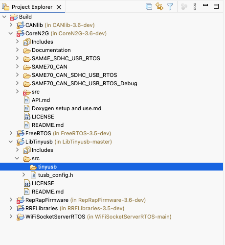

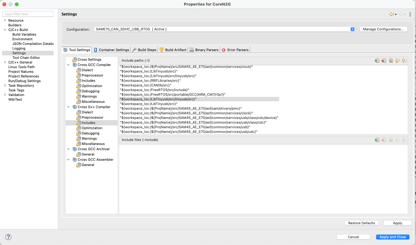

      @dc42 I checked the settings and they are the same as you show in your settings:
      But what I realised is that I don't have a LibTinyusb/src/tinyusb/src folder (only LibTinyusb/src/tinyusb):
      Could this be the problem?

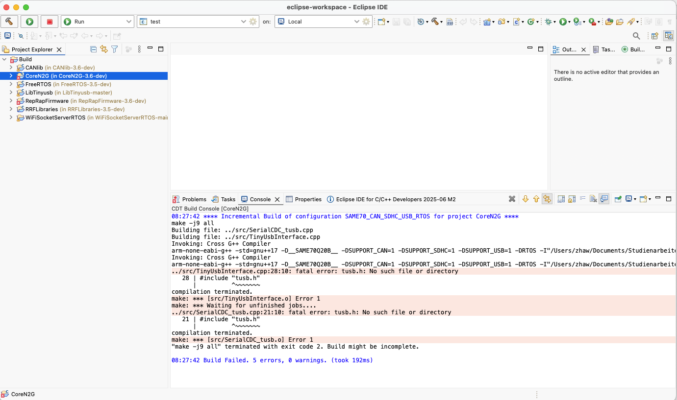

      Ok. That helped. Now I am moving forward. Compiling for Duet2 now works. When I want to complie for Duet3_MB6HC with the required board configurations, I get for the CoreN2G the following errors:
      So, there seems something else missing. How to fix this?
      posted in Firmware developers
