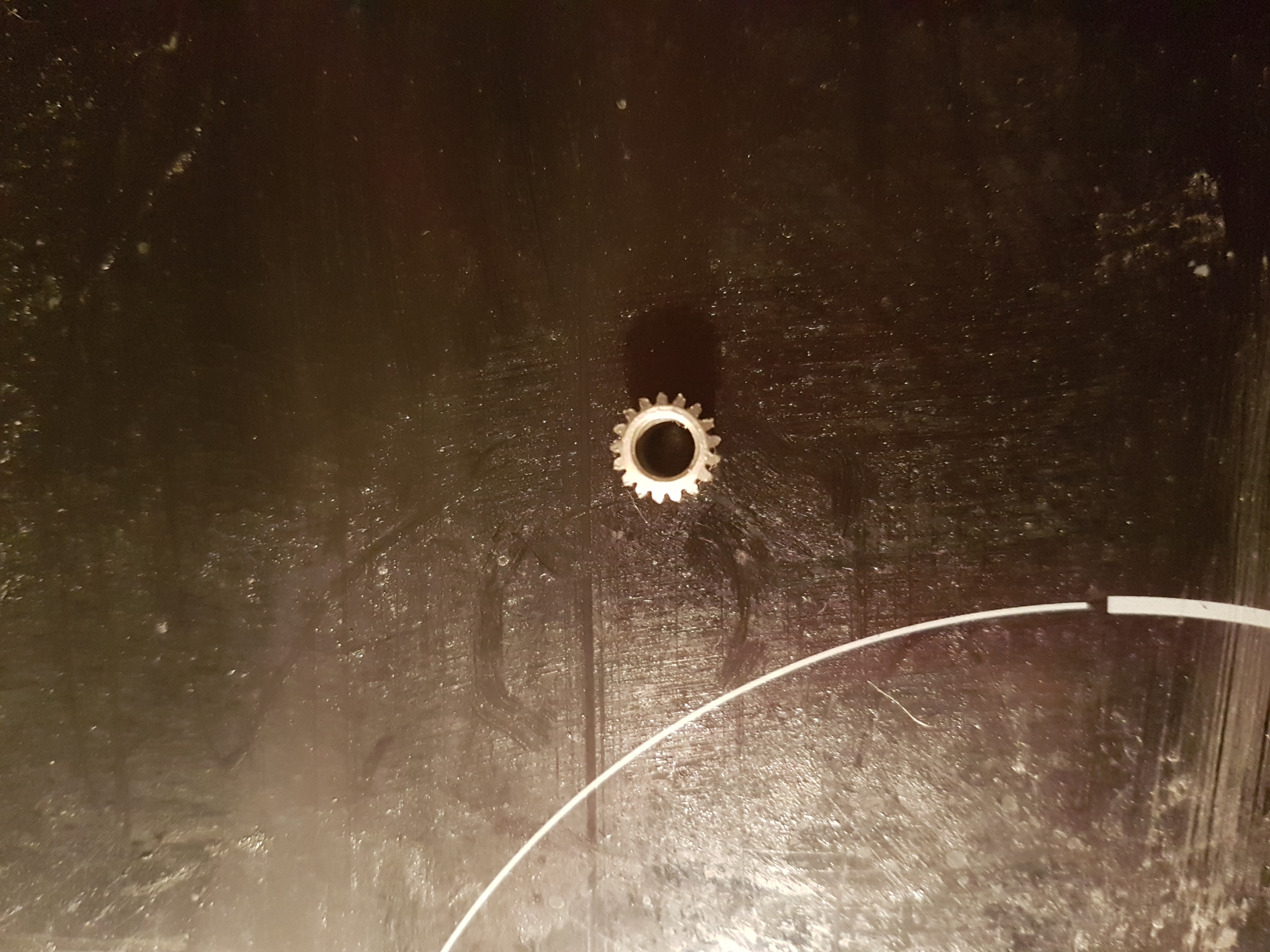

Im having huge layer inconsistensies... im used to the smooth and even layer lines as on the backside..
But its very uneven in the layers.. this happens on all prints, with 98% of my pla... this seems to become more prominent the higher i go in temperature..I have been messing with this retraction stuff for days, but when k got dialed kn retraction, layers started to go bad... hoped this PA could fix it...
This is batch 2...
Cube 1
Batch 1 is ranging from 0.1 to 0.3..
Batch 2 is made with higher values, ranging from 0.6 to 0.8, so i expect that to be worse....
but the difference in both of them are crazy.. same gcode and everything just different values..
these are printed diagonally on the bed, with about 150mm spacing between, just to see how retraction performs on long travel retracts.. so dont mind the small blobs from that... can be removed by poking to themAnd i dont know what to adjust, i wont adjust settings without any thought, cause suddenly everything goes haywire and i have to start all over from scratch and waste several kg of filament for everything

Edit. I was typing all the above waffle before I saw your pictures. PA isn't going to fix that. Disable it for now until you get everything else dialled. I'd say in general that because of the gas between layers and lines, you have some under extrusion issues.

See my pics, specially with the top and bottom, since i cant get the perfectly evenly look you mention, which i would LOVE to have..
But my main focus were the layer lines though...
But if the top is supposed to be better, i have absolutely no idea what is going on.. since the walls go completely bad above the 0.3 margin... -

I think you should take a step back and try not to change too many things. As I said before, pressure advance isn't the answer. You need to get everything else dialed in first. Print nice and slow. What speed are you using? What layer height? If you print slow (say 40mm/sec), then you are unlikely to get a pressure build up so you are unlikely to need to compensate for it. Likewise retraction. It's only applied at the end of moves to prevent blobs forming due to the filament oozing during non-print moves. It won't have any effect on the gaps you are seeing.
Have you done all the basic stuff? Have you got your steps per calibrated - especially the extruder. Have got the correct values for your thermistor? Have you tuned the heater?
@johnjohn1990 I can't keep up with all your posts. I don't know what question I'm trying to answer. Disable PA for now - it;s most likely masking something more fundamental which is what you need to fix first.
