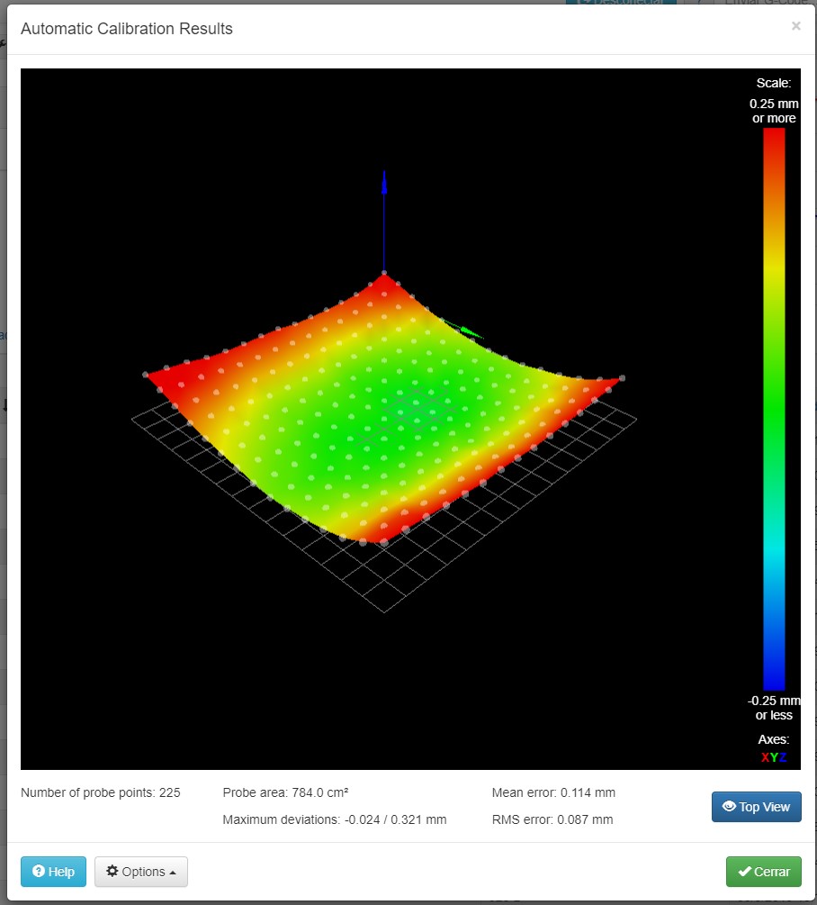

              • Veti
                Veti last edited by
                your mesh looks like a sagging x axis. Maybe increase the sturdyness.
                • juanmena
                  juanmena last edited by
                  It is the bed that is so folded, but it is assumed that the mesh, should solve the printing problems

                              • Veti
                                Veti last edited by
                                ok from your description i though the mesh bed leveling was not applied.
                                if after the bed leveling the nozzle does not touch the bed in some areas, that could be due to other factors.
                                wrong probe offset.
                                carriage tilt
                                structural problems (which from the mesh bed leveling image it does really look like you have sagging of the x carriage)
                                can you rotate your bed by 90 degrees. to verify it is really your bed?
                                juanmena 1 Reply Last reply Reply Quote 0
                                • juanmena
                                  juanmena @Veti last edited by
                                  @veti I have turned the bed, and indeed, the bed is bent. You can see that it has the same curve in the other direction.
