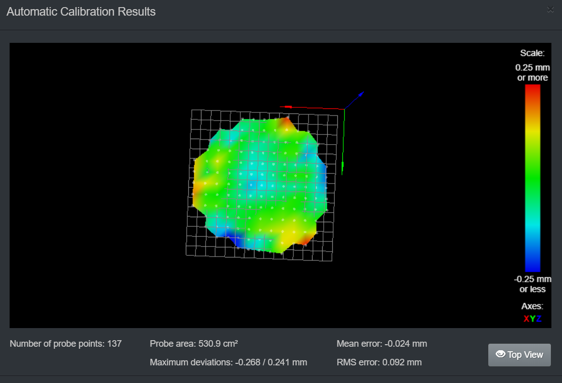

Thats mesh bed compensation - which is useful if your bed is not flat, but should be used after delta calibration has arrived at the best possible calibration for your printer.So (for now) ignore the bed mesh and confirm that the delta calibration is as good as it can be: In the console send:
G29 S2
That will remove the mesh compensation height map. Then G32, that will probe the bed in accordance with the points in bed.g - please use 6 factor for this at this point.
You will get a result in the console saying what (if any) improvement there is in how the 6 factor calibration has converged. Run G32 a number more times (say 5?) and see if those figures get better. Let use know how you get on. Make sure you save (M500, assuming you are using config-override.g) the final set of calibration numbers.

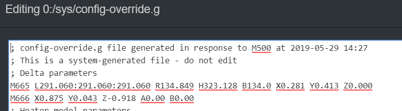

here is what the log said: 6 factor original steps per mm and original arm length.
this was the final override
M665 L291.500:291.500:291.500 R135.003 H323.062 B134.0 X0.285 Y0.293 Z0.000
M666 X0.941 Y0.019 Z-0.960 A0.00 B0.00please let me know how to proceed
G32
Calibrated 6 factors using 16 points, deviation before 0.117 after 0.115G32
Calibrated 6 factors using 16 points, deviation before 0.120 after 0.119G32
Calibrated 6 factors using 16 points, deviation before 0.119 after 0.117G32
Calibrated 6 factors using 16 points, deviation before 0.128 after 0.123G32
Calibrated 6 factors using 16 points, deviation before 0.127 after 0.124G32
Calibrated 6 factors using 16 points, deviation before 0.130 after 0.127G32
Calibrated 6 factors using 16 points, deviation before 0.172 after 0.120G32
Calibrated 6 factors using 16 points, deviation before 4.763 after 0.136G32
Calibrated 6 factors using 16 points, deviation before 20.182 after 0.381 -
@raptor said in upgraded to smart extruder ,getting parts that are off size:
so i changed to 7 factor with 16 points.
this is what it wrote to the override file
M665 L286.069:286.069:286.069 R133.041 H321.956 B134.0 X0.220 Y0.287 Z0.000
M666 X0.965 Y-0.085 Z-0.880 A0.00 B0.00considering the arms are supposed to be 291.06 and this is what seemecnc use on their printers with duets, any ideas what could be causing this?
In what way are the parts off size: too large or too small? If they were too small then reducing the effective arm length (as 7 factor calibration has done) will have made them larger, as well as reducing the deviation.
@dc42 sorry I should have mentioned that the parts are too small. I'll reduce the arm length like the 7 factor did.

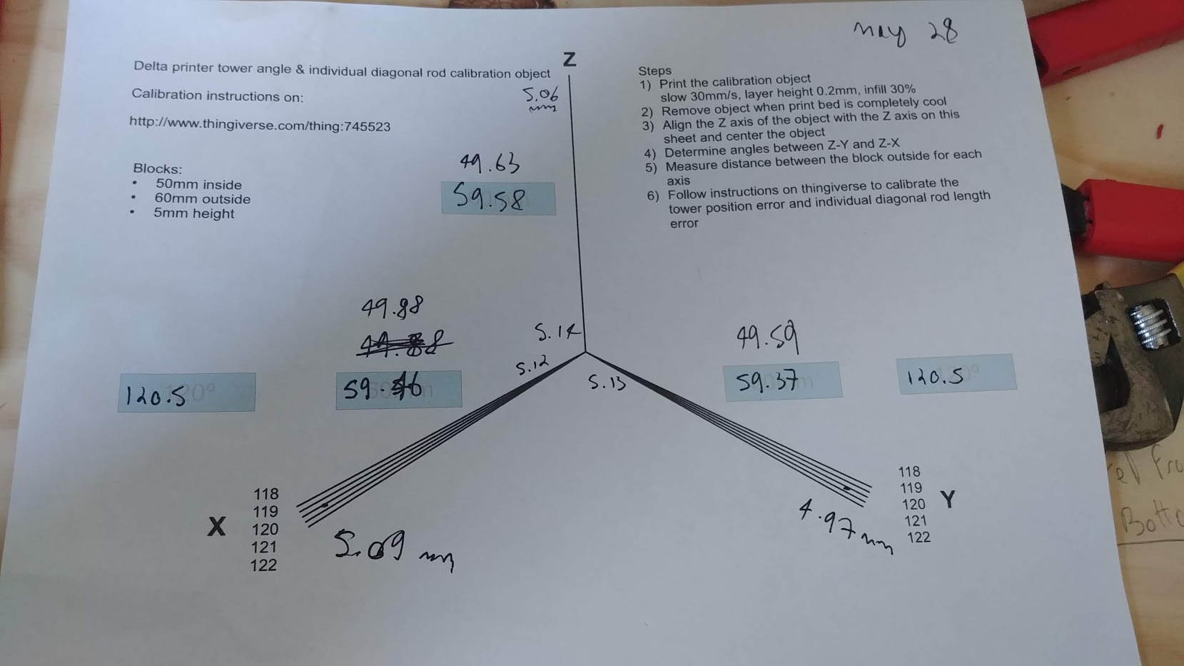

i spend some time tweaking the probe sensitiviy, i noticed that the effector was tilting over on a probe, so increasing the sensitivity to 15 seems to have helped it. the parts are more in size now. i ran the 7 factor and it decided the arms were all the same length but needed to be as follows:
M665 L293.761:293.761:293.761 R136.460 H323.451 B134.0 X0.096 Y0.131 Z0.000
M666 X0.978 Y0.004 Z-0.983 A0.00 B0.00sizing seems to be improved now
Spoke too soon sizing is still off.
How much is sizing off? If it's a small amount and uniform across the bed, use M579 to correct it.
