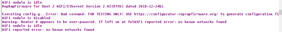

ANOTHER "No known networks found" error

The web interface:
And the error message:
Are all Duet boards this finicky?
Could be a configuration issue; share the relevant part of your config.g file to show how the thermistor for the heater is configured?

AHA! Some progress. I downloaded a bog-standard configuration file from the configurator for the Anet A8 - sure I know it won't be right, but it will be standard. And now the heater says "Standby" That's progress, right? I'm chuffed...
And we have LIFT-OFF! She gets hot!
