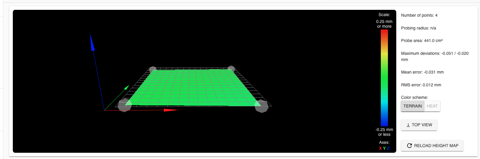

              can you post a picture of a mesh bed leveling?
              • duetalundefined
                duetal
                Sure
                • Vetiundefined
                  Veti
                  @bmveee said in Traveling Z offset:
                  G10
                  thats seems perfectly flat.
                  my suggestion is to try using G31 instead of G10 for the offset.
