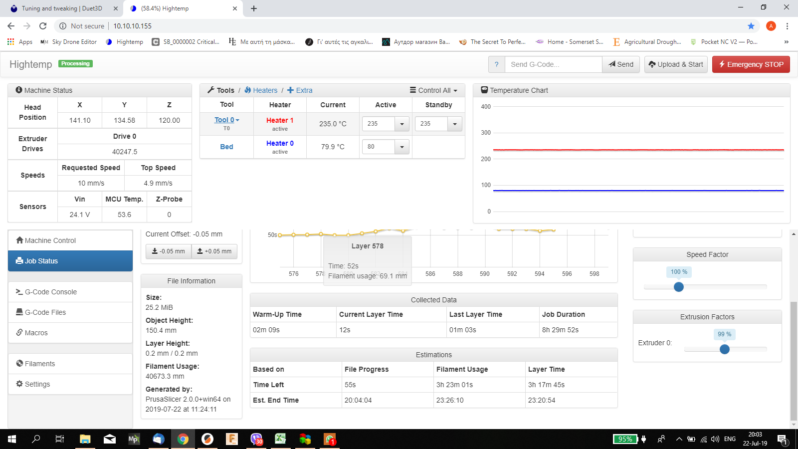

  • It seems that for some reason my DUET is estimating the wrong print time.
    On my CoreXY and being almost 1minute to finish the print, progress shown on both Webcontrol and Screen is about 58% done and not 99%.
    Plus print started with estimation really close to slic3rPE but finished it almost 2,5 hours later.
    Could someone tell me what am i doint wrong?

  • Thank you guys for all your valid replies, but at the moment my issue is not the Slic3R estimate compared with the actual print time, but the estimate of the duet and the fact that while the progress bar shows 58% the file had actualy less than a minute to finish, on the last second of the print, it showed progress as 59.2% (if i recall correct). This is my first "problem"
    As about the slic3R i had taken all machine "info" out for now and will try to tune it in a way to have a proper estimate.
    On all my other printers, original prusa or not, print time from slic3r has been tuned to a close 3 minutes almost, but simply this seemed strange to me.
    I most likely stated my info wrong, but if you check the picture in detail you will see the "issue"
  • @tonygr The web interface displays 3 time estimates. One based on filament usage, another based on file usage and yet another based on layer time. Are all 3 estimates "wrong" or just one of them?
    The best way to get an accurate estimate of how long a print will take is to run it in simulation mode first (right click on the file).
