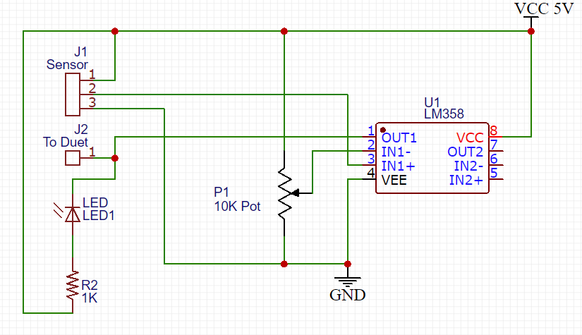

It would be nice to specify the analog value in the config.g.
At the same time, you can do this today, with a tiny scrap of circuitry and something like:
M558 T0 E S1
T0 = Emergency stop when trigger hits
E = I'm assuming you are not using an E endstop, yet, in your hardware, and can plug the output of your distance monitor in the E0 endstop connector on the board.
S1 = Trigger when input rises.
The circuitry could be as simple as a variable resistor (potentiometer) that you turn to set the distance threshold. This MIGHT be too dependent on other things, such as the exact logic trigger of the E0 endstop input, current flow, etc.
Therefore, it might be better to use a small comparator like this (assuming your sensor is a variable voltage source, 0 to 5V, on pin 2 of the three pin header shown):
The pot lets you set the "trigger distance". The LED lets you set it without looking at the Duet web interface.
Notes:
Take the exact circuit with a grain of salt, I drew it out of my head in a few moments. It is really to get the idea across as much as to be an exact implementation.
Having said that, if you choose to try this circuit first, yes, this shows 5V VCC. The output should be safe for 3.3V Duet, because the LM358 is not a "rail to rail" comparator, and the voltage drop should be just about right... but... CHECK THIS before plugging into a duet!!!

@Danal: that's good out-of-the-box thinking there, I guess my background as a software engineer shows: I prefer to do as much as possible in software.
I see how your circuit solves the issue, yet I worry that it's an extra component for me to manufacture and calibrate for every device I want to ship. Hence my eagerness to do this in easy-to-reproduce software instead.
